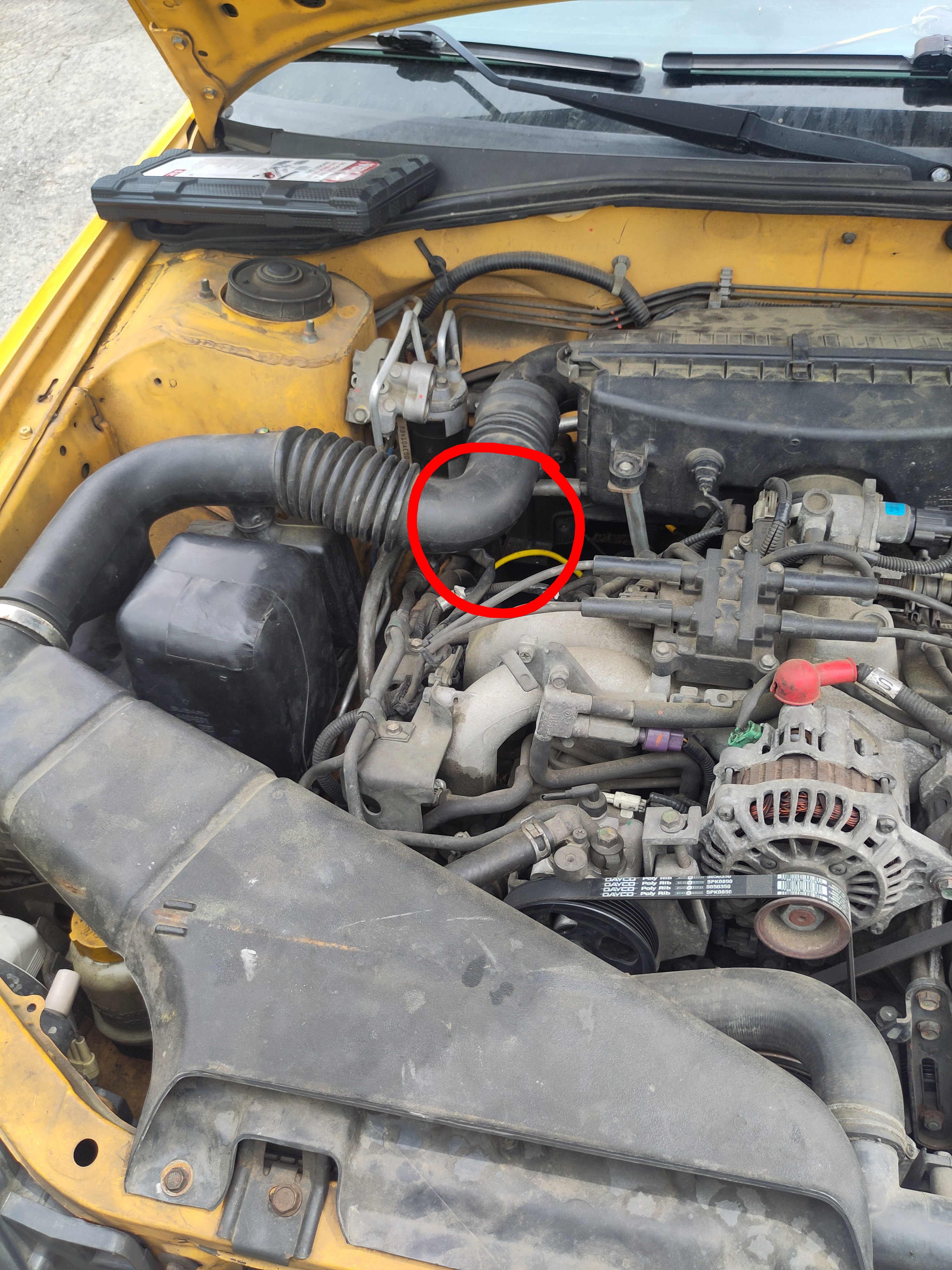

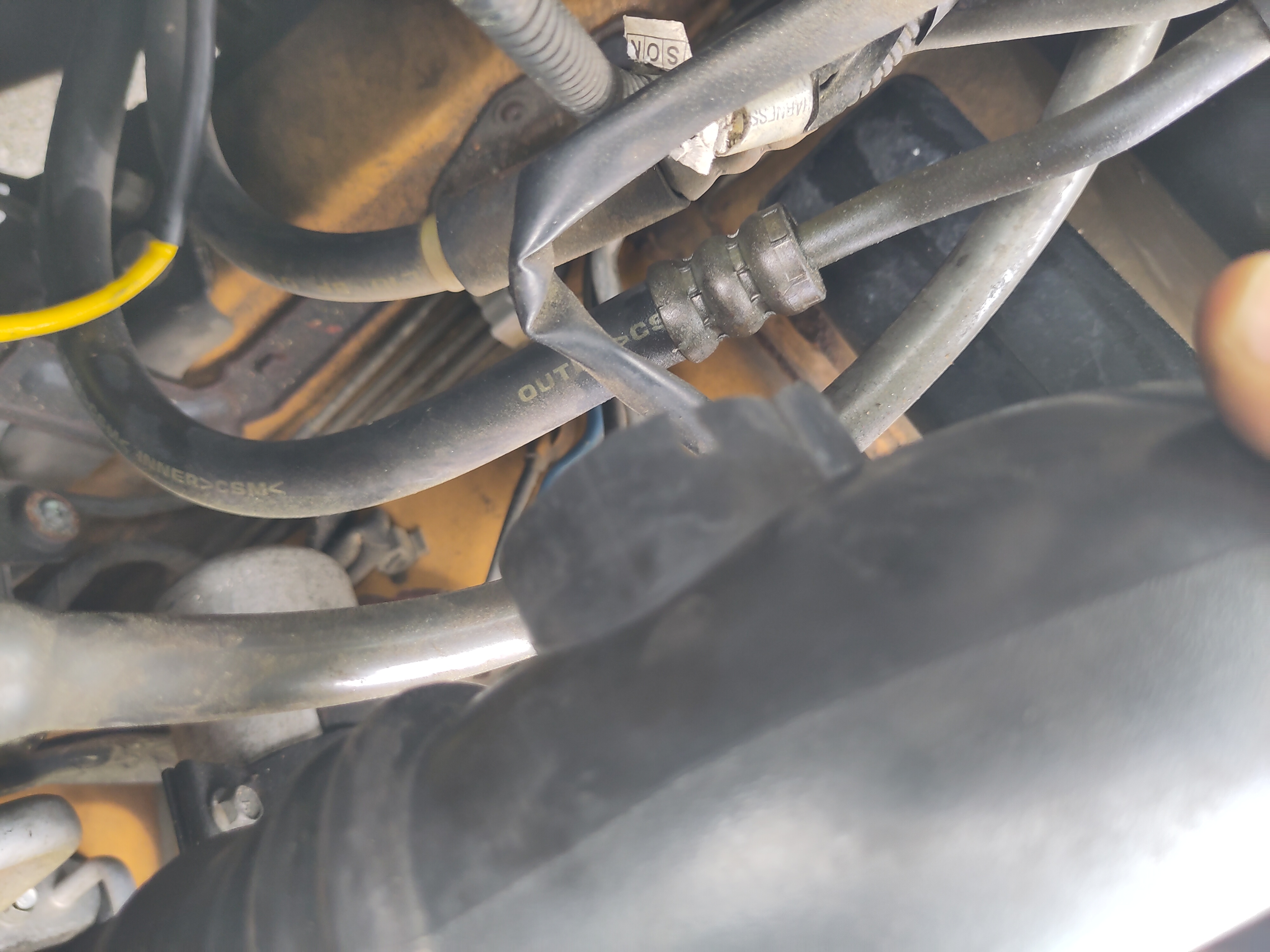

Hey y'all, looking for some experience/slightly niche knowledge. Recently I discovered that several pieces of the air ducting (idk the proper name) of my '03 Baja are missing. They were missing when I bought it and idk how I didn't notice until now but I've been able to replace most of it from a local junkyard. However, there is one piece that is stumping me. Underneath the elbow piece of ducting right below the air box is a hole much like those for the first two resonance boxes and I can't find a diagram that shows what goes here. Attaching a few photos here.
Anybody have the answer?
Please forgive the dust, I haven't started spring cleaning yet haha!

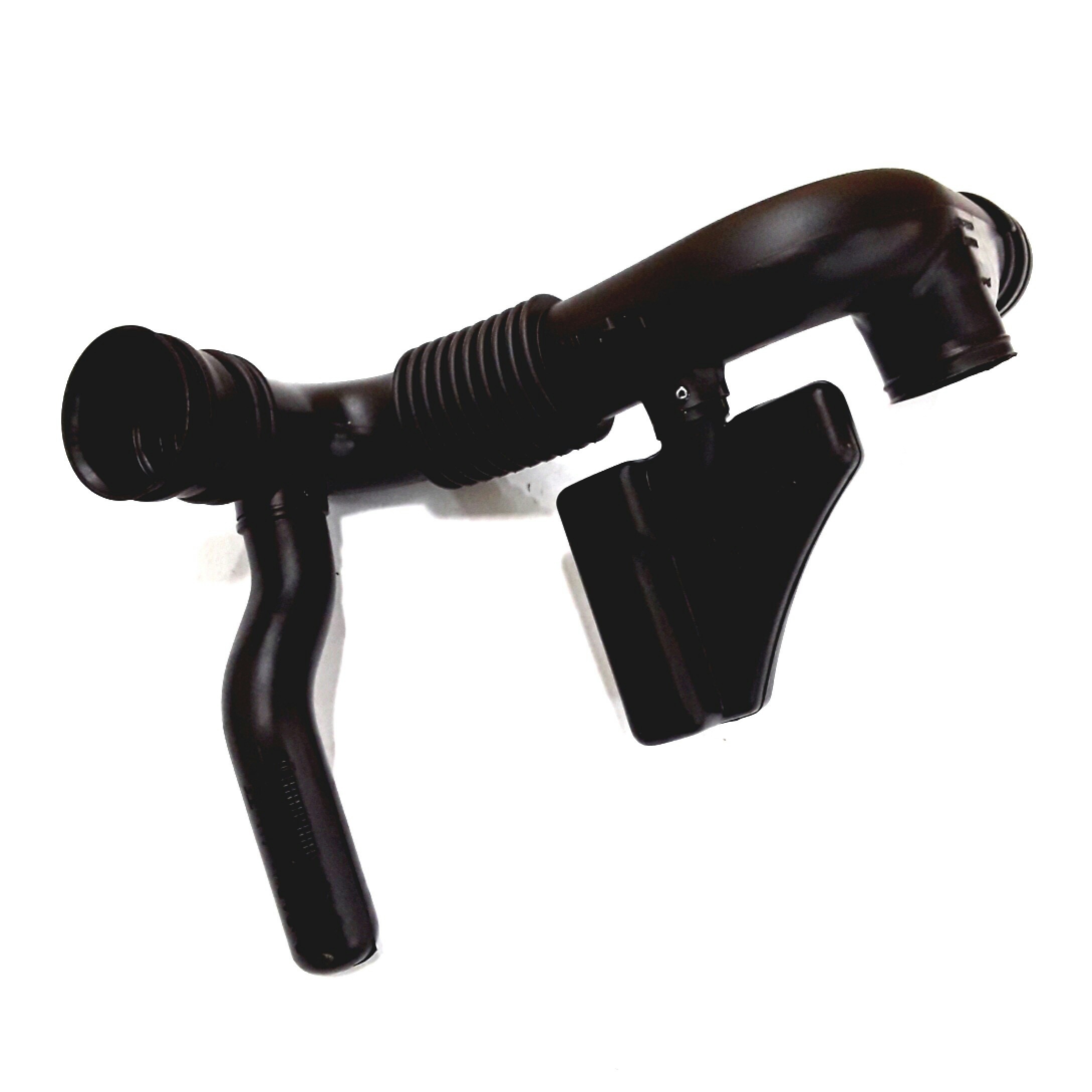

Looks like you mean this:
https://parts.subaru.com/p/Subaru_2003_ ... AE00C.html
Part you're missing is the long bendy tube on the left side of the photo.

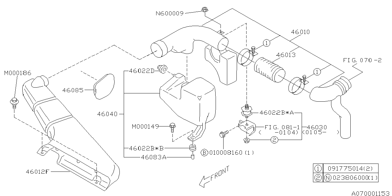

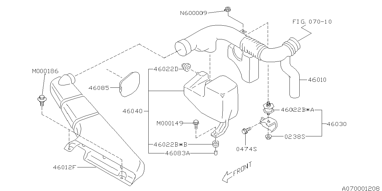

Diagram:
https://parts.subaru.com/a/Subaru_2003_ ... html#46010
Looks like they had two variations, but AFAIK they should be interchangeable.
2000-2004 Outback uses the same parts.
Diagram:

Amazing! That's definitely it! This is the second time on this forum you've saved me with an obscure diagram. Where do you find them? Clearly I've got a lot to learn about researching this stuff
