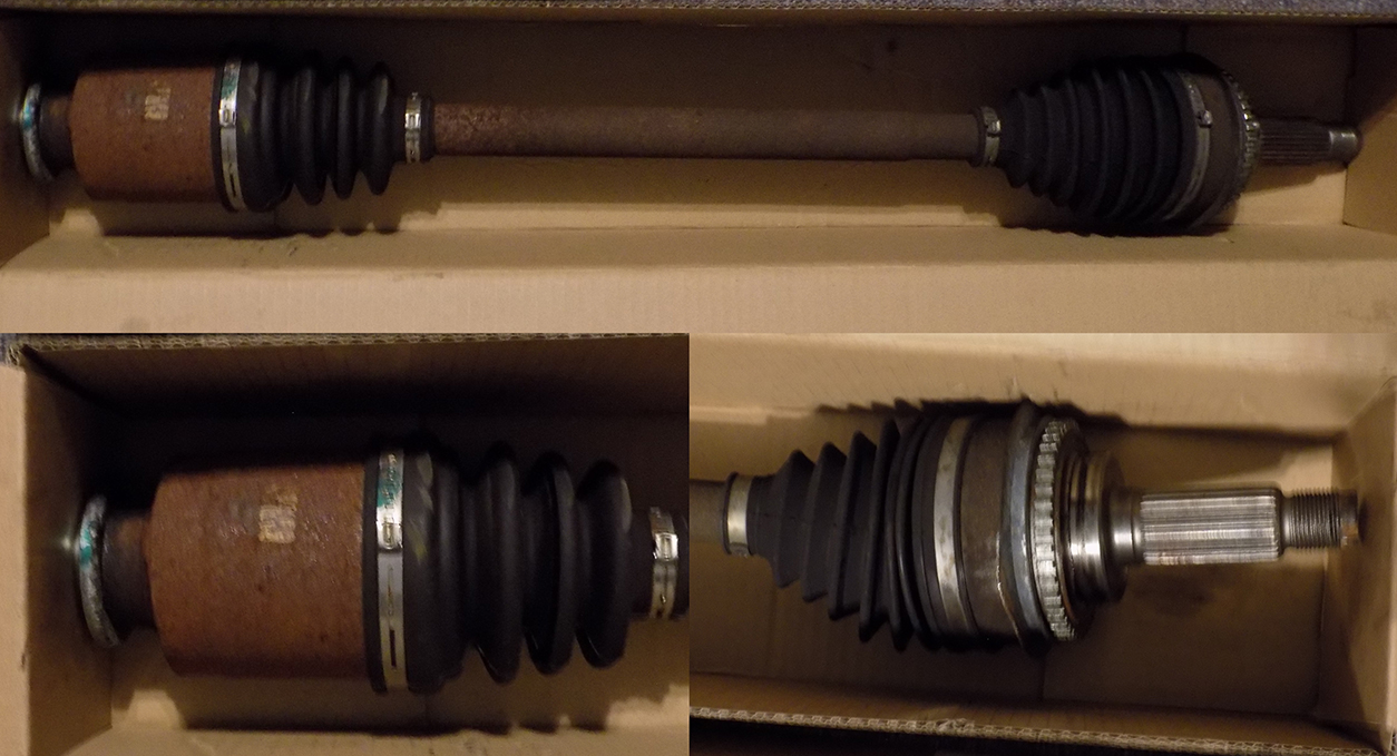

Well, mechanic got the axles installed today. With the 20mi drive home I can say the popping sound is indeed gone (again). After getting home and taking a look at the older axles, it turns out the outer cv axle had failed with the boot intact. Here's some pics of the old OEM axle that failed with just under 50k miles (excuse the horrible lighting).
As you can see there's a massive dent in the flange where the axle rod mates to the hub. This is also the joint that failed. The axle probably failed thanks to MD's amazing roads, courtesy of SHA.

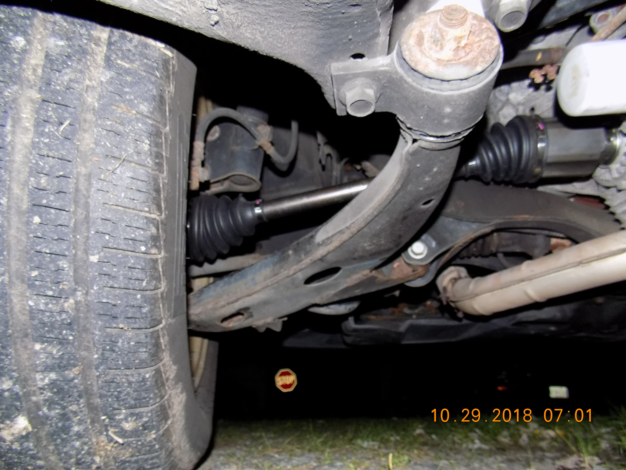

Now here is the brand new beefy 1A axle in place (please excuse the lighting again, took this after dark and everything looks siltier than usual thanks to the flash)
The outer joint is also slightly tilted because my wheels are turned slightly to the left.

Na, the joint was toast. The bad joint has absolutely no tension left in it compared to the others- it just flops around. If I shake the axle quite violently the bad joint makes the distinct "popping" noise. Axle is probably still fine, but really not worth the trouble of fixing it considering how cheap the 1A ones are. Plus my mechanic only charged me $250 in labor for both axles. So I literally got 2 axles + labor for the price of 1 OEM axle.
