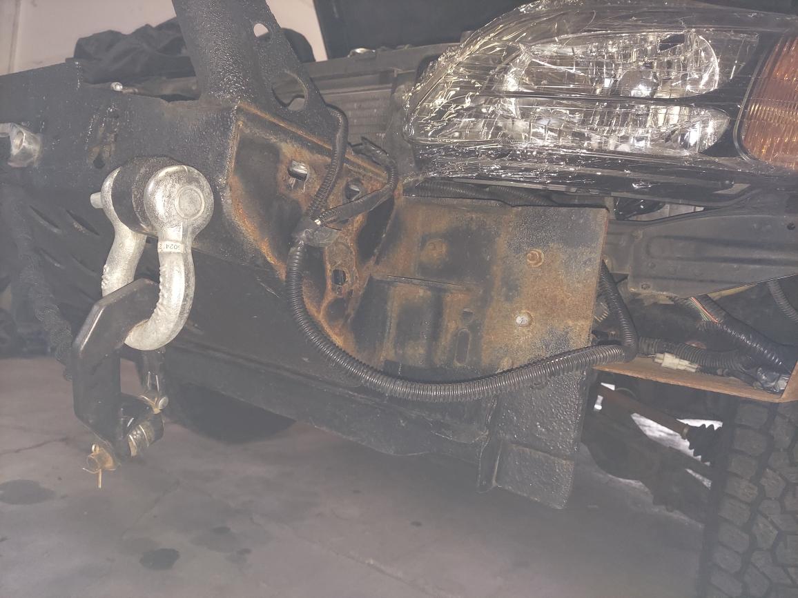

Alright. I have got some pictures about how the bumper hooks up. So I can show you these pictures and that pays for help with a recent problem, right? Thats how this exchange works isn't it? :lol:
So, first of all excuse the little bit of surface rust. While he we were swapping out his headlights we cleaned that up and raptored it. There were some modifications that needed to be made to the bumper. First of all the bottom front rim of the headlights sit right on top of the bumper wings. But the bottom ridge that is under the lens of the headlights interferes. There is a bit of metal that needs to be cut out that basically surrounds that ridge.
Also the bumper did not come with the "glasses" (as my son calls them) that go in front of the headlights to protect them. That bit was custom made.

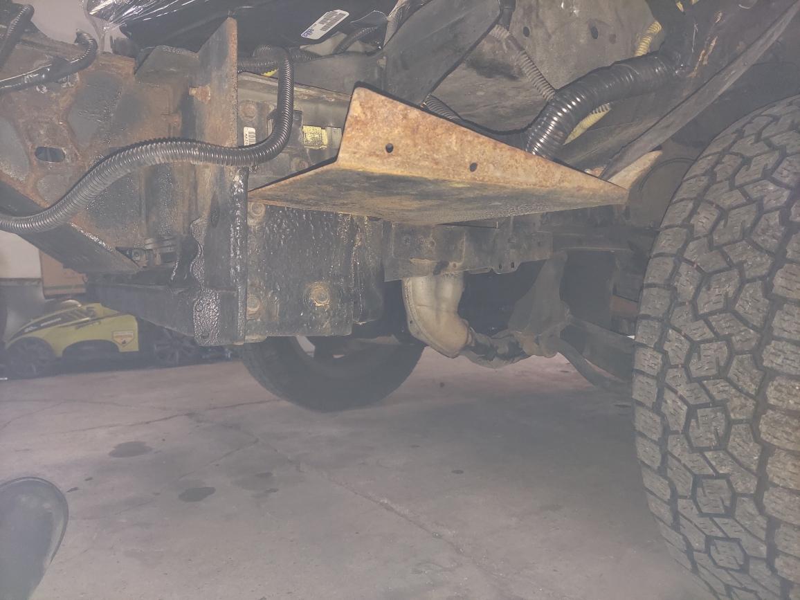

The plastic wheel well guards go too far forward and down and had to be cut. You can see the sheet metal plates that we had fabricated that go in front of them. Yeah, we know. More rust. They have been sanded and coated as well. That was all part of this weekend's project. We had those made so that mud, dirt and snow didn't fly up under the headlights and to help protect the wiring. Those two holes have holes aligned on the bumper wings where we have put bolts through to secure it.
You can see the fastener plate that was placed on the back of the bumper with the side facing bolts that help connect it to the Baja subframe. There are also some front facing bolts that also do that. We explained to our fabricator that we needed to be able to remove the bumper to service it but wanted to make sure it was secure. This is what he came up with and it definitely does the job.
