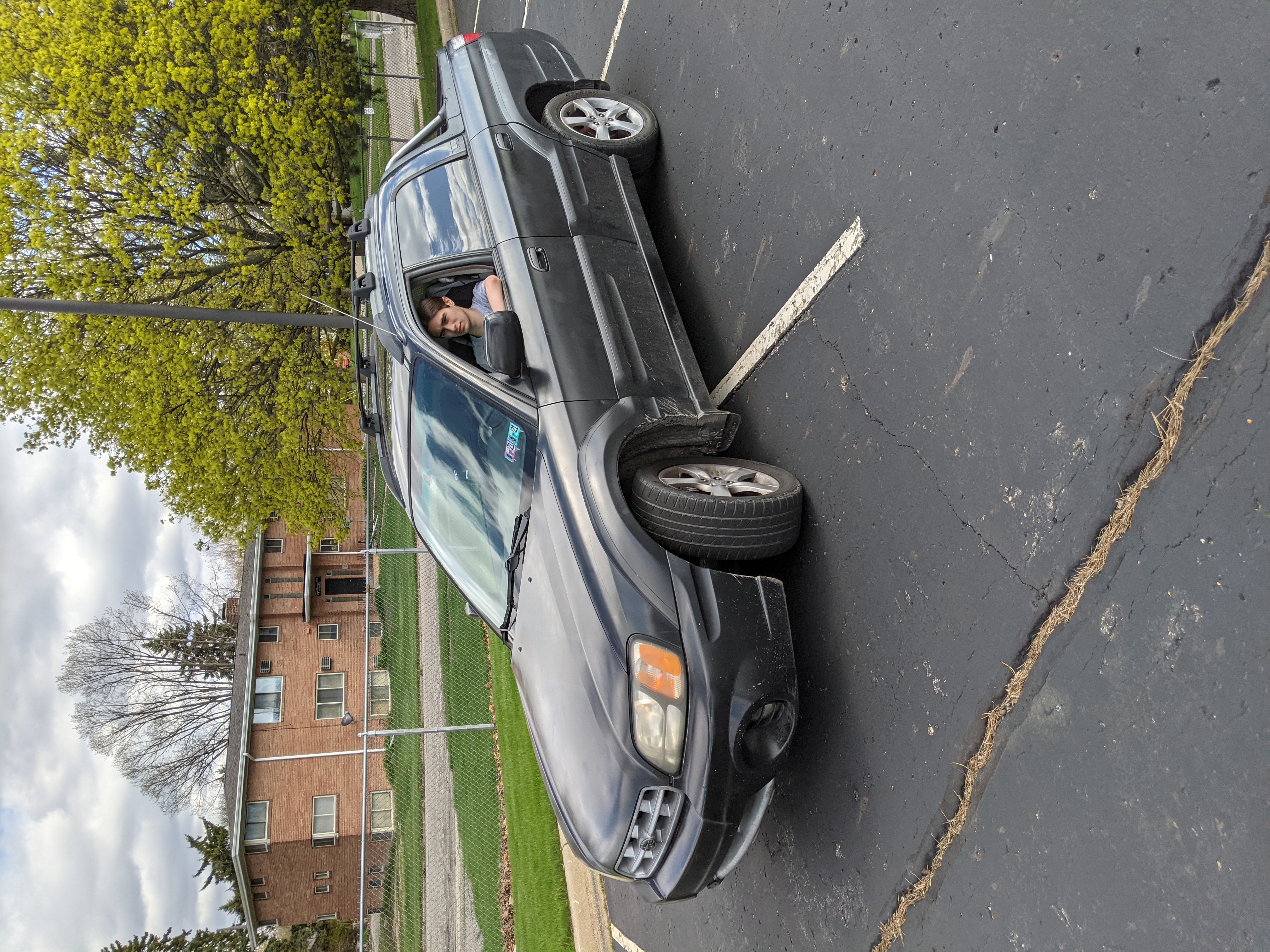

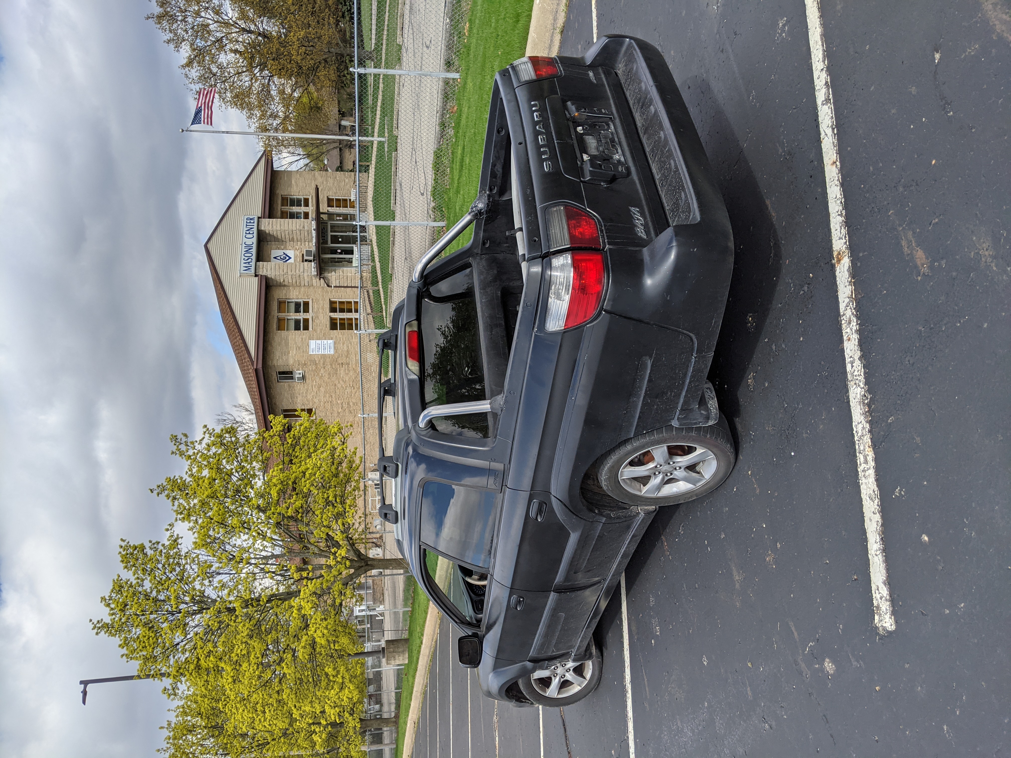

I'll include some before pictures here. Some important items to note:
We bought the car from a Subaru mechanic that lives in Pennsylvania. He used the car on a tree farm as a work vehicle but despite that it was mechanically sound and the body was mostly in good shape. ...mostly. At some point he collected a long scrape down the passenger side of the vehicle. Apparently in Pennsylvania they have a law that no rust can be showing on the vehicle at all or the owner is subject to steep fines. This law is apparently fervently enforced in his area. The scratch took off all the paint along the length of the car but didn't otherwise injure the vehicle. His solution? Rattle can the entire car. Yeah. Everything.
The car used to be two tone black on grey. To be honest it didn't look that bad from the curb. But up close it was a bit of an eyesore. There were other problems like the liquid nails around the sport bars, completely wrecked front bumper, mismatched brake bits, broken brake rotor, squishy suspension, tires that were way too small, etc. But we had plans that made all of that irrelevant. Including the paint.

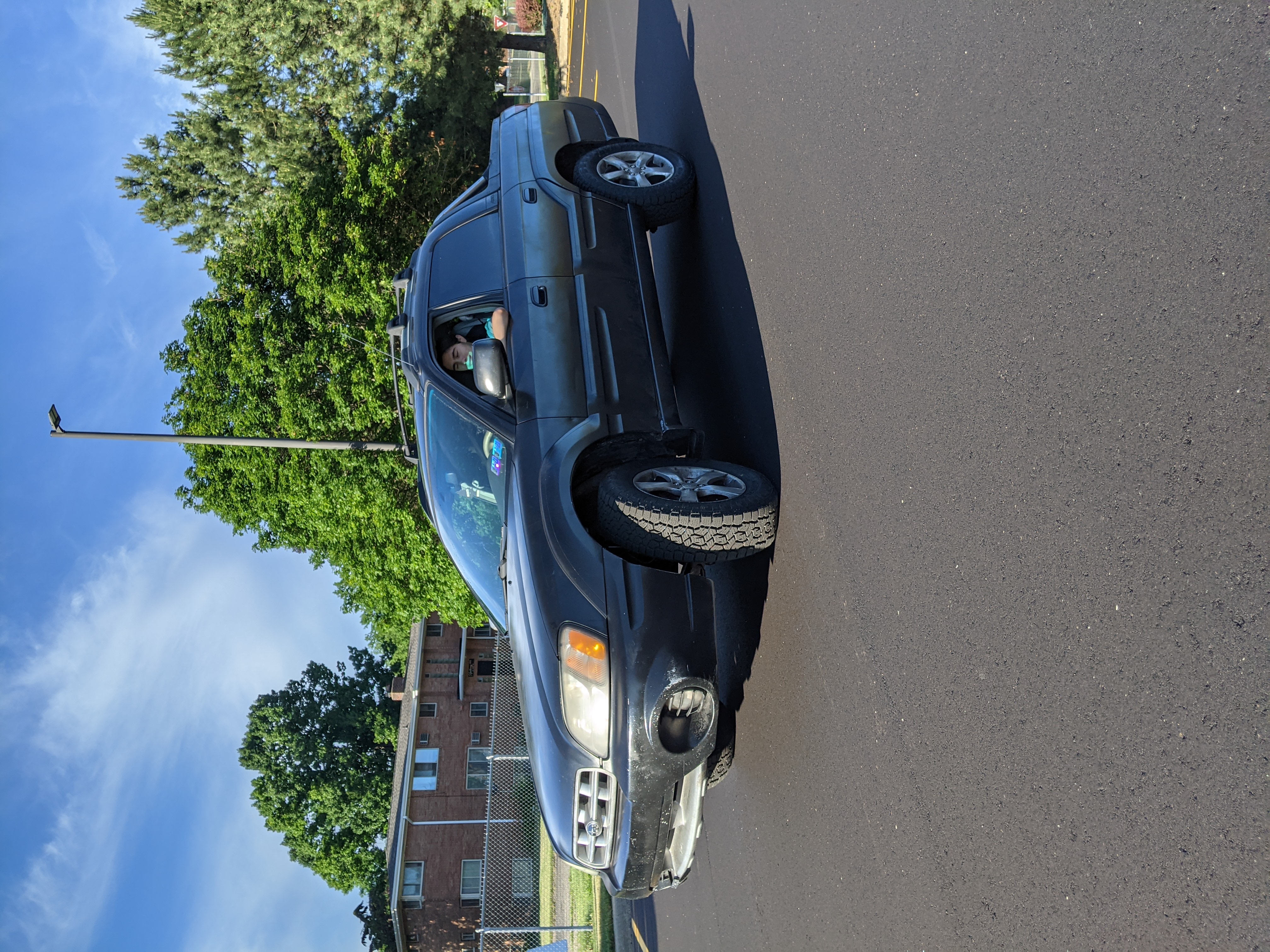

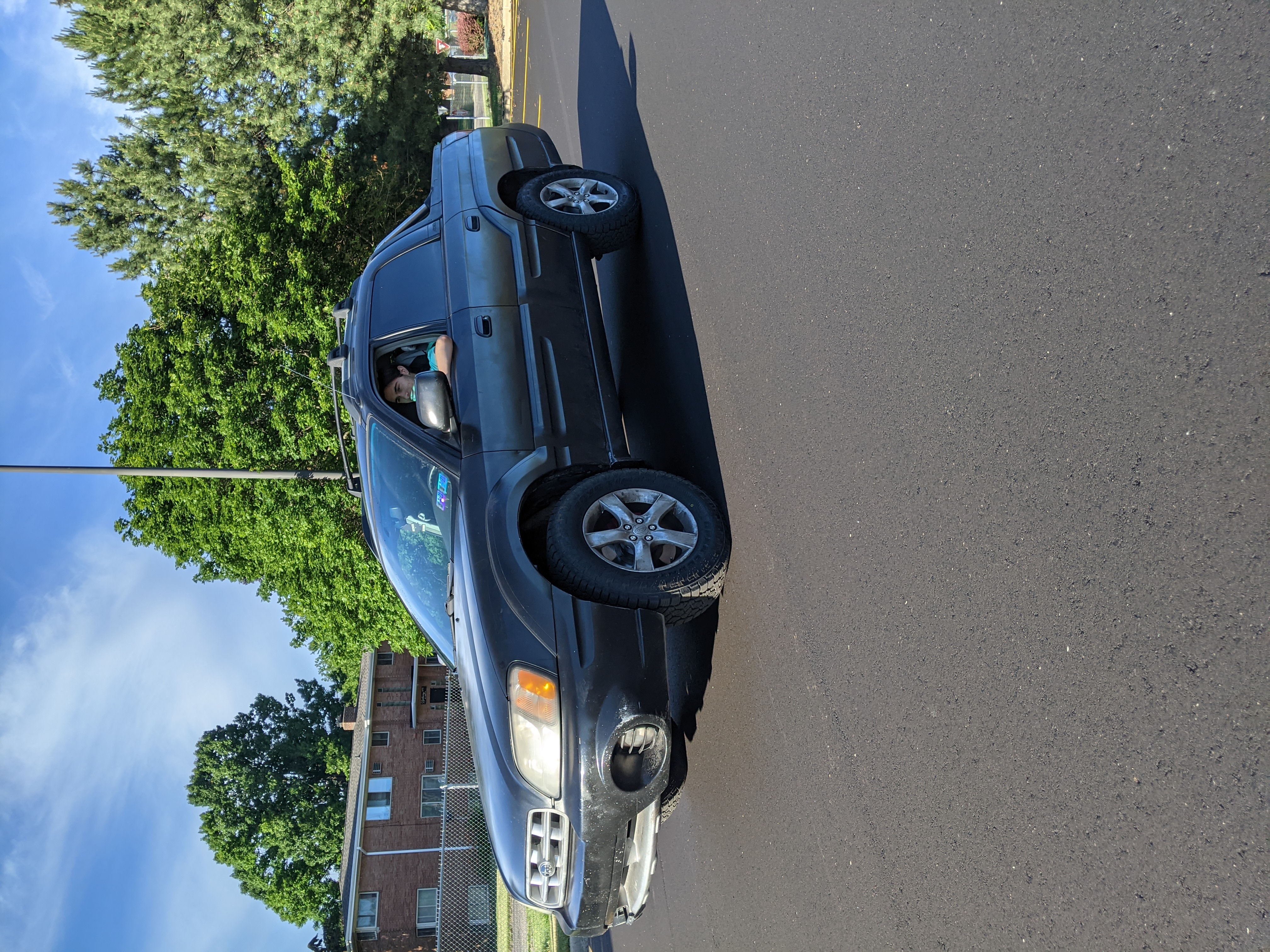

- Before3.jpg (3.63 MiB) Viewed 34306 times
- Before2.jpg (3.63 MiB) Viewed 34306 times
- Before1.jpg (3.94 MiB) Viewed 34306 times

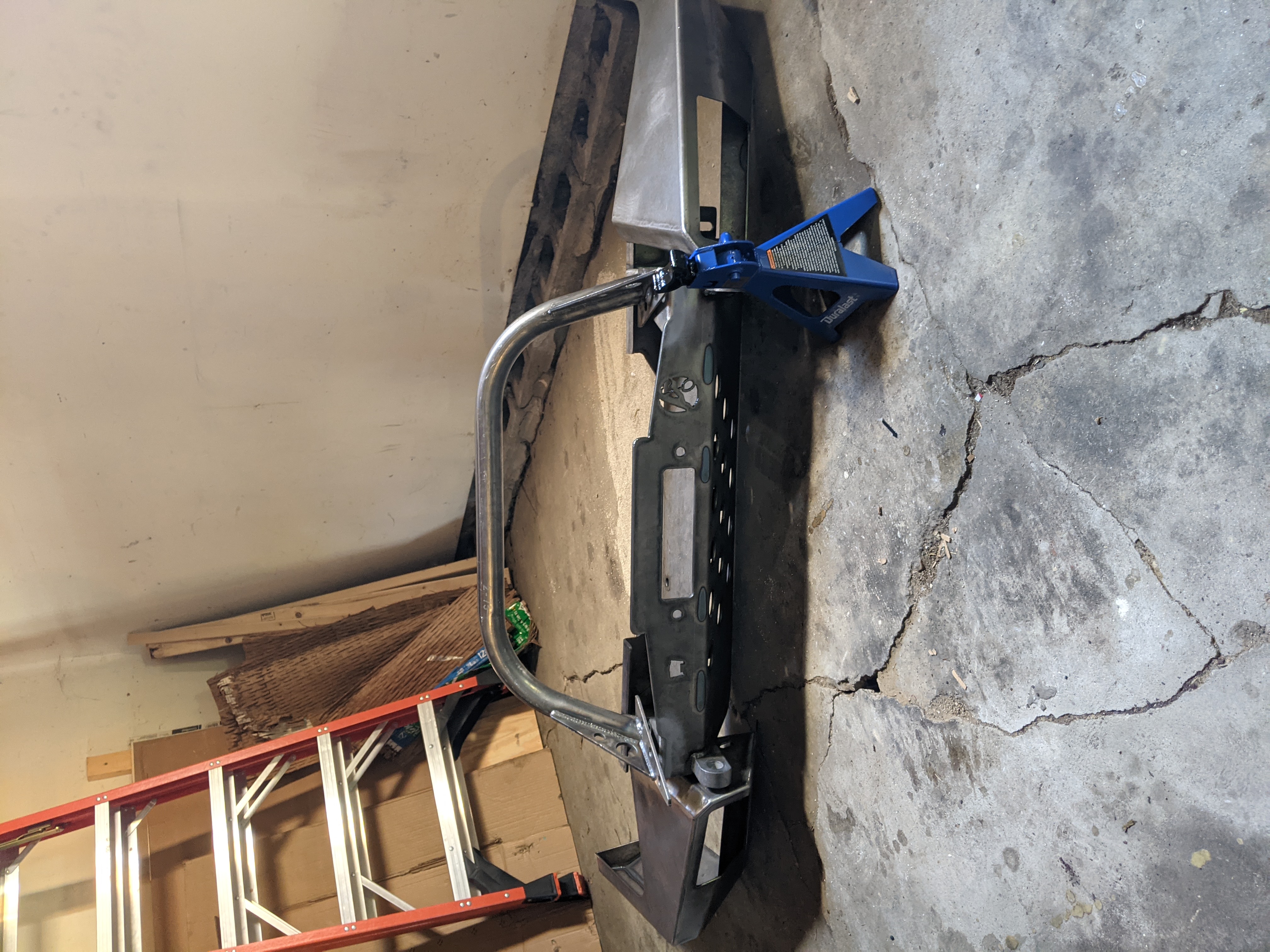

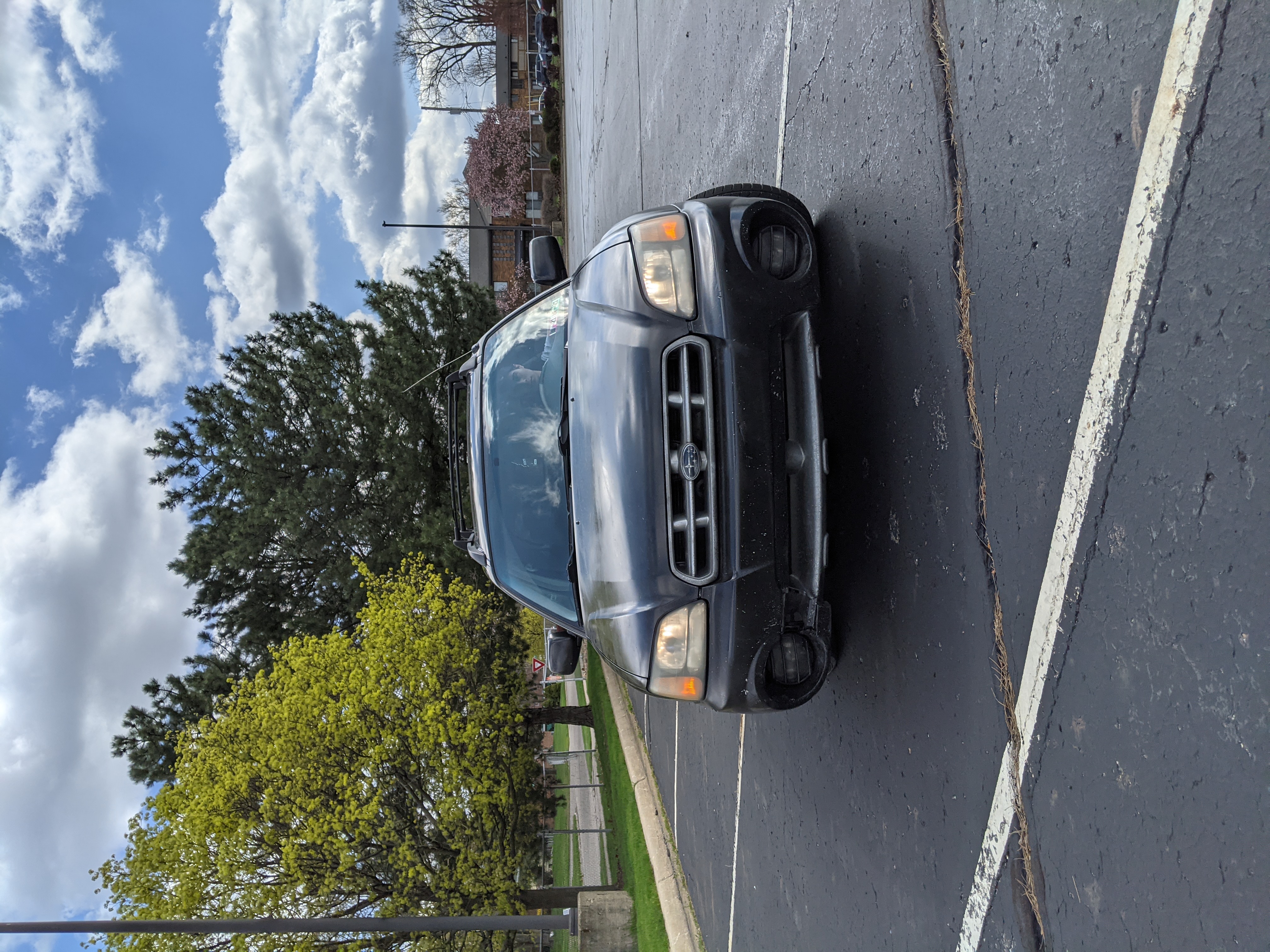

Here is the final "before" picture as well as one showing some plans we had for the front bumper.
- Front Bumper.jpg (3.35 MiB) Viewed 34306 times
- Before4.jpg (3.82 MiB) Viewed 34306 times

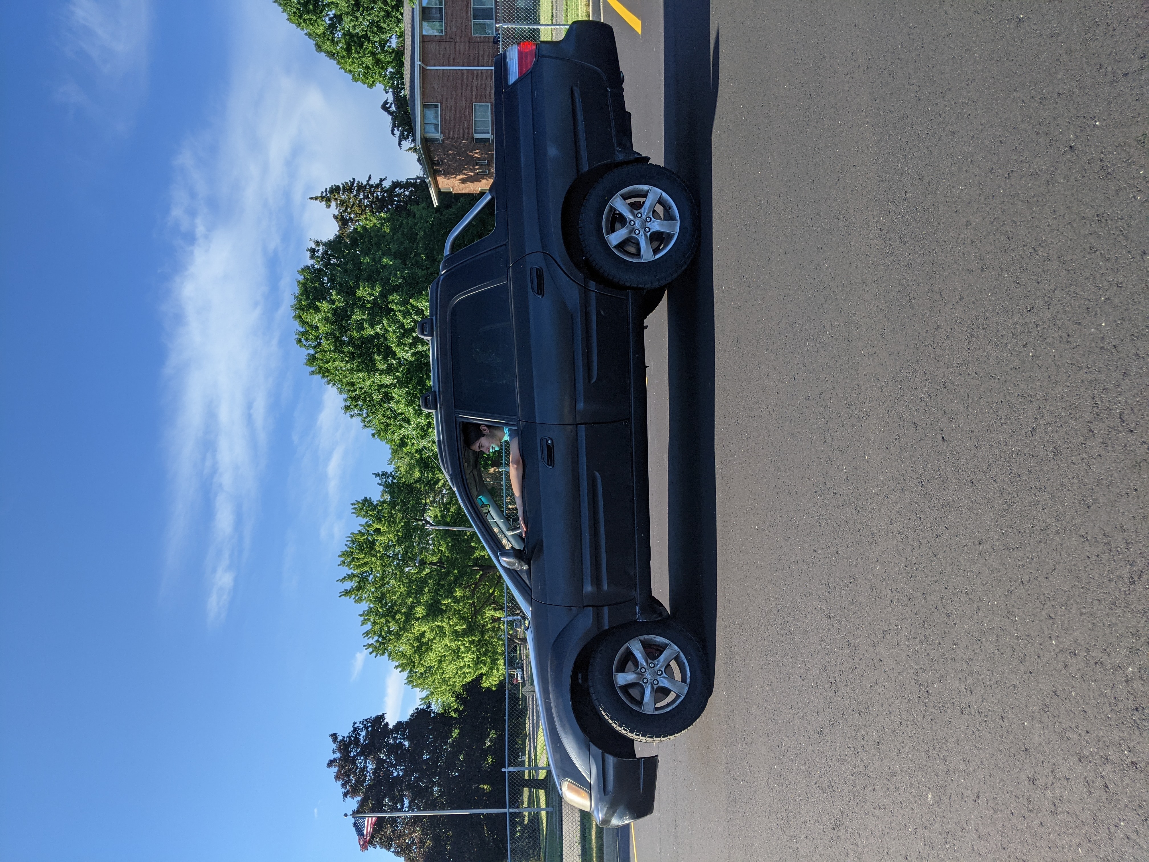

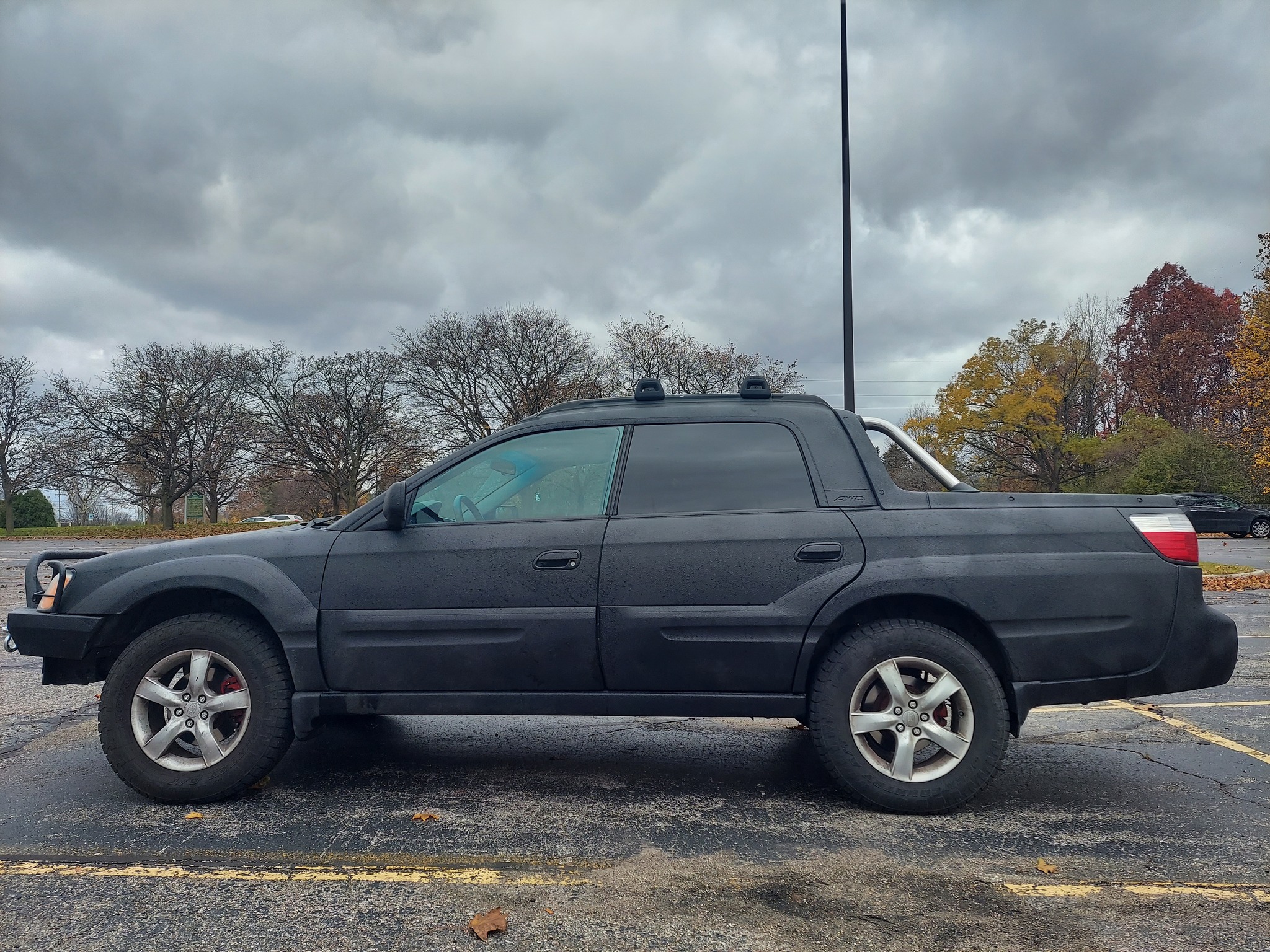

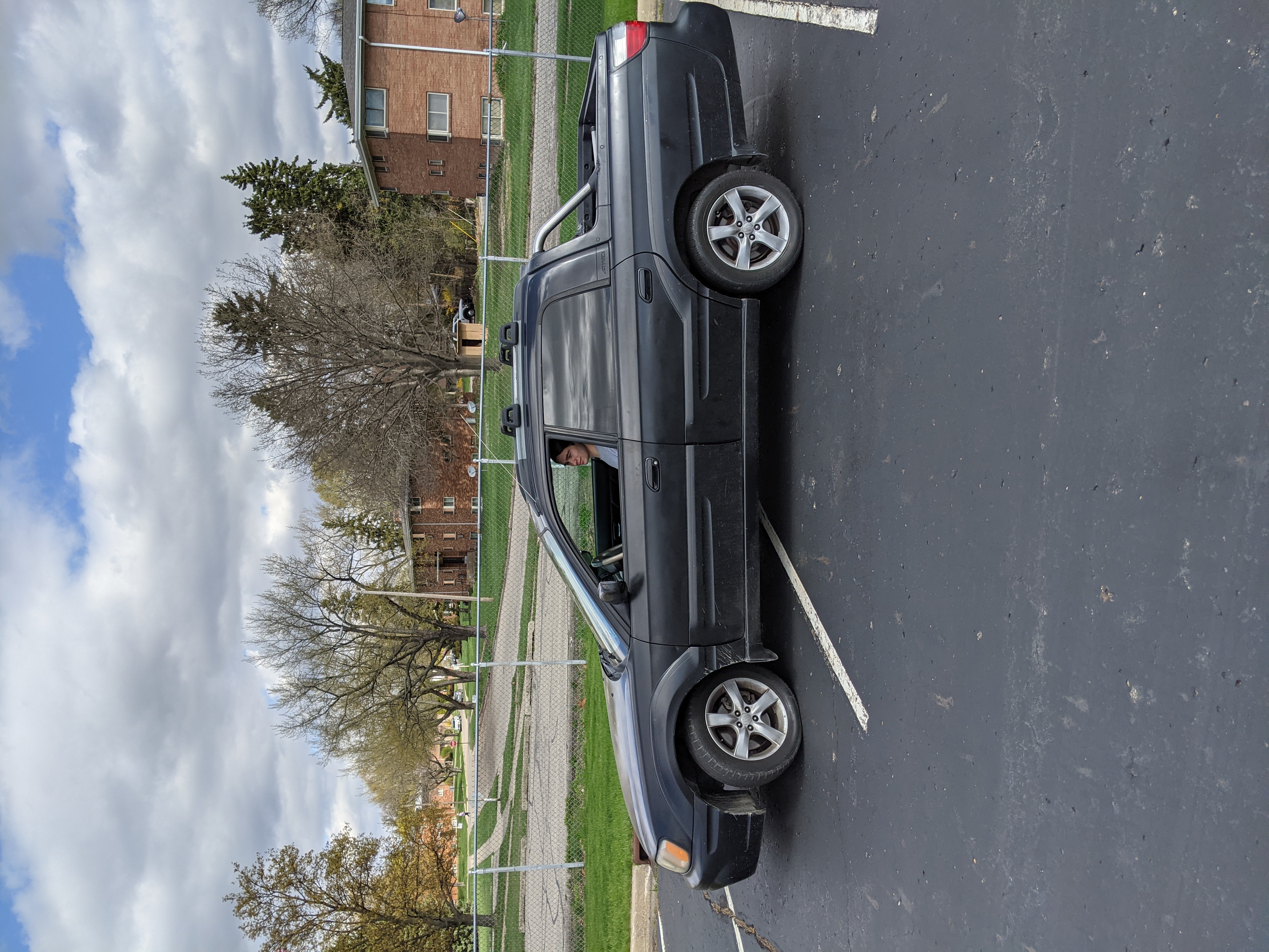

Here are some pictures showing the Subrute after the 2" lift and tire upgrade.
- Lift and tires3.jpg (4.16 MiB) Viewed 34306 times
- Lift and tires2.jpg (4.49 MiB) Viewed 34306 times
- Lift and tires1.jpg (3.66 MiB) Viewed 34306 times
Re: Behold! The mighty Subrute!
...more of the same.
- Lift and tires5.jpg (3.8 MiB) Viewed 34306 times
- Lift and tires4.jpg (3.97 MiB) Viewed 34306 times

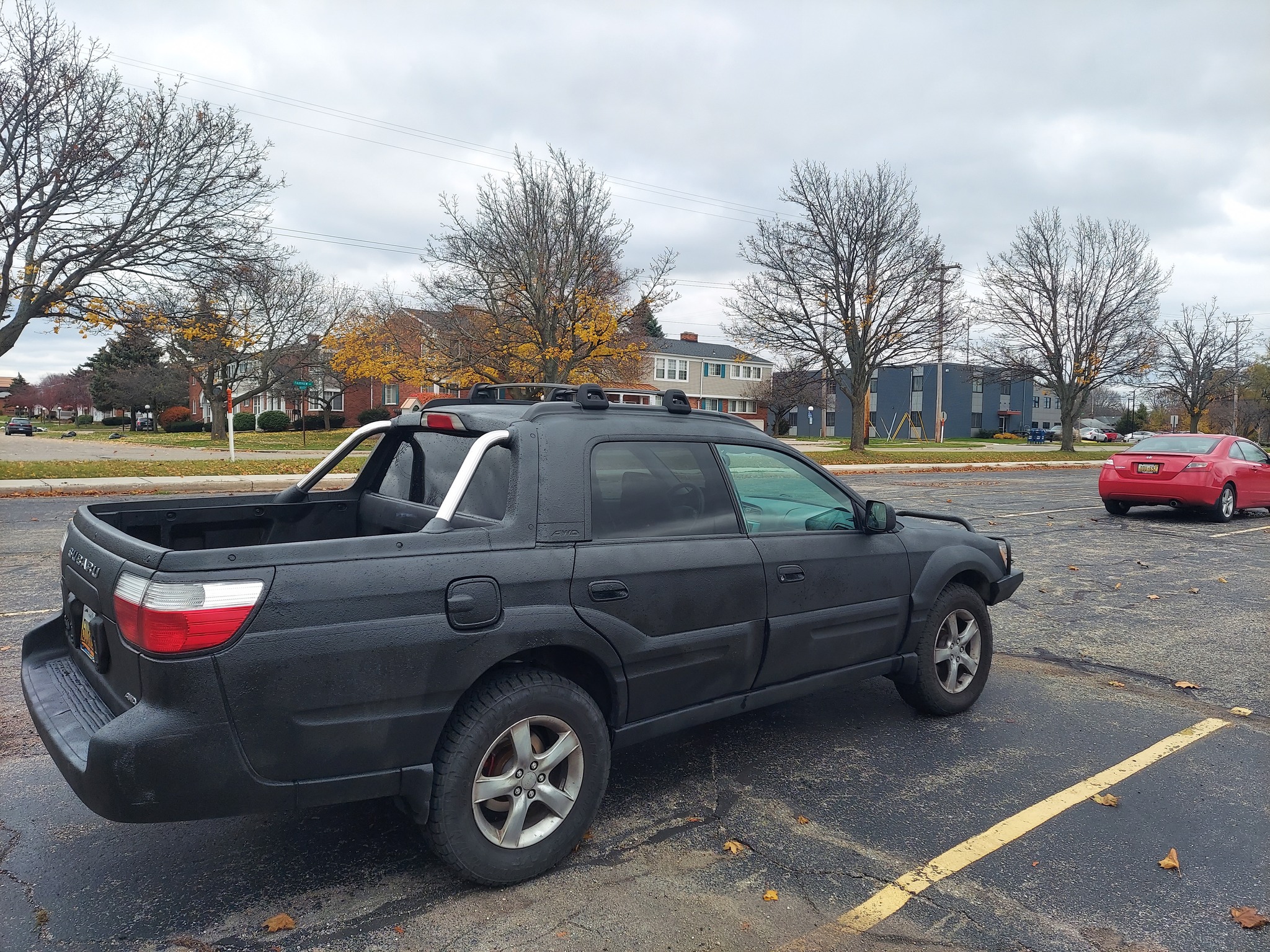

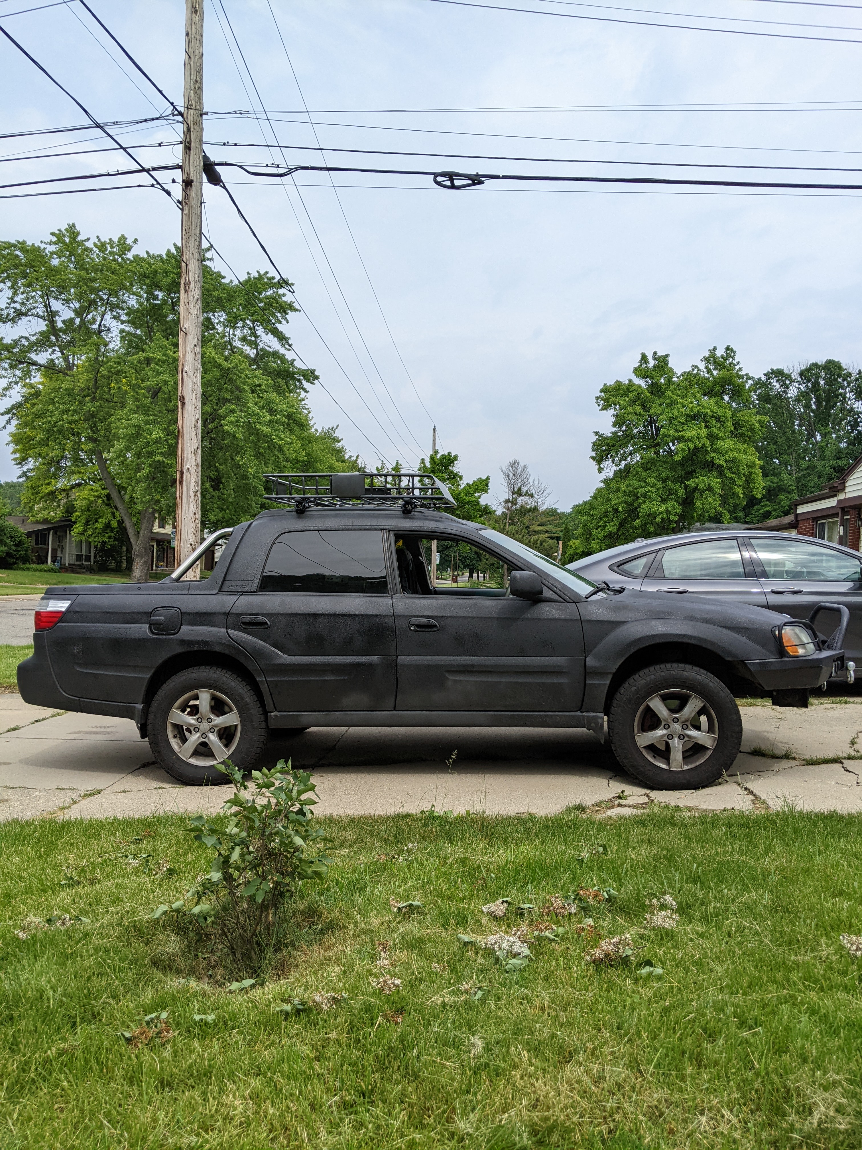

We added a new roof rack! Man, it really fits the look we were going for.
- Roof Rack.jpg (3.87 MiB) Viewed 34306 times
- Roof Rack Side.jpg (4.38 MiB) Viewed 34306 times

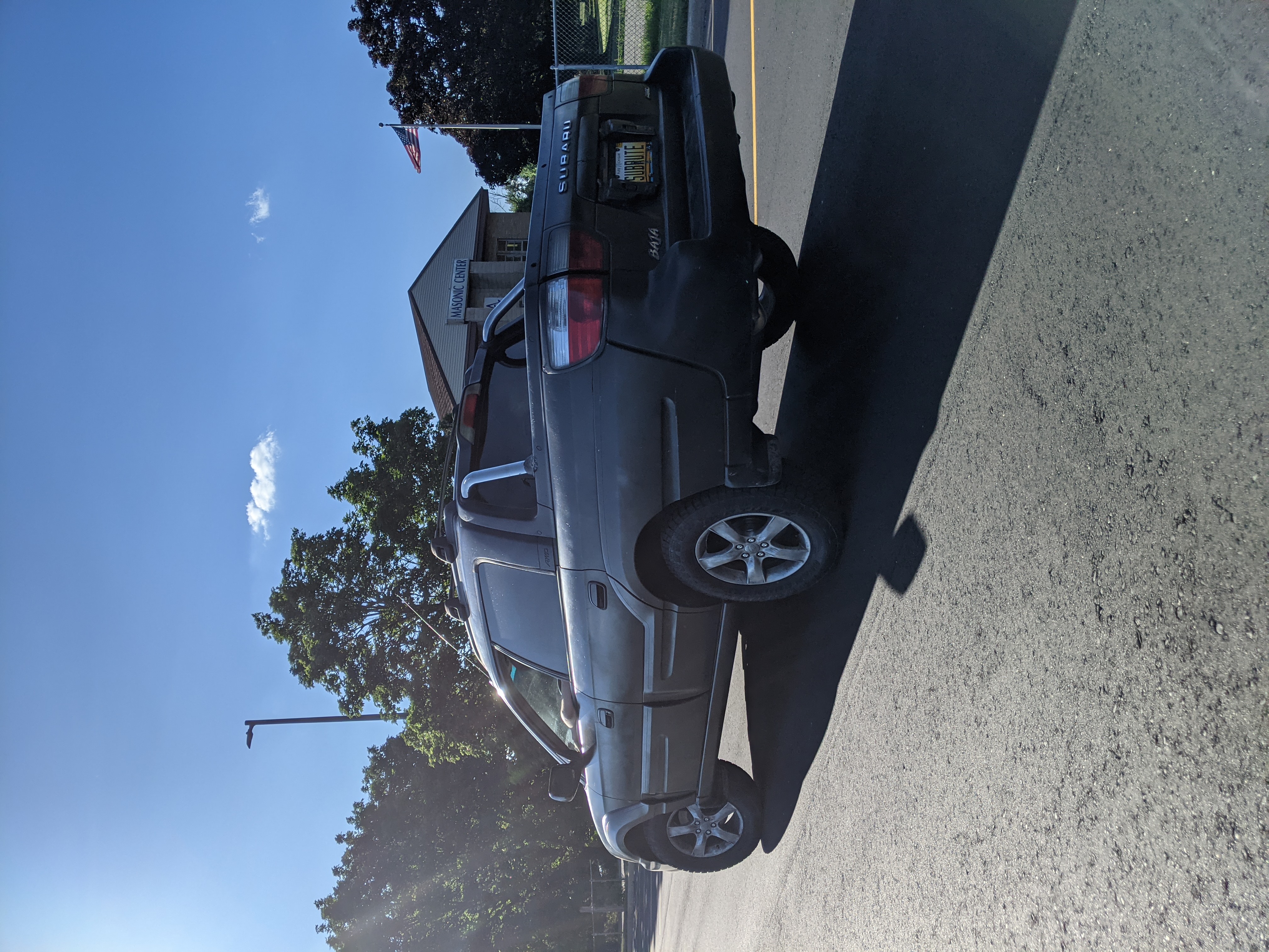

And we wanted to start doing some overlanding. Truck tents seem fun but there are of course none that fit the dimensions of the Subrute. Time to do some more mods! We designed this rigging that would make it fit the Subrute and can be easily removed from the sport bars with these nice tube clamps.
- Truck tent rigging.jpg (4.17 MiB) Viewed 34306 times
- Truck tent mounted.jpg (5.42 MiB) Viewed 34306 times

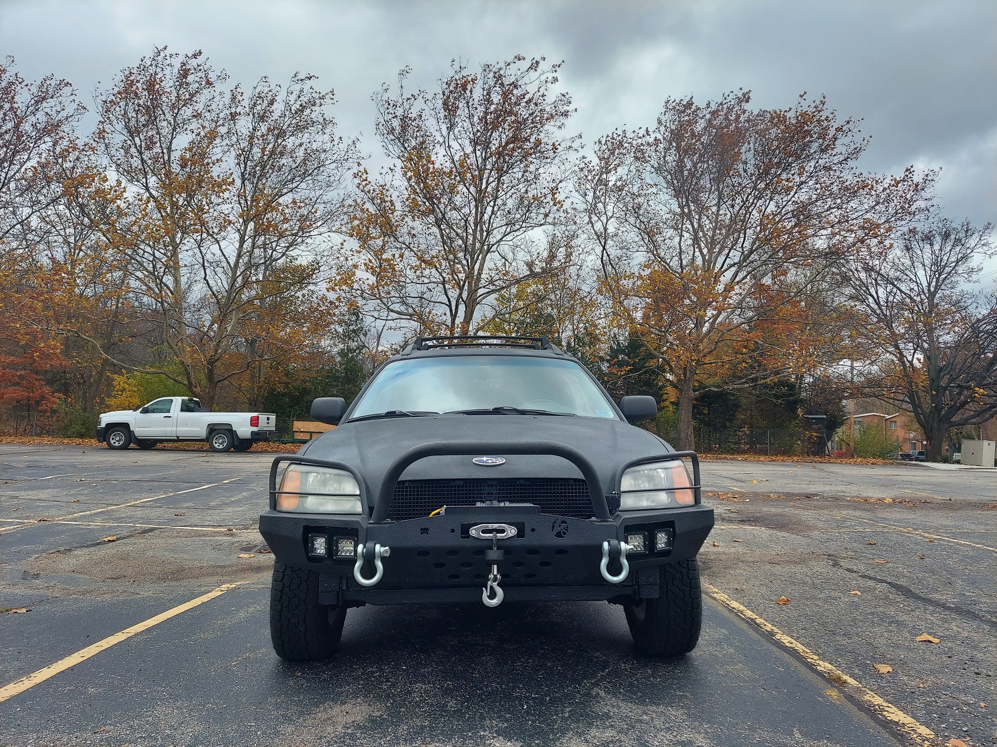

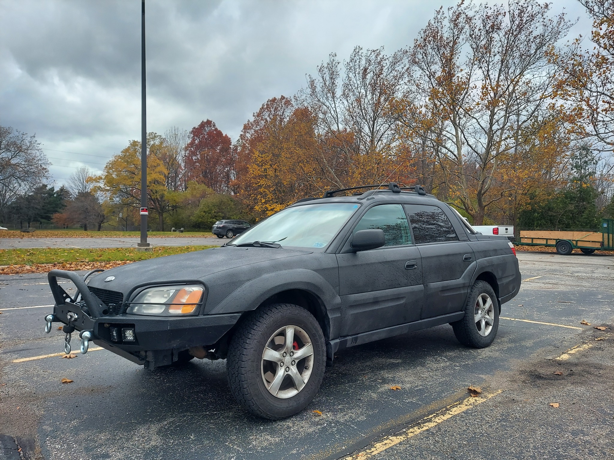

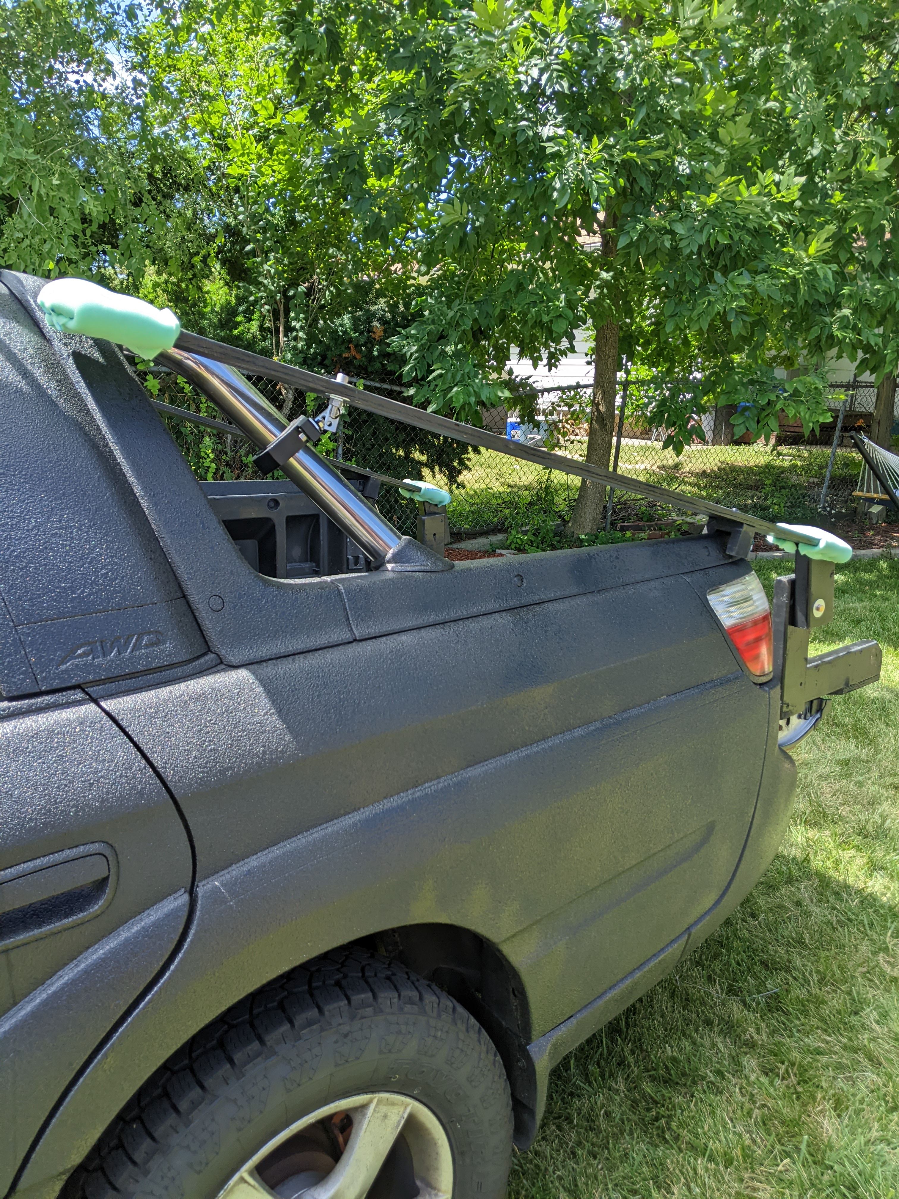

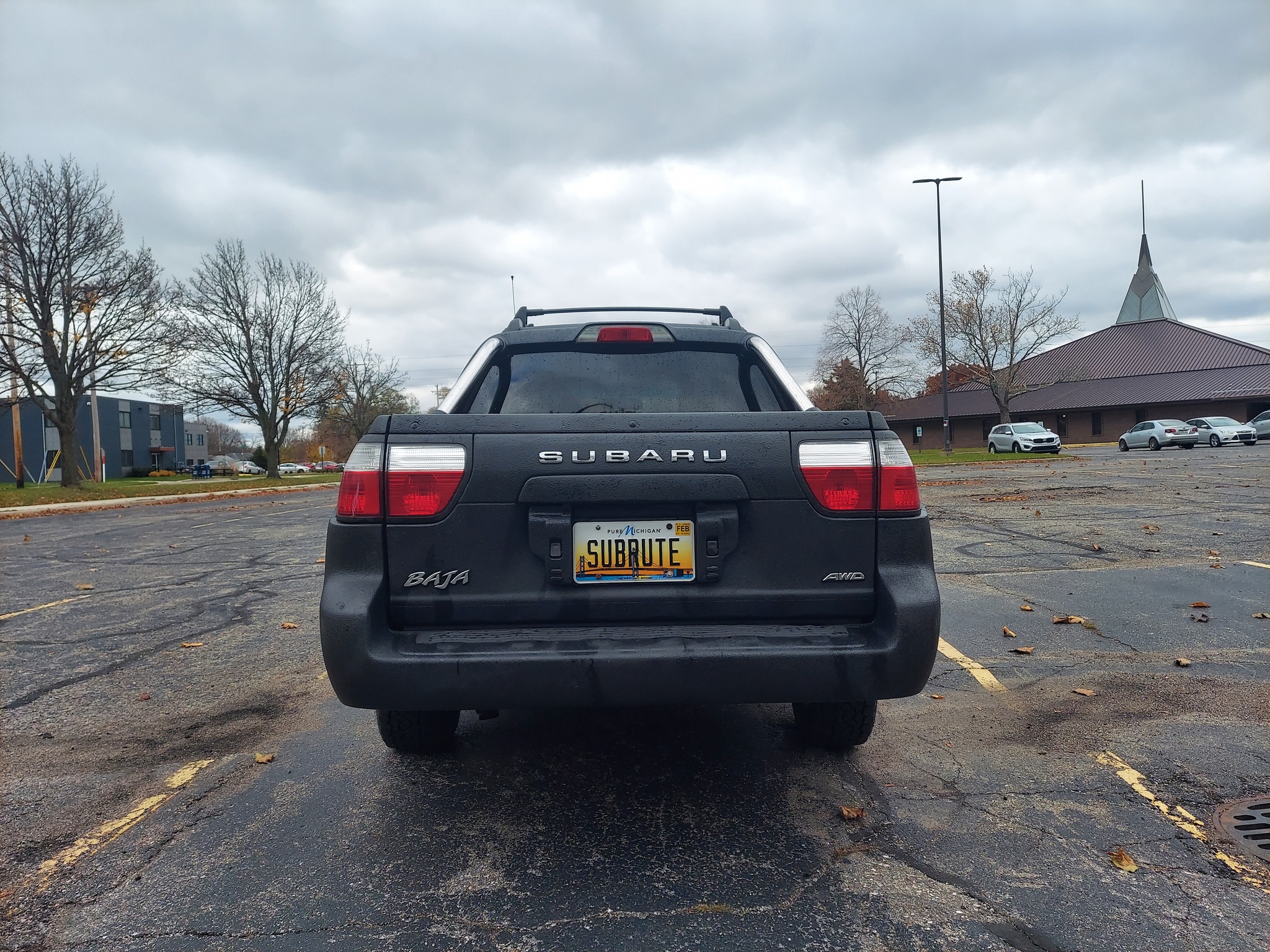

Oh yeah, you might have noticed. We decided to Raptor line the entire vehicle. Even got much of the bottom side to prevent rust as well. My son did a great job with sanding the entire car down himself. He even tackled the underside with the wire grinder. Wanna preserve this beast, ya know! We did the Raptor lining ourselves. I bought an nice air compressor because I needed one since moving into our new house anyway. The sanding was honestly the hardest part. That and I guess the taping. We had to do some prep work on the front bumper with some sanding and primer coat as well. But man, it came out nice.
- Complete FL.jpg (1.31 MiB) Viewed 34306 times
- Complete F.jpg (1.49 MiB) Viewed 34306 times
- Complete F Lights.jpg (1.58 MiB) Viewed 34306 times
...more complete pictures.
- Complete RR.jpg (1.22 MiB) Viewed 34306 times
- Complete R.jpg (1.06 MiB) Viewed 34306 times
- Complete L.jpg (1.02 MiB) Viewed 34306 times

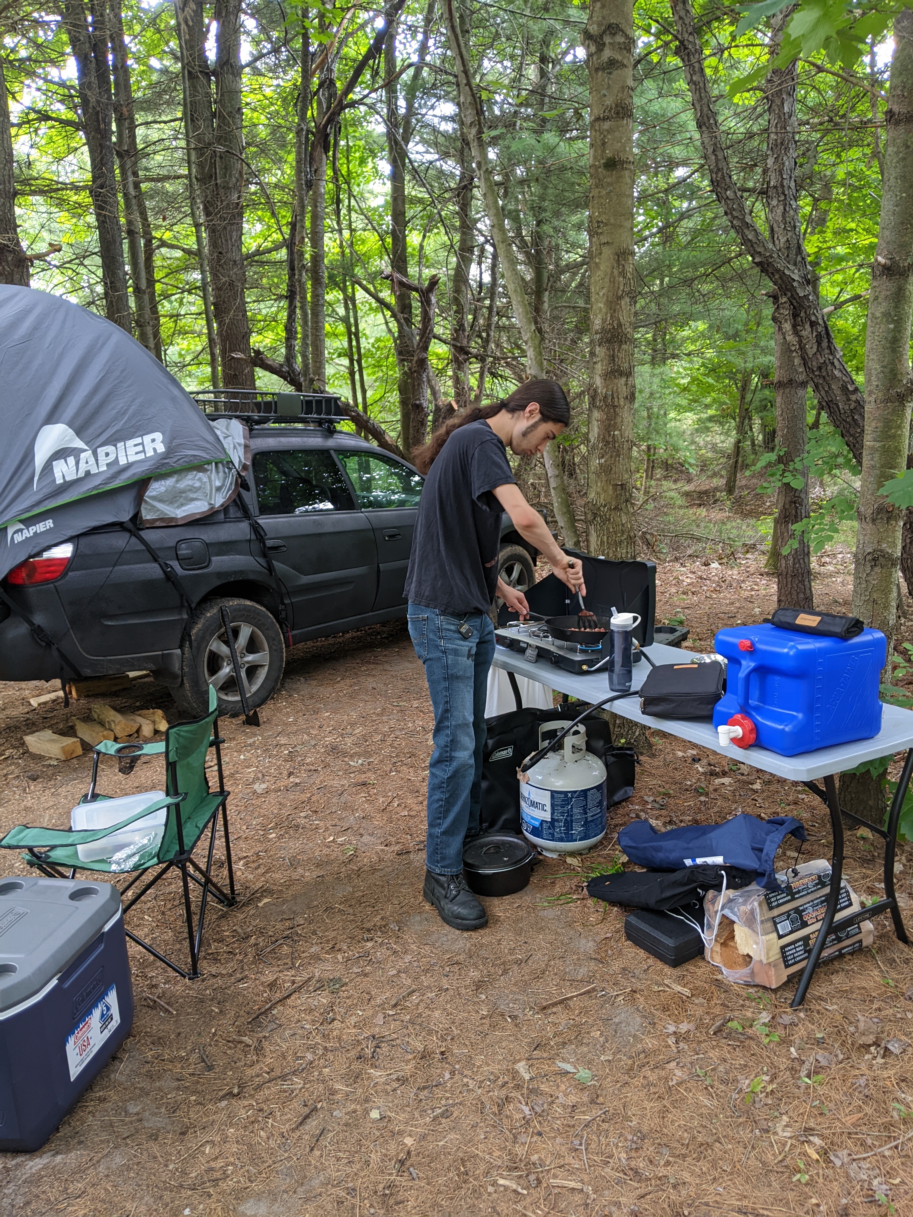

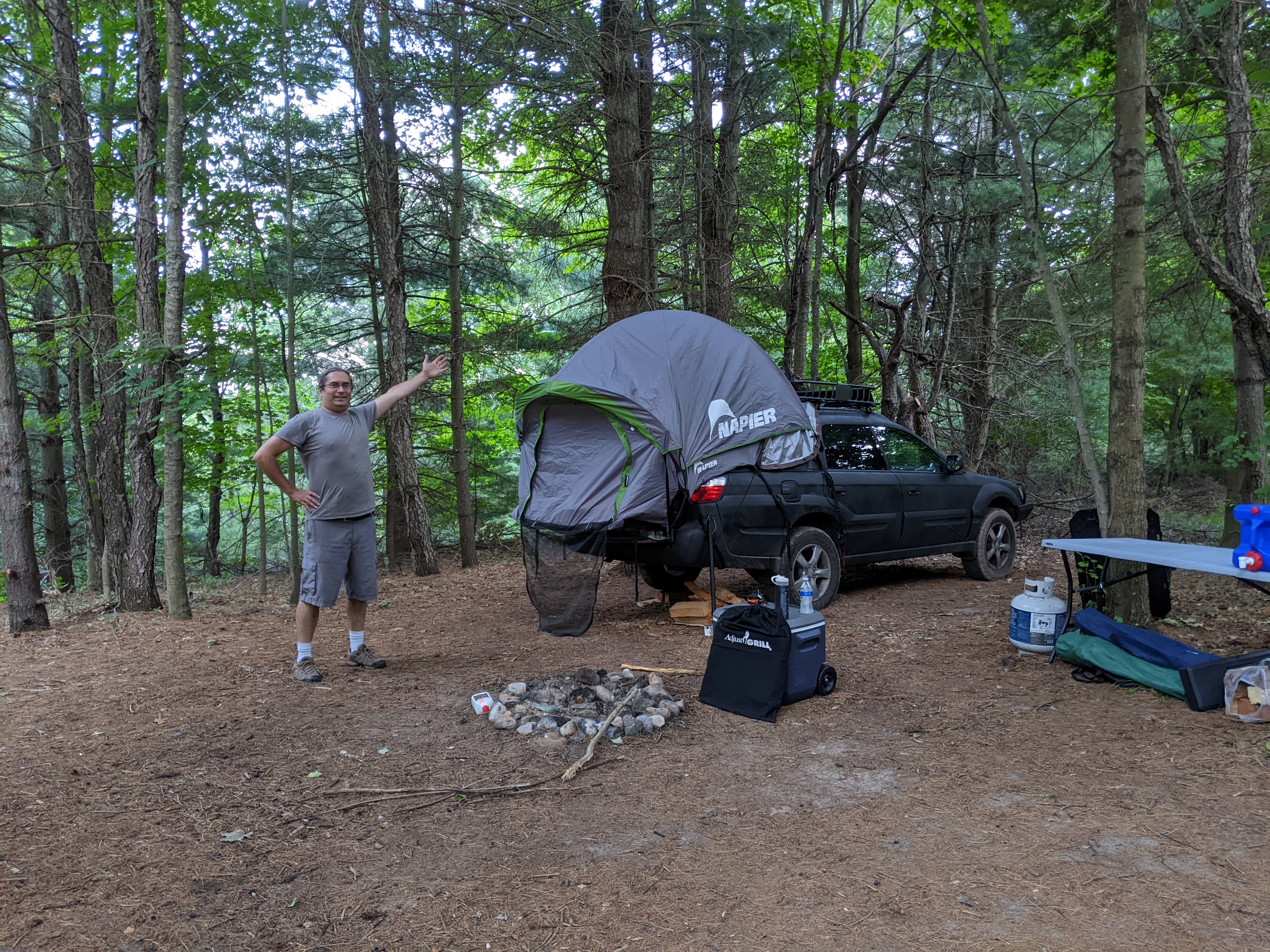

Since we had it all setup for some overlanding here are some pictures from our camping trip that we did near Lake Ann, MI.
- Camping2.jpg (4.98 MiB) Viewed 34306 times
- Camping1.jpg (4.64 MiB) Viewed 34306 times

A couple of notes because I know you all are going to have some questions.
First of all you probably noticed the negative camber on those front tires in some of the pictures. Yeah, that was an issue. So, the lift kit that we used is just a spacer lift. It didn't include supporting spacers for the rest of the suspensions bits or engine lowering. It was a cheap kit (I believe it was around $150) as we were working on my son's budget. If we had it to do over again we would have went for the kits that you can find for around $500. It would have saved us money in the long run and would have been a better product.
As is we had to have the lower camber bolt holes hogged out to allow the camber to be adjusted correctly. That wasn't too bad but we were lucky to find a shop to help us with that kind of sketchy mod. It works fine now ... but that was after we found out that the CVs were a bit too short. Found that out the hard way when they popped out going down the road. We were happy that it wasn't a much larger problem as I was concerned about it being the transmission. We had to have a few shops work together to lengthen our CVs. We bought they "heavy duty" option that Autozone sold when doing this as we didn't want to have to replace them again. They were lengthened about 1/4". Yeah, it was a little bit but it made all of the difference. Still the more expensive lift kit would have been the better option.

I'm interested in how you modified the Ranger bumper to fit. Can you elaborate. Pictures would be great too. Thanks!!

First off, I'll second the question on the bumper modification - working on something similar and really interested how difficult it was - especially the winch - it's connected securely to the frame? Have you tried it yet?
Well for the bumper we took it to a metal fabricator that we know. Our requirement was that the bumper be able to be removed so we wanted it to be connected with large bolts. Basically he welded on some brackets to the subframe for the bumper to attach to. He said it was a fairly minor job. Welding is a bit beyond our comfort zone so we were happy to have a guy for this.
I'll see if we can get some pictures of where it attaches to so at least it could be used for reference if anyone else wants to do this. I would imagine if you are comfortable with small welding projects that this wouldn't be a very big project. I don't think that the Baja has proper frame rails like a Jeep would or something but the subframe seemed ample enough to work.
As for if it is securely connected? Yes. I would say it is very secure. We have tested it. We did some winter tent camping and ended up getting a bit stuck in some sand hiding under the snow in a pit we didn't know was there. Luckily there was a boulder not far away. We attached the winch to it and it pulled us right out. Lifesaver too because we were kinda out in the middle of nowhere on a trail that would have been hard to locate and harder to get to for any kind of tow rig.
