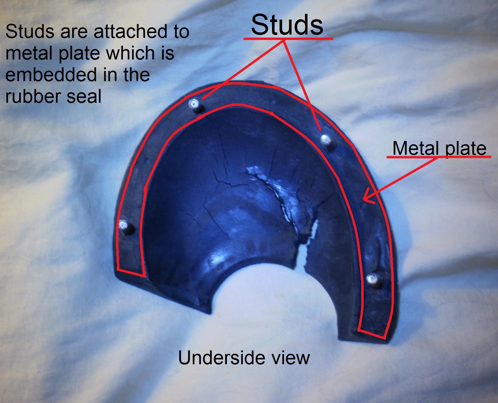

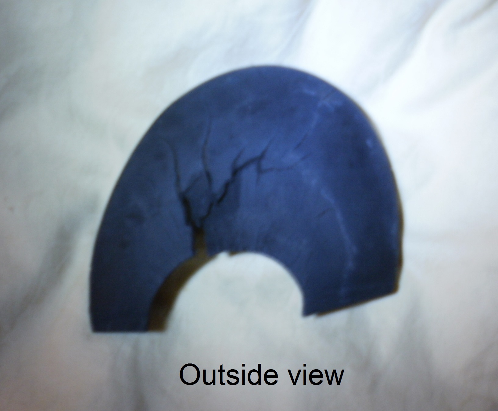

No, they don't just "pop" out and I wouldn't call them gaskets. I would call them seals as other have been calling them here.
Each rubber seal has 3 or 4 studs or bolts protruding from the underside of it that go through holes in the Tonneau cover. Nuts are screwed on from underneath (inside) the Tonneau cover to attach each seal.
When I bought my used Tonneau cover, it was damaged and missing almost all the the important metal parts used to attach it to the vehicle. (I had to fabricate all those parts.)
It had the old seals but they were severely dry rotted and almost crumbled in my hands.
The seals have crescent shaped light gauge metal plates embedded around the perimeter of the the rubber. The plates have small metal studs like small bolts (I think they're 10-24) with very thin heads attached to them (probably spot welded to the plates). In one photo I tried to show the outline of the metal plates
I have attached two photos of one of the old dry rotted seals that was in the best condition that I kept. (I took these photos and inserted the notations and lines and such in a rush so they're not the best photos.)
On one photo I drew in red an outline of where the plate is so you get the idea.
If you're going to use the old seals for mold making I would suggest you do it sooner rather than later. The more dry rotted and cracked the old ones get, the more deformed they will be which will be reflected in the new ones and they wont fit and seal as well. Also, make sure you place the studs accurately with the seal itself.
The new ones I have don't actually fit all that well themselves. The front and back ones don't line up well with each other so there are spaces where water can still get in which is why you want to be accurate in reproducing them.
If you do wind up reproducing them PLEASE contact me and let me know. I would REALLY like to know how they turn out.
If you have any questions just ask.
Good Luck!

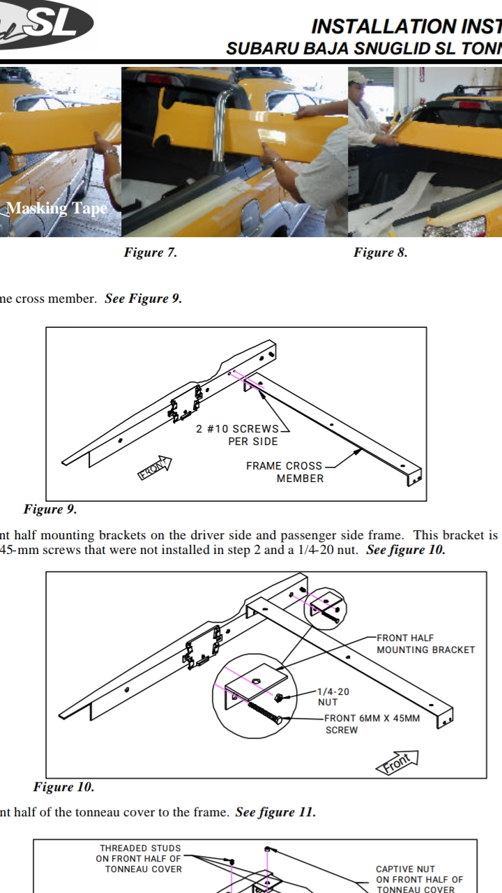

Re: SnugTop lid mounting rails & parts
Hello, would you happen to have the measurements of the cross member hardware? A picture would be great too. Attaching a schematic pic of the crossmember I'm looking for.
