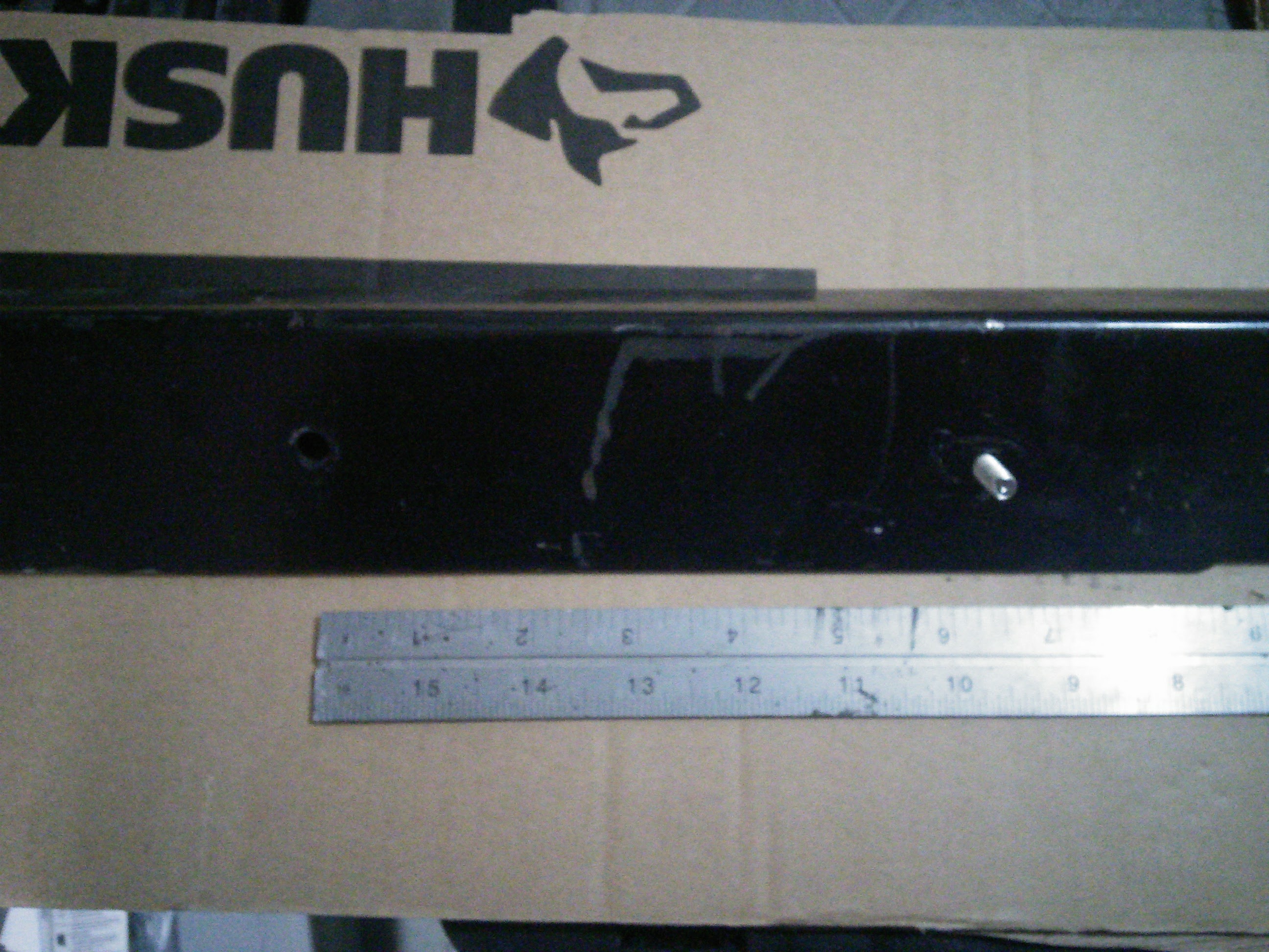

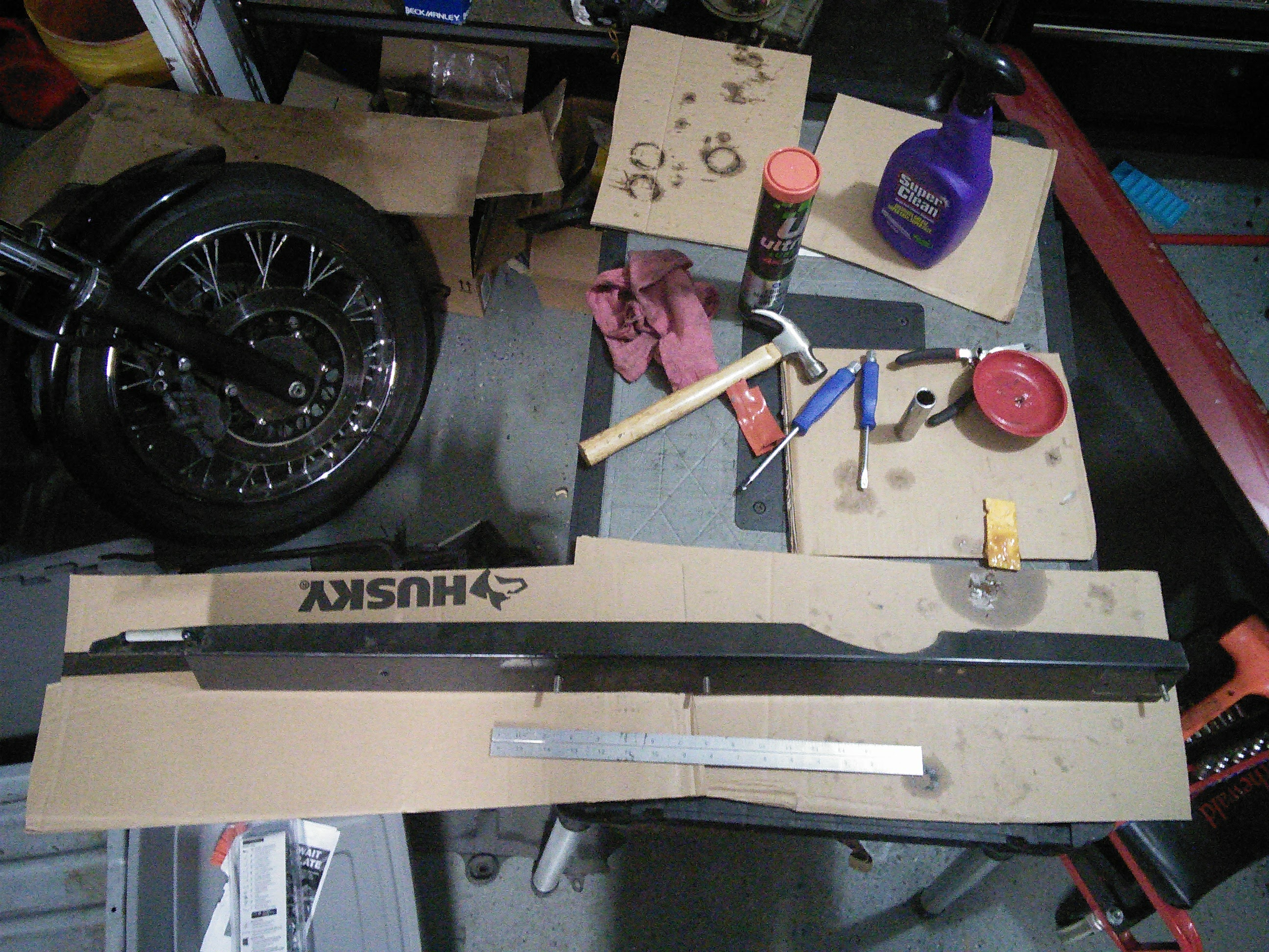

Hey if you need more info let me know.
All pics are on the LH side bracket if RH side is the same just mirrored.
P.S. my Photoshop skills are rusty i for got to how to stitch the pics together.
Specs:
over all length- 39 3/4 inches
length to the notch 36 1/4 inches
height 2 3/8 inches
with 1 1/2 inches
thickness 0.1220 inches
Specs:
height 2 3/8 inches
with 1 1/2 inches
- LH Side with 16in ruler.jpg (1.52 MiB) Viewed 35660 times
- IMG_20171204_191726.jpg (985.26 KiB) Viewed 35660 times
- IMG_20171204_191134.jpg (1.56 MiB) Viewed 35660 times

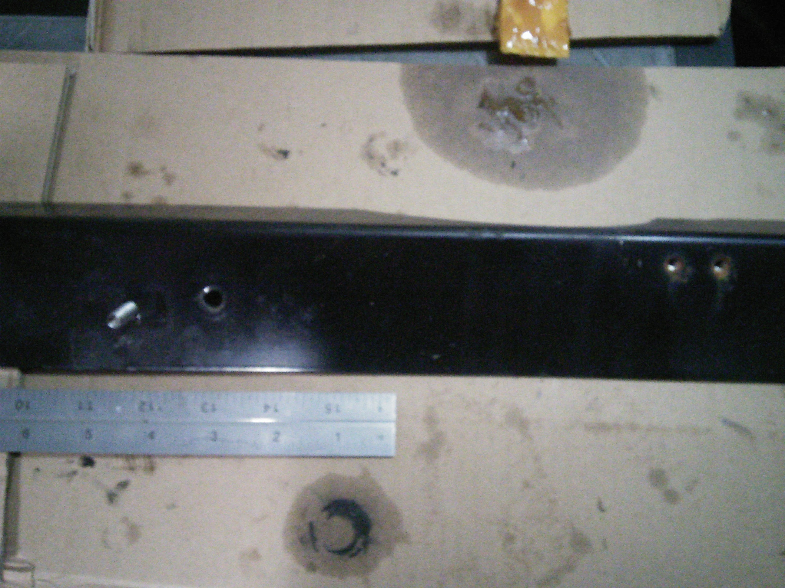

Allshownogo
- Posts: 23
- Joined: Tue Mar 18, 2014 6:36 pm
Re: SnugTop lid mounting rails & parts
Heres Sum Mo
- LH SIDE 3
- IMG_20171204_191606.jpg (892.32 KiB) Viewed 35660 times
- LH SIDE 2
- IMG_20171204_191559.jpg (890.6 KiB) Viewed 35660 times
- LH SIDE 1
- IMG_20171204_191535.jpg (901.33 KiB) Viewed 35660 times

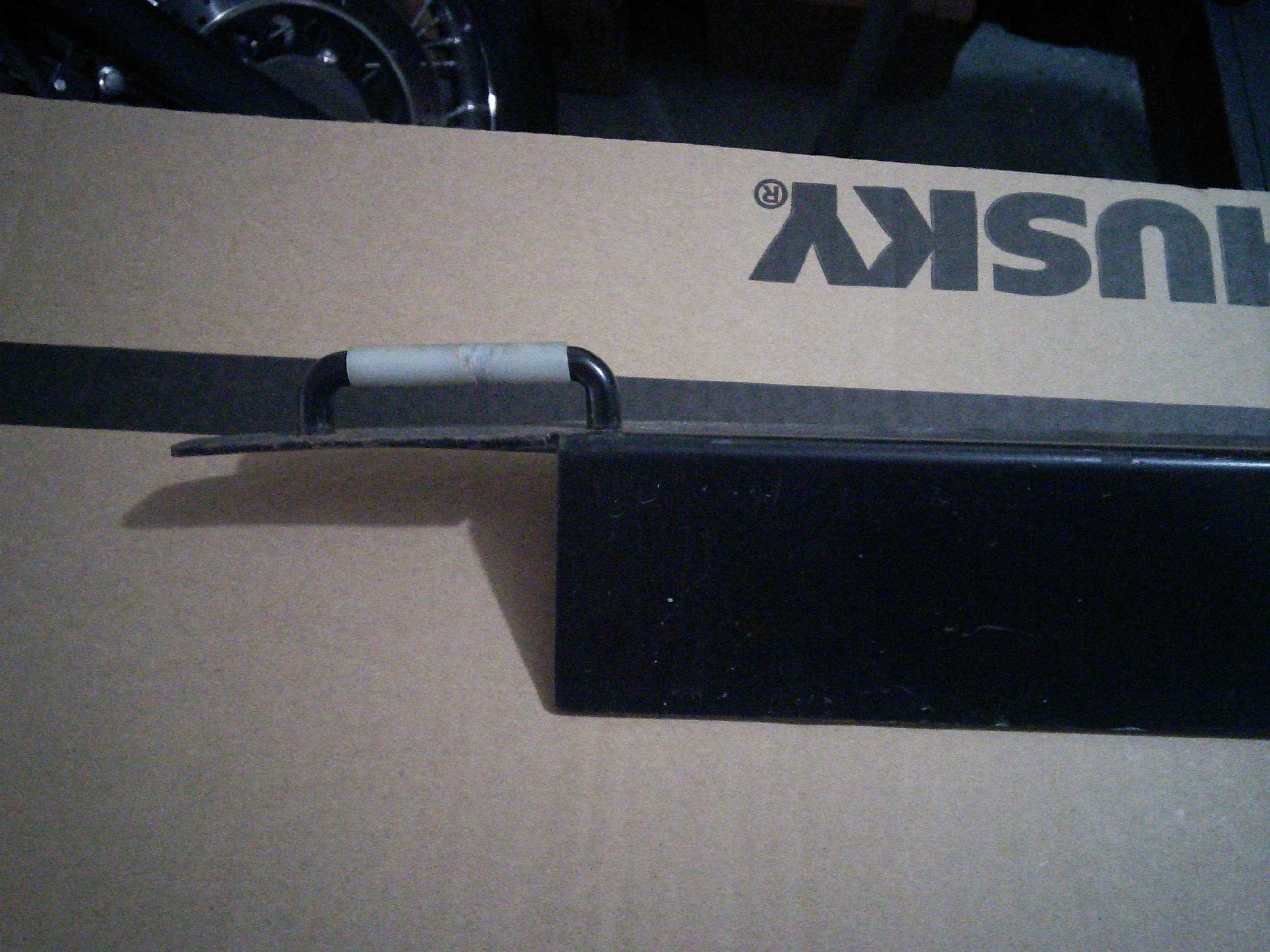

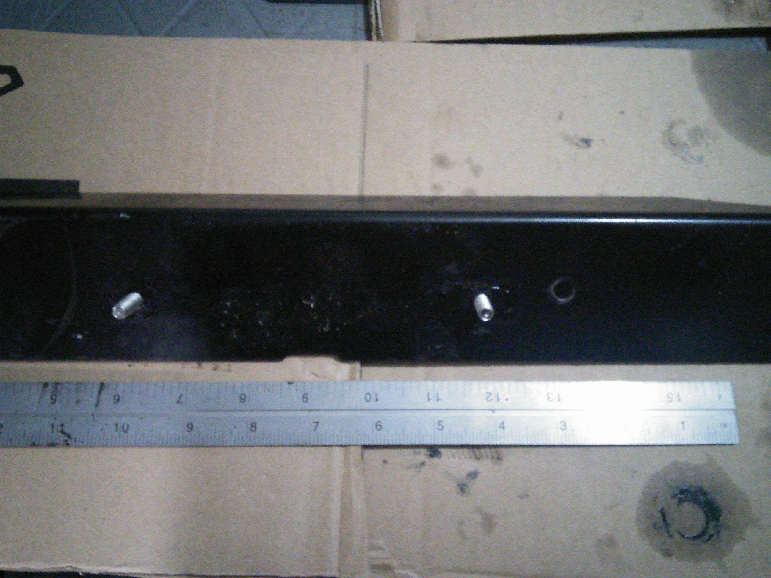

Allshownogo
- Posts: 23
MO FOUR YEA
- LH SIDE 5
- IMG_20171204_191632.jpg (871.17 KiB) Viewed 35659 times
- LH SIDE4
- IMG_20171204_191612.jpg (878.8 KiB) Viewed 35659 times
