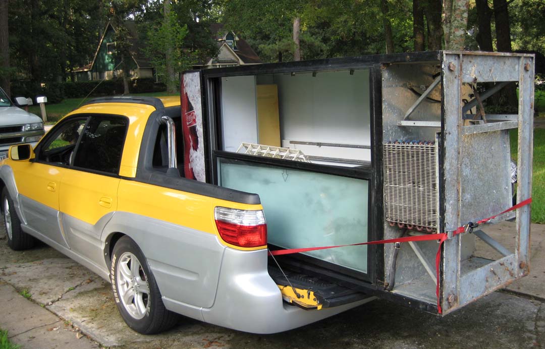

new member. Looking at building my own cap due to the exorbitant prices of the A.R.E. caps. Would really help if i could remove the roll bars. I know some vehicles don't really have true roll bars. What they actually have are appearance bars made to look like functional roll bars. Does anyone know if the Baja's bars are functional or they just put there for appearances sake. And if they are there for appearance sake, what is the best way to remove them? thanks, mike wood. Also, here's a pic of my truck hauling a glass front cooler.
