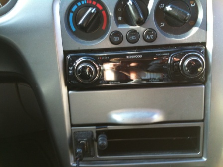

Well, clearly I'm a little late to the party, but here was my answer to the lack of USB support in my Baja. In my Baja, the USB location (lower left) was installed in the location of a dummy button. Not sure what 'premium' extra was intended to be controlled here.
I popped out the button, melted a hole with a s.iron, used a file to make a larger hole, glued in the USB port, then coated the entire mess in black felt. A little difficult to keep clean, but overall this little mod is insanely useful. Finished product looks kinda sharp. Mic for bluetoothing calls via the Kenwood headunit works great.

That is for the sport lights button.PatagonianBaja wrote:Well, clearly I'm a little late to the party, but here was my answer to the lack of USB support in my Baja. In my Baja, the USB location (lower left) was installed in the location of a dummy button. Not sure what 'premium' extra was intended to be controlled here.
