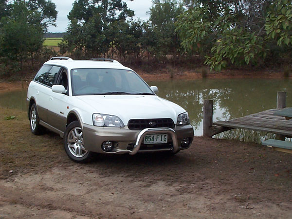

This is EXACTLY what I wish to accomplish...
baja bar.jpg (110.02 KiB) Viewed 13666 times
OK. Not to beat a dead horse, but I know I'm not the only one who wants a "bull bar", "nudge bar", "brush guard", whatever all the different terms may be for the same unit. I spoke at length with "Mudrat" the other day about fabbing one for me and of course, anything's buildable for the right price. I even have these capabilities where I'm from here in Wisconsin. Problem is, the Aussies will not (reasonably) ship the pre-fabbed units they offer, over there. Not that I'm lazy or lacking capabilities, but how cool would it be to be able to "bolt" one of these bad boys on? One additional key piece of info I may have left out is I want mine to be of the polished stainless variety to match the rear "roll bars" currently protruding from the rear of my roof to not only keep continuity, but it'll look like it belongs or was an option for this vehicle. I know I'm not alone on that request. I've seen the cute little "light bars" that others offer, made from the 1-1/2" tubing for mounting your off-road lights...not interested. I have no problem fabbing bracketry to my lower radiator support and/or bumper to give this thing some beef, but i'm after the 3" variety offered by everbody else (i.e. Westin, Smittybuilt, Aries...etc.).
Here's my offer for discussion or for research; I'd like to know who has the capability to determine which vehicle's front bumper design most closely matches the Baja front-end so I can end this vast trek I've been on since owning my first Baja in 2004. Again, I'm not looking to push-over oak trees here, this IS still just a Baja. BUT I would like to be able to pull up to another vehicle and "nudge" it or attach a strap and pull without tearing-out my radiator support. I fully understand it's all in the reinforcement of whatever I attach but that's MY problem and when I get to that point, i'll share it all with everyone. Let's get this resolved for all to share!
Thanx to all in advance...
Hyperjohnny
