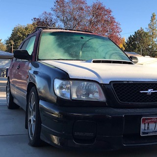

Thank you! I’ve been trying to find one and can’t find any anywhere I got a sti front end conversion from Japan and I’ve got the good scoop and splitter just need the top mount!

Looks good and our intake will certainly be a nice addition.I'll know a little more tomorrow or Wednesday.
