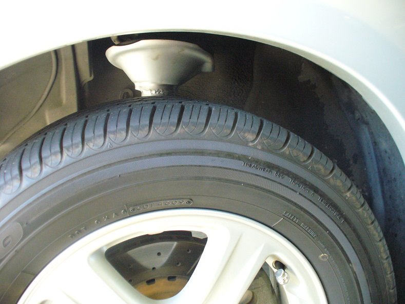

I have ! I had it done by John Bloom. He customizes the strut where it is raised up higher. My Lift is only 2 and a half incehs but it makes a difference.
Strut pic
Strut pic

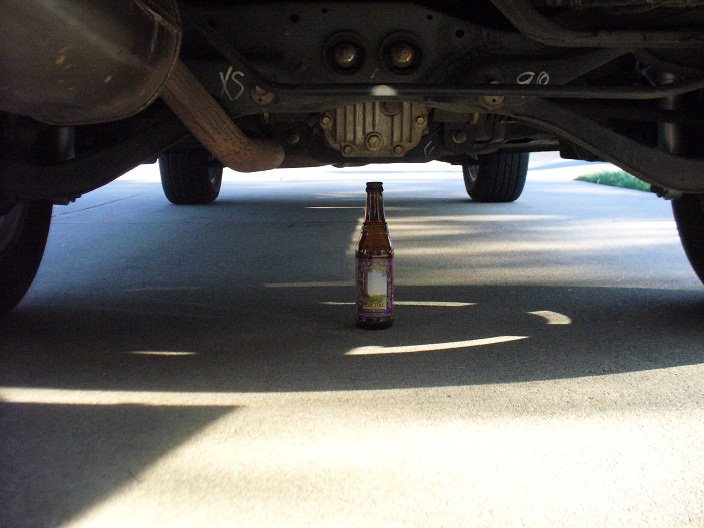

the lift 2.jpg (73.4 KiB) Viewed 28165 times
The space between the bottle and diff were snug before the lift... The difference is clear
The Lift.jpg (60.26 KiB) Viewed 28165 times

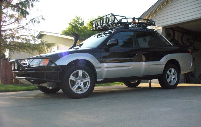

Re: Has anyone done a supension lift?
Side Pic
Side pic of lift.jpg (67.97 KiB) Viewed 28164 times

Hello. John Bloom cut the part where the coil meets with the Strut and moved it up further and then re welded it. It compresses the coil more. The ride is a little bit stiffer but feels great through corners and still feels good on trails. The drive axles have held up good... Atleast no problems yet lol.

Snorkeled wrote:Hello. John Bloom cut the part where the coil meets with the Strut and moved it up further and then re welded it. It compresses the coil more. The ride is a little bit stiffer but feels great through corners and still feels good on trails. The drive axles have held up good... Atleast no problems yet lol.
Interesting - I would have thought it would have been easier to extend it at the base - avoiding the need to rebuild the strut - unless I'm missing something. If I am understanding the description correction - doesn't that result in a decrease in travel? The net result maybe more clearance/height, but the location of the extension seems to affect travel - as opposed to doing the extension at the base of the strut where you would not be affecting the strut/spring relationship. Not sure if I'm making sense or if I'm not understanding the approach taken - but definitely has given me something to think about.
In the first pic where you see the strut, above my tire you can see where he re-welded the coil holder up a few more inches. The strut coil holder was below the tire wall.. If that makes any since.

Post by McBrat »
Snorkeled wrote:In the first pic where you see the strut, above my tire you can see where he re-welded the coil holder up a few more inches. The strut coil holder was below the tire wall.. If that makes any since.
moving up the bottom spring perch allows for larger tires to fit, which is usually the downfall of the newer Soobs when lifted...
For traditional 4x4s with body on frame construction, the body lift just raises the body alone without any suspension changes.
the Soob lifts fall into 2 categories. Suspension lift, or Combination lift. Suspension lift being either going to taller springs/struts from a different model, or adding spacers to the top or bottom of the struts.
The combination lifts include the suspension adjustments, along with a corresponding lift block everywhere that the subframe assemblies touch the body, which will net you the same as a traditional body lift, and this will keep the stock axle geometry.
Yes, the combination lifts are more costly as there are lots of blocks included to hit all the points...
http://www.sjrlift.com makes strut spacers and the full combination lifts. I have his 2" strut blocks waiting to be installed when I get new struts...
The strut blocks are angled to try and keep geometry of axles less impacted.
Strut bottom extensions would be better if trying to run some much larger tires... but they would be more costly to make...
