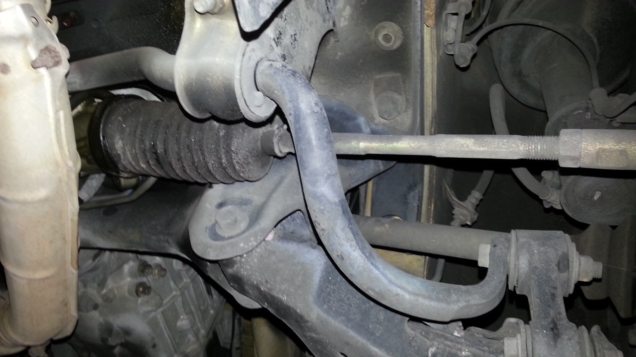

Also while under there, I noticed this boot leaking. Is this the CV boot? Drivers side.

That boot is either an inner CV joint boot or the steering rack/tie rod dust cover. I'm afraid I can't tell from that close. Does the outer end of that shaft run right to the exact center of the wheel, and have another rubber boot out there just before it goes through the brake disc? If so, then yes you're looking at the inner CV joint. If the shaft is offset to one side of the wheel, and doesn't go through the brake disc, then you're looking at a tie rod (steers the front wheel).

Sorry about the close up photo. The boot must me the tie rod end. It does NOT go to the center. I changed the photo for a little better view. I will look into the complexity of fixing that.

That is the inner tie rod boot.

Ah, now I can see better. Yes, it's a tie rod boot. To me, from here (across the internet
), it looks like you might possibly have a leaking seal in that steering rack (that's the thing at the left end of the boot in the photo). You know, I had a weeping seal on my steering rack when I got my Baja a few years ago, as well as some other leaky/weepy seals, and I was able to eliminate them all with an application of Auto-RX. I've used that stuff several times now on multiple vehicles, and it's truly, genuinely a good product. Not knowing exactly what's up with yours I wouldn't have any idea what it would take to fix, but add .com to the product's name if you decide you're interested.
