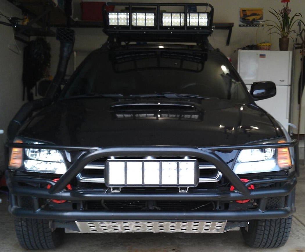

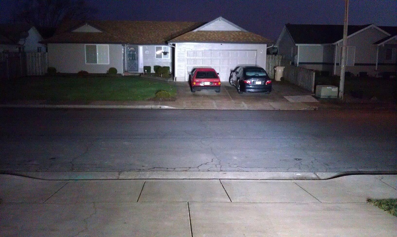

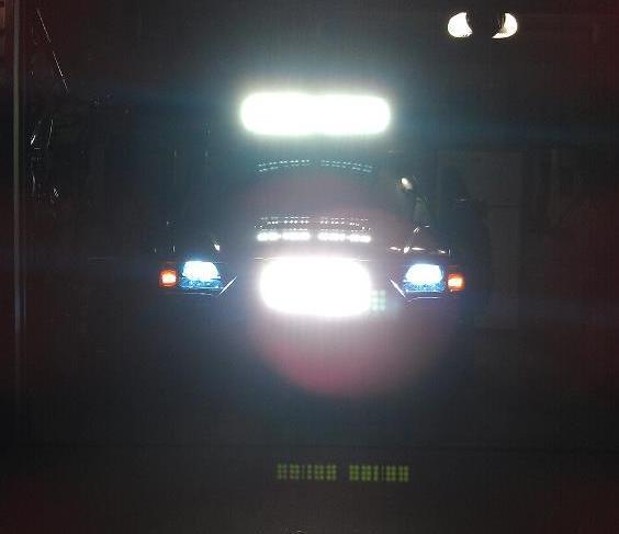

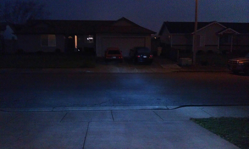

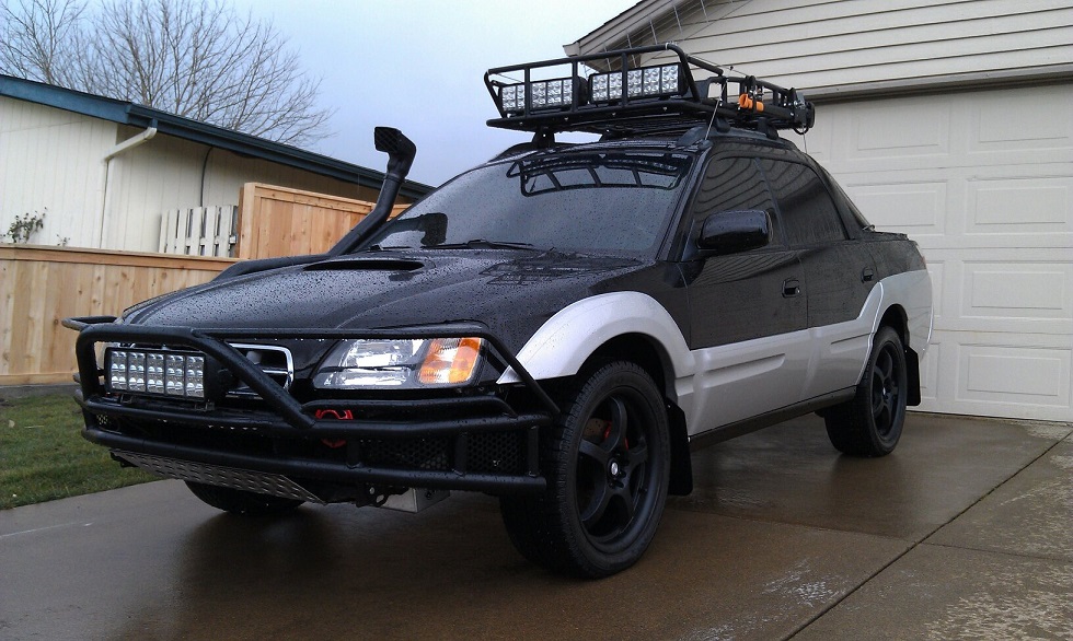

Before After pic of Plasmaglow Led Light bars... Before pic with regular headlights on... After pic with ALL front lights on.

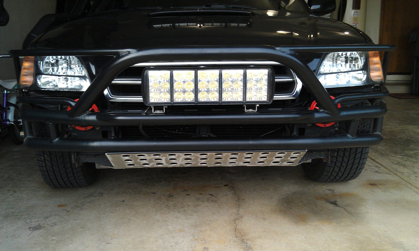

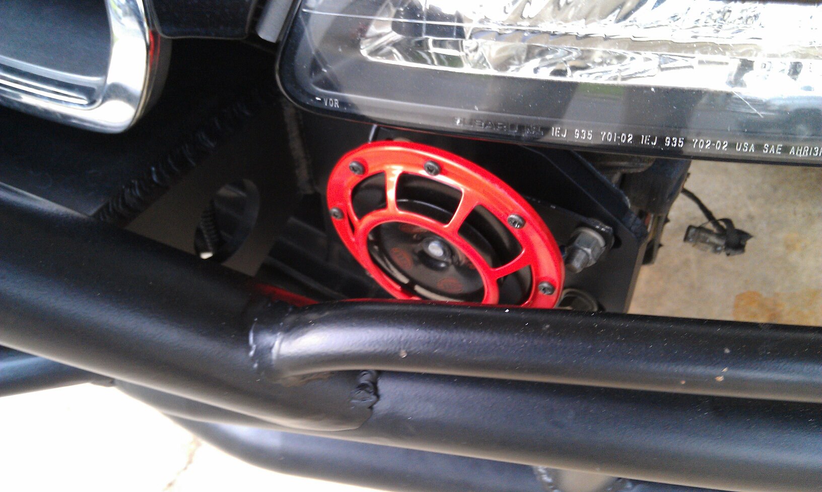

Day pic of the front

Looks nice.
Just keep an eye on your temp gauge in the summer. With 2 Hellas mounted in the same spot on my MudRat bumper I had some overheating problems. It was a hot day, 95+, and I was running fairly hard (75 mph) in tight traffic. But as soon as I spun the lights 90 degrees so they didn't block the airflow things were cooler.
Re: Plasmaglow Led Light Bar.. Before -- After pics
yeah I noticed that my radiator fans turn on more even though engine temp is normal ... hmm if it gets weird I will either move the light to a different spot which I really don't want to do, ... Or ... get a bigger radiator to keep things cooler.. I don't know , we will see lol

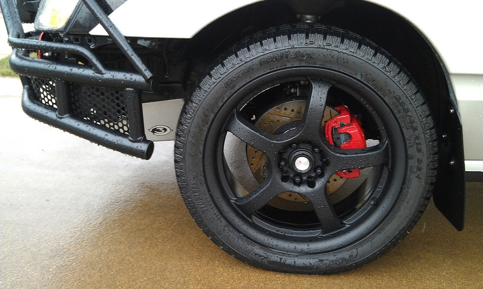

wheel view

I had a custom 3 stage Radiator built for my Baja. It keeps everything running nice an cool [smilie=666.gif] I was having trouble with it over heating a little ... But not anymore.

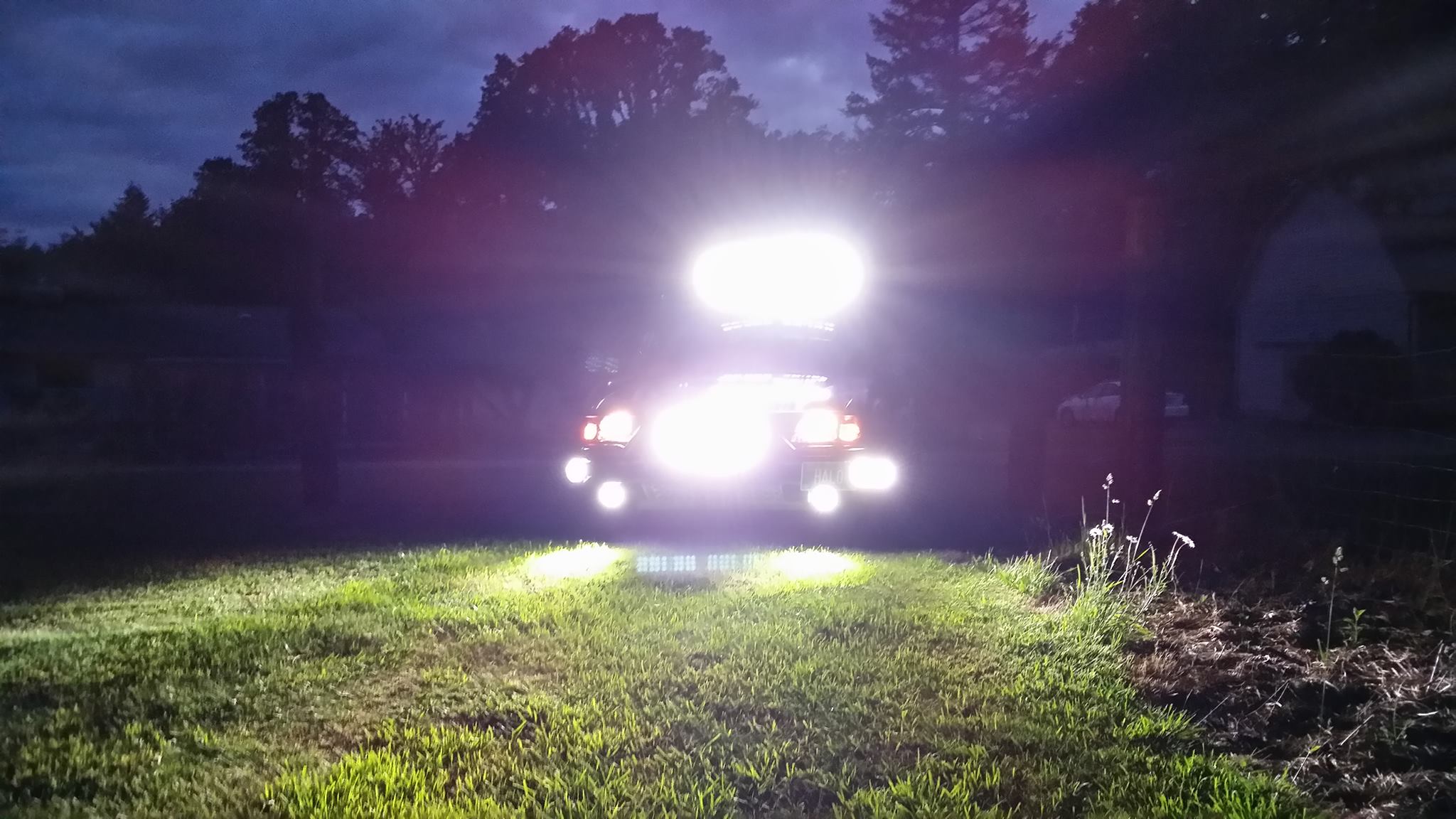

Recent pics
