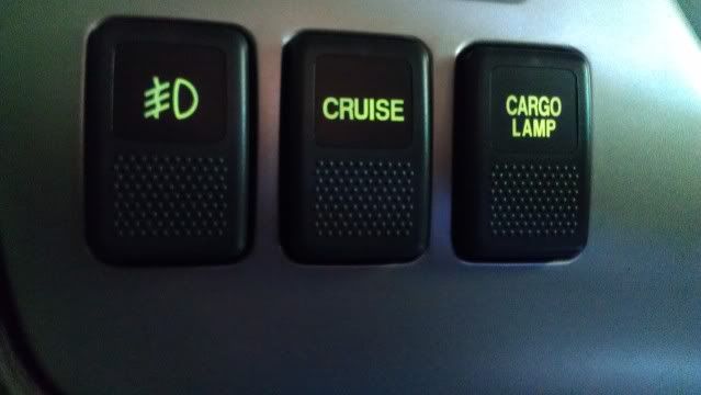

So, I've searched and read postings on this site and others regarding dashboard lights. My issue is that in the three buttons to the left of the steering column (Fog Lights, Cruise control, Cargo Light), the buttons are not illuminated with the rest of the dash. They used to be. Now, I've taken off the trim etc, and gotten into the buttons and found the bulbs in question. They're tiny - about the size of a tic-tac, have a small plastic base less than 1/4" in diameter. I'm not sure if the base come with the bulb, or if the bulb comes out. The base inserts into the plastic button part, and locks with an 1/8 or 1/4 turn.

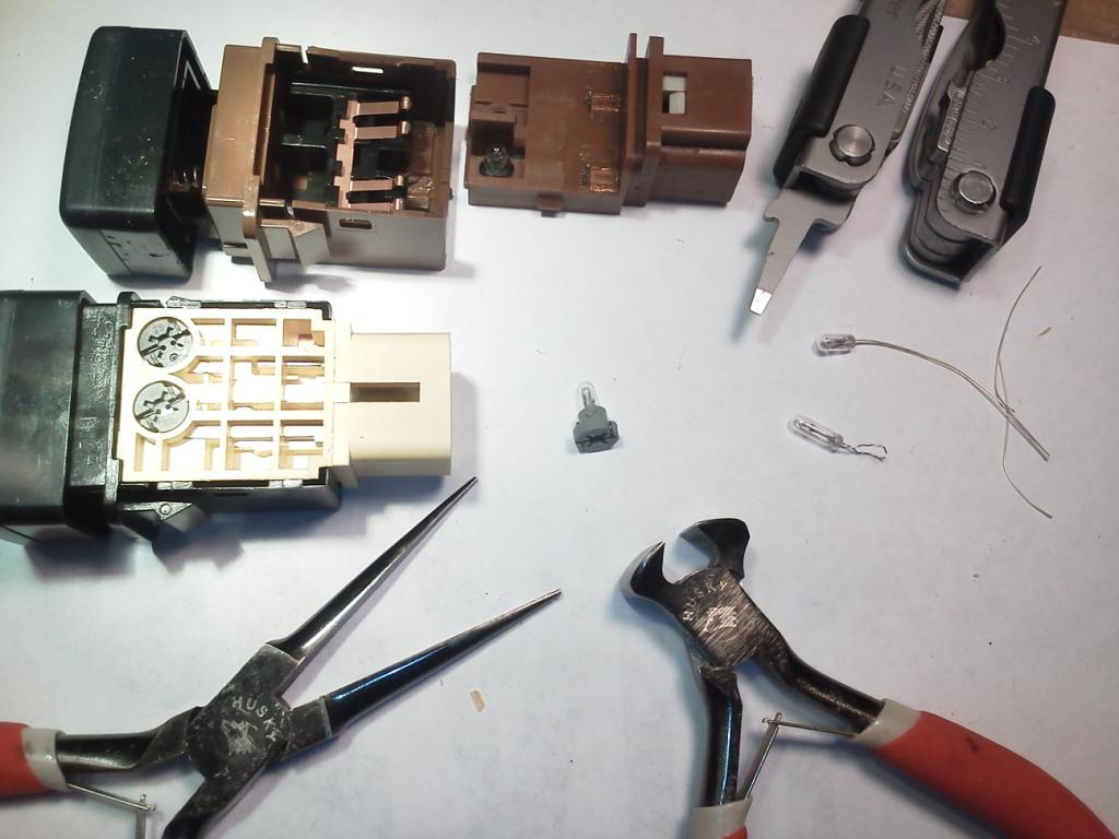

I'm attaching a pic I took of all the tiny bits one works with to make this swap. In the center of the pic is the dead bulb still in the grey plastic base. Then starting at the 9 o'clock position and working clockwise:
. (Black & Cream colored) this is the complete button for the Fog Lights. The two disc-shaped parts are the underside of two bases, with the bulbs pointing down into the housing. The lower one (from this point of view) is for lighting up the button icon or description (comes on with the dash lights). The Upper one is to indicate the device is ON. They're actually two slightly different shades of grey, but I can't see how that's relevant to the working of the unit.
. Above that (Black & Brown) is about 2/3 of my Cruise Control Button. This shows the metal contacts inside the button. Not much else.
. The Brown piece to the right of it is the other third. (at the 12 o'clock position) This piece will flip over top to bottom and mate with the other 2/3 by sliding down and snapping into place. In the lower left of this piece you can see an older-but-still-working bulb. When this flips over it will be on top and indicate that the CC is on. The bulb with base would slide into this piece from the underside, and rotate clockwise (from the underside's point of view) about 1/8 turn to secure it in place.
. In the upper right corner is my Gerber multitool, which I love. The small flathead is exposed, because that's what was useful in separating the 1/3 of the button (containing the two bulbs) from the other 2/3.
. Below that is a new bulb with long leads - next to the two leads that I'd trimmed off the bulb I already installed in the Fog Light button. N.B. when inserting the new bulb into the base, be sure NOT to twist the bulb. The two leads go through 2 holes in the bottom of the base; if the bulb is twisted, the leads will start to wrap around each other and short the circuit, never light up, and possibly draw more current than the circuit is designed for.
. Below the new bulb is the old one I'd taken out. The leads are short & wrinkly. The body of this bulb is a bit longer than that of the new bulbs. As it turns out, thankfully, it doesn't matter at all.
. Lastly are a couple hand tools: End cutters, useful to snip off the excess lead length, after wrapping the length I need around the bits of the base.
And the skinniest needle-nose pliers I have, for use in undoing the wrapping of the leads on the old bulb to extract it more easily.
I just tried the new bulbs in the car and the bulbs work just fine. They're even a bit brighter than the older OEM neighbor in the Cargo Light button. I'm betting it's because these are 12V bulbs, and possibly not designed to work with 13.8 volts from a running car. We'll see how long they last. Even if it isn't long, the cost and time to replace them again is certainly manageable.
