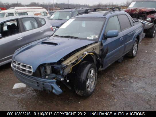

Any feed back would be greatly received. as you can see from the picture the car had minimal damage....I have more pictures of the damage. nothing was badly bent and no bags deployed.
This was the extent of the damage. needed a new front bumper and wings to be straightened. I brought from a company that buys and sells rebuilt title cars. the car now is fantastic.

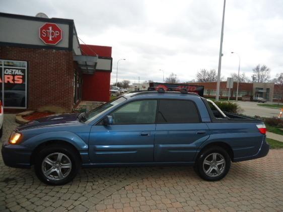

Here is the car today after the work is done
Here is the car today....we have had it three weeks now

oooh nice pair ! both yours ?
Re: strange noise ?
The blue is the wifes, Red one is mine..Hers still looks the same, mine is a little different now, that picture is from the day i picked mine up...

That was one of the things I want to do to our Baja, is fit the roof lights.
