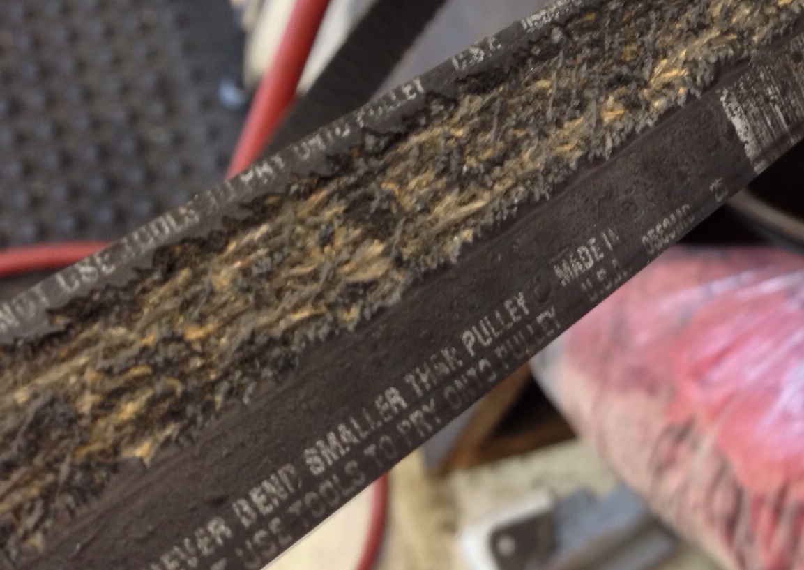

I bought my 03' with 120k and didn't know the history of it. Didn't know if the timing belt had ever been replaced and therefore, I always had a bad feeling about it. Now with 130k, I decided that it's time to replace it along with the tensioner, pulleys and water pump at the Subaru dealership I work at. Apparently the belt had been changed before, but whoever did it, tightened one of the guides down too tight and it was rubbing. It was so close to snapping :shock: . All better now. :D
