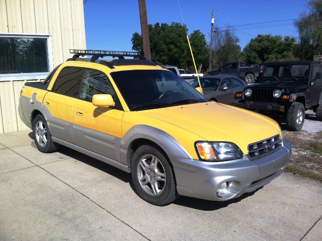

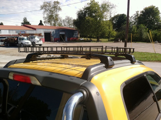

My BAJA didn't have the cross bars when I purchased it, but I had a wrecked 2002 Forester, so I pulled the bars off it, and modded them to work on the BAJA...
I'll post pics as I can, and maybe a how-to on what mods I had to do when I get a chance to type it up..
Had to cut the rear bar down 2 inches, but made the front one work with existing adjustments.

Not much to it, just took a sawzall and cut off one end, and drilled it to mount the "Foot" back on the end.
The Basket is the Subaru Basket, was purchased from Subaru, by a friend of mine when the BAJA's first came out.
