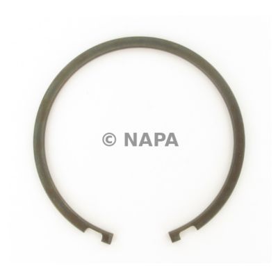

Hello Everyone
I know this is an old post, but I had
a related question and some info.
All the auto parts stores seem to carry
the bearings on their websites.
Is there anything else needed to replace
the bearing, other than the bearing itself?
Are there any seals etc. (I don't see anything
listed).
One site says to replace the retaining circlips
(a must for me), but I don't know if there are
one or two clips per side? I attached a pic of
the circlips ($6 each)
Here's the info for what it's worth:
listed).
