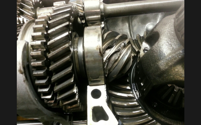

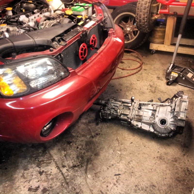

Just this past winter the bearings in the rear of the trans started whining real bad. So I ordered the 4 new bearings. A week before I had time to replace them, the trans started making a terrible noise. Like rocks in a blender. I was able to get it home and in the garage. I drained the trans fluid and a huge chunk of metal came out.
After that I ended up having to pull the trans out. Split the case and find out what broke. The ring gear and pinon gear both broke teeth off.
Anything could be broken in the trans. You could start by draining the fluid, lookin for chunks of metal and checking the drain plug magnet. If that checks out just refill the trans.

Re: manual trans sounds like rocks in a blender
That looks pretty bad did you do the work yourself and how much where the parts and from where

I did the work myself. One of the many benefits of having a certified Subaru mechanic as a close friend. He talked me through the process.
I would say for the bearings, gaskets, ring gear and pinion, fluid and a few new sockets, I spent right around $900. All parts were purchased from my local Subaru dealership.
