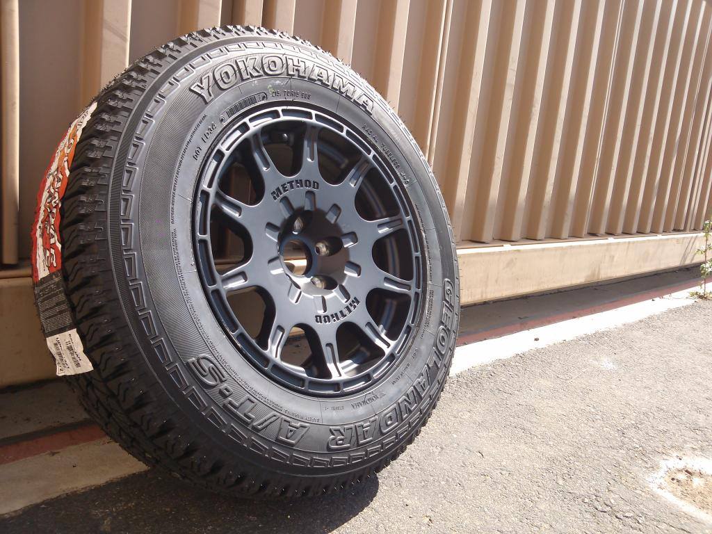

Re: BIGGEST TIRE SIZE FOR MY SUBTLE SOLUTIONS LIFT????
Had to do some cutting and hammering to get these tires to fit.
Method wheels 2.jpg (102.68 KiB) Viewed 13339 times

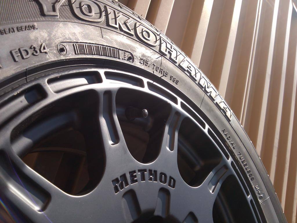

side pic
Method Wheels.jpg (143.76 KiB) Viewed 13339 times
