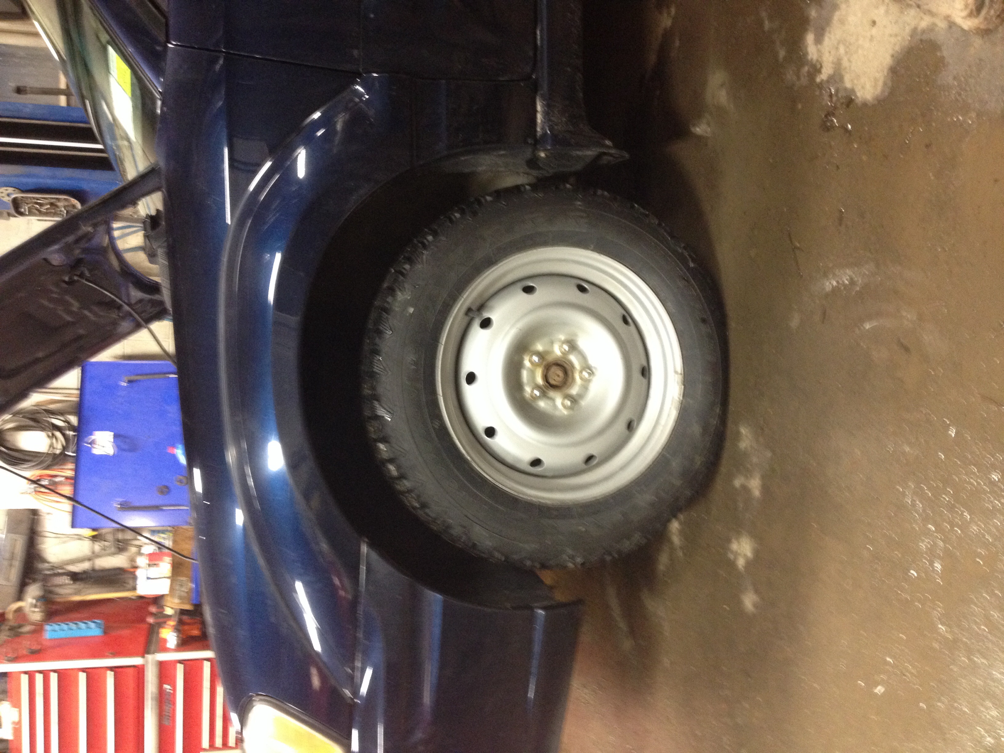

I did swap the H6 struts n springs off a 2002 and it gave me the lift in the front I was looking for. I haven't tried the rear struts yet
After photo
After photo
