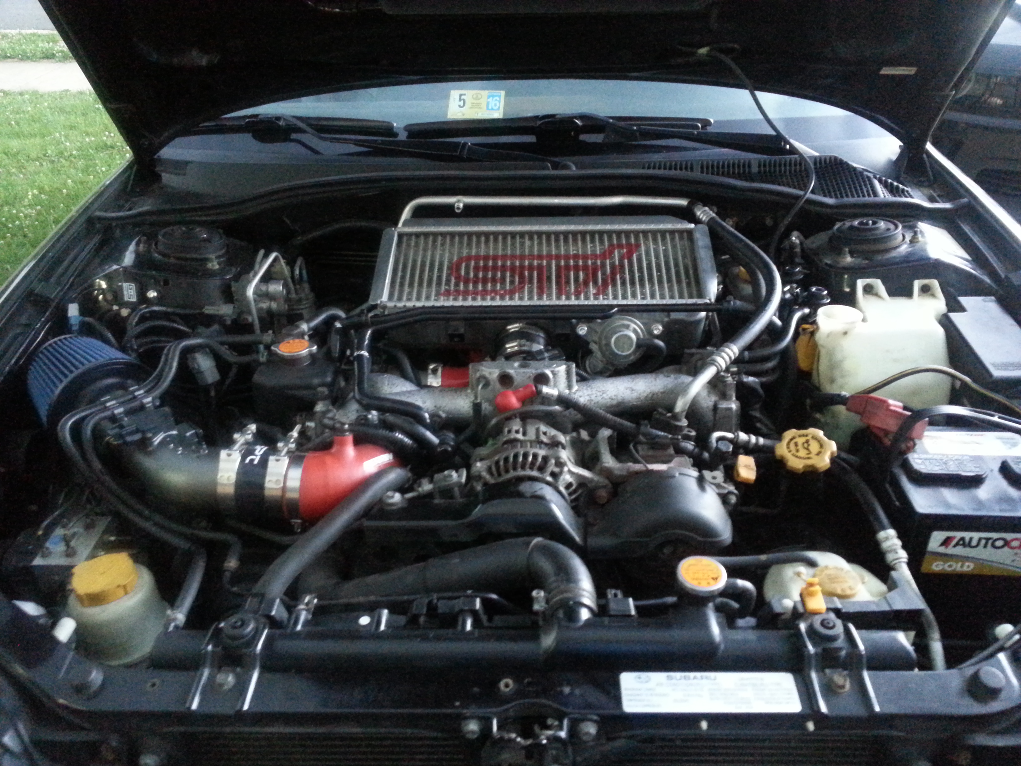

Here is the first pic, all I have to do now is swap the midpipe and axleback then take it for the tune. I am using Mach V Motorsports in Sterling VA. Next up is the lift kit and some details like the carpet, front axles, and then the long wait till October when the tires I decided to use go into production in my size. I have the wheels and a set of STi brakes sitting around waiting on the tires. Time permitting I will probably get the coil overs done before the tires arrive.

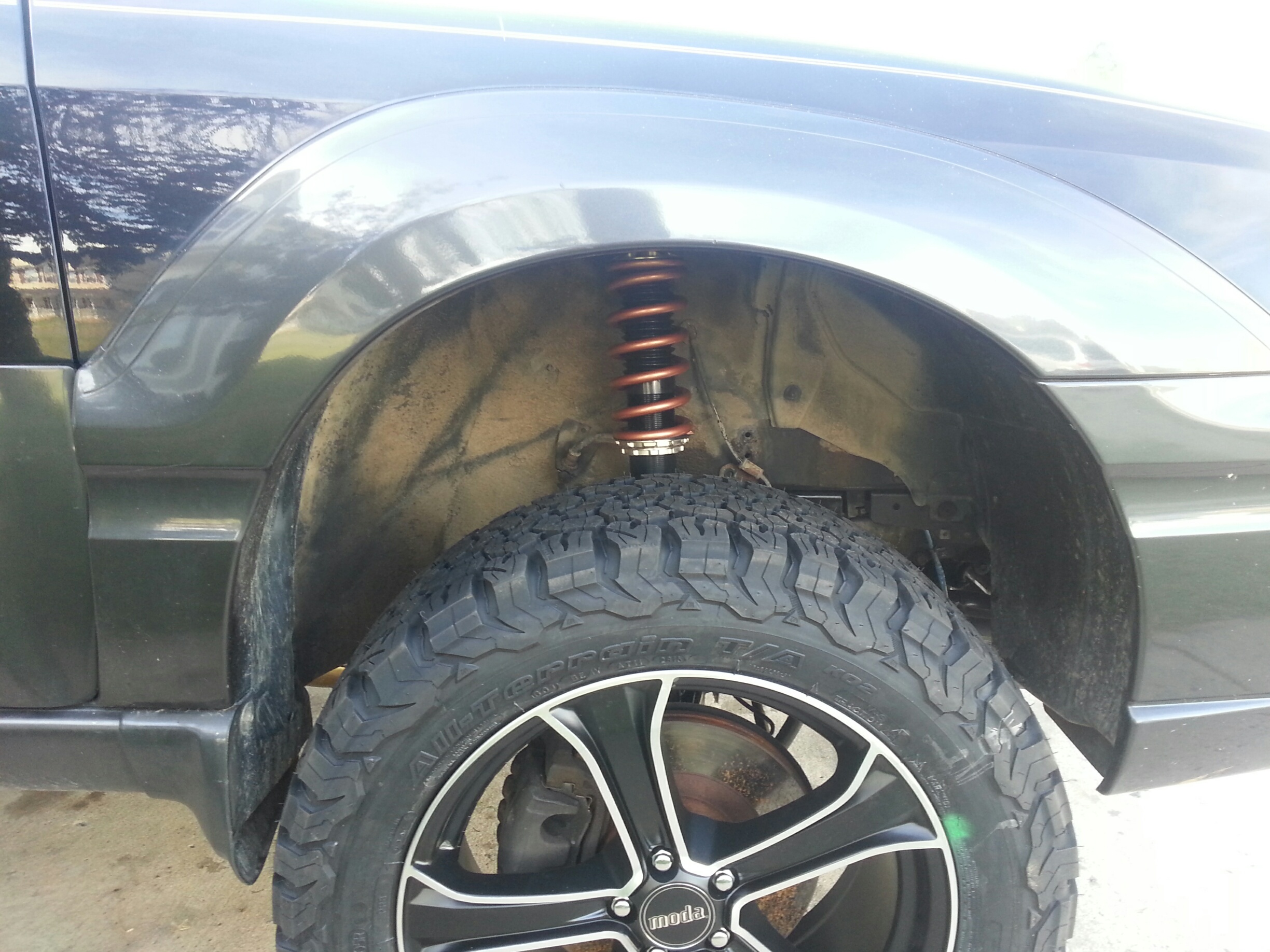

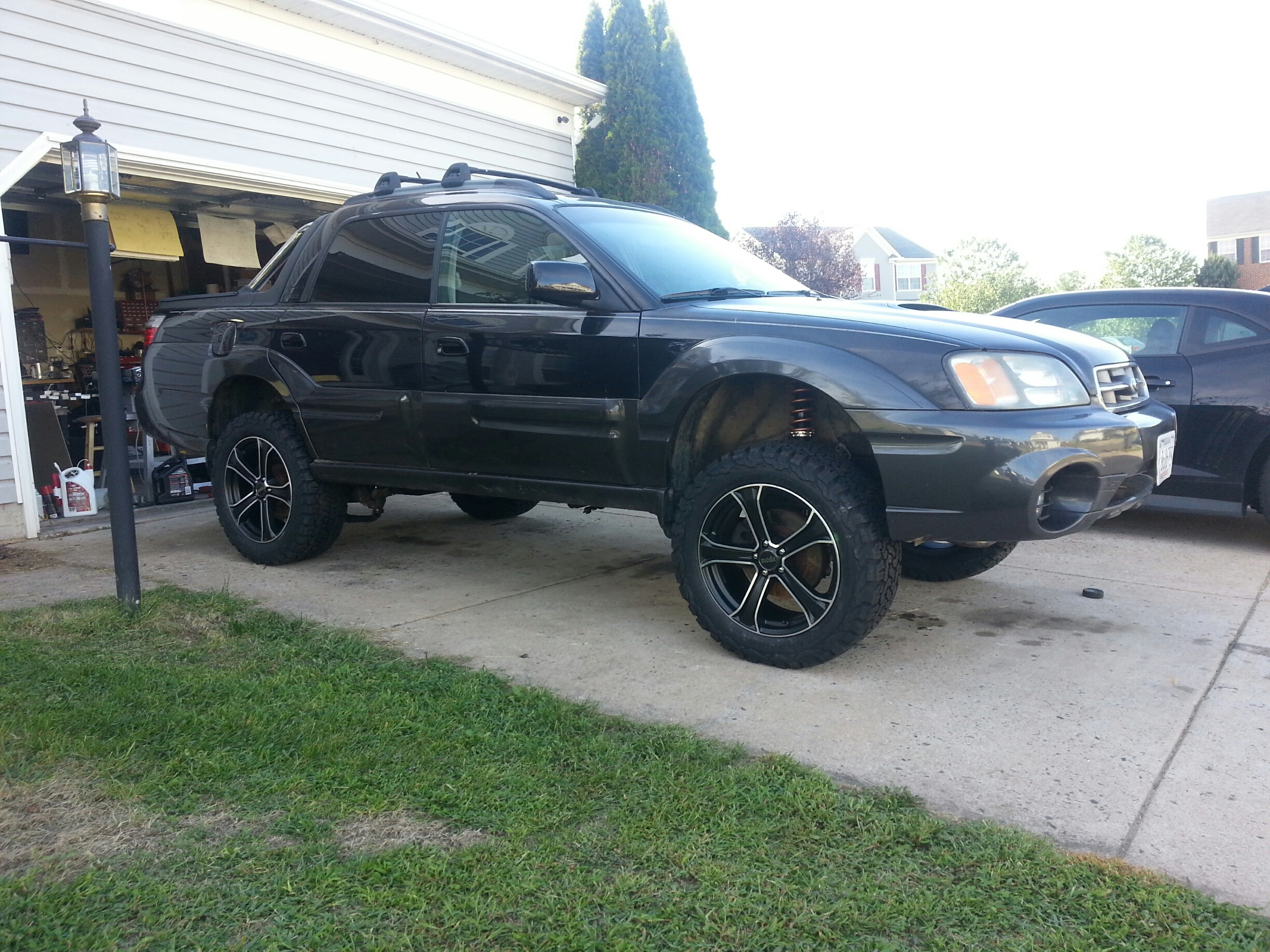

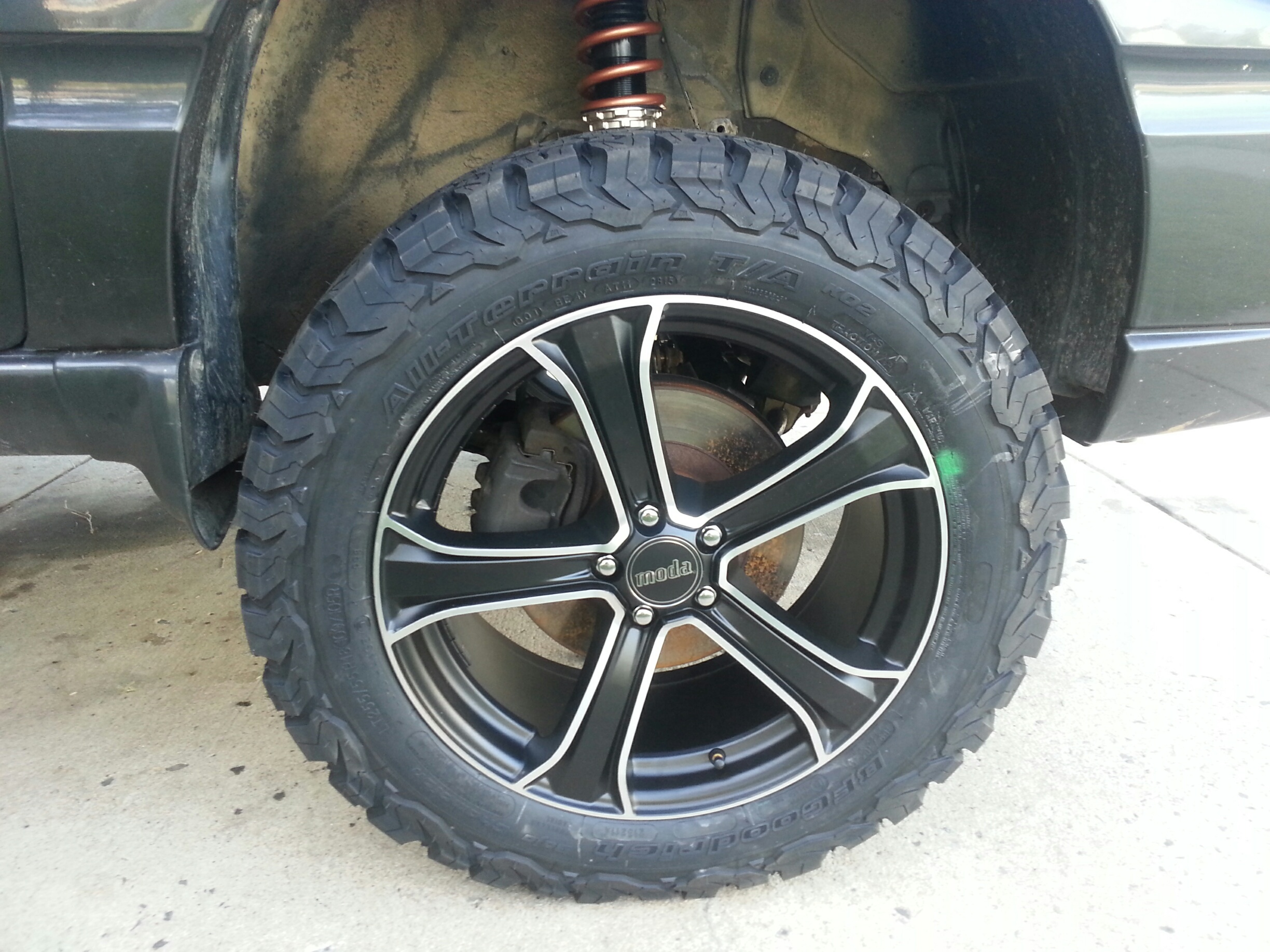

Finally some progress to report. I had been sitting on the lift and suspension waiting till closer to the predicted time that the 255/55/18 KO2 tires would be available and started in on the lift last week. Much to my surprise the tires showed up as in stock at tirerack about 2 days ago and they showed up today! As it sits now the 5in lift is installed and coil overs are set to the same height as stock, I can adjust about 1.5 in up or 1.5 in down from how it sits now. The big metal bits of the lift are in and if all goes well I should have the various hoses and linkages etc all done this week. Then I have to sort out the intercooler and an air plenum for it, so maybe drive it next next week after the exhaust is done too? Then it is STi brakes, tube bumper, and then a dip job.
Front coil overs:
Wheel and tire combo;
Re: Baja Raptor 2.0
Wow, that looks mighty and impressive! How is the tire clearance? Any rubbing at full lock?

Tire clearance will be good in the rear after trimming about 1in from the front and 1/2 in from the rear of the wheel well, strictly speaking it is OK now but you need more for ice and mud to clear properly. The rear of the front wheel well is where any clearance issues could arise, I had minimal rubbing on my other lifted Baja with the same height tires and less lift that I had to resolve with some trimming and re-shaping. As soon as I get this truck on the road and see where any changes need to be made (if any) I will post those here.

Post by Acro2pilot »
In the rear, very little is needed. You can remove the plastic trim and cut off about an inch of excess metal, paint and reinstall the trim on the door side. On the mudflap side, same deal; remove mudflap cut away some plastic and re-install.
The front is fine ahead of the wheel. At the rear the trouble area is inside the rear part of the wheel well. The mudflap is easy to move back the same as you do in the rear, it mostly clears as is but by adding some space it looks better and allows mud/snow to eject. That inner rear corner is where your going to rub if you do. These tires are the same diameter as the other ones I used but I have an extra inch of lift starting off and can dial in more. If I need to, I will cut slits vertical in the metal and pound them in then TIG them back together and repaint.
