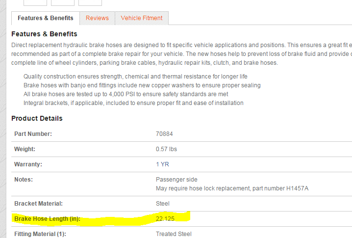

What I did was check the AutoZone website for the lengths of the OEM lines on the Baja, find a vehicle with the same lengths, and order the kit for that vehicle.
For me, the Technafit SUB-1120 (http://www.technafitstore.com/SUBARU-BR ... b-1120.htm) kit fits the 2003 Baja.
Previous post: viewtopic.php?f=3&t=408&p=16851#p16851
Re: Brake line specs
If you just want the lengths, check the Product Details:
http://www.autozone.com/brakes-and-trac ... 6223_5913/
