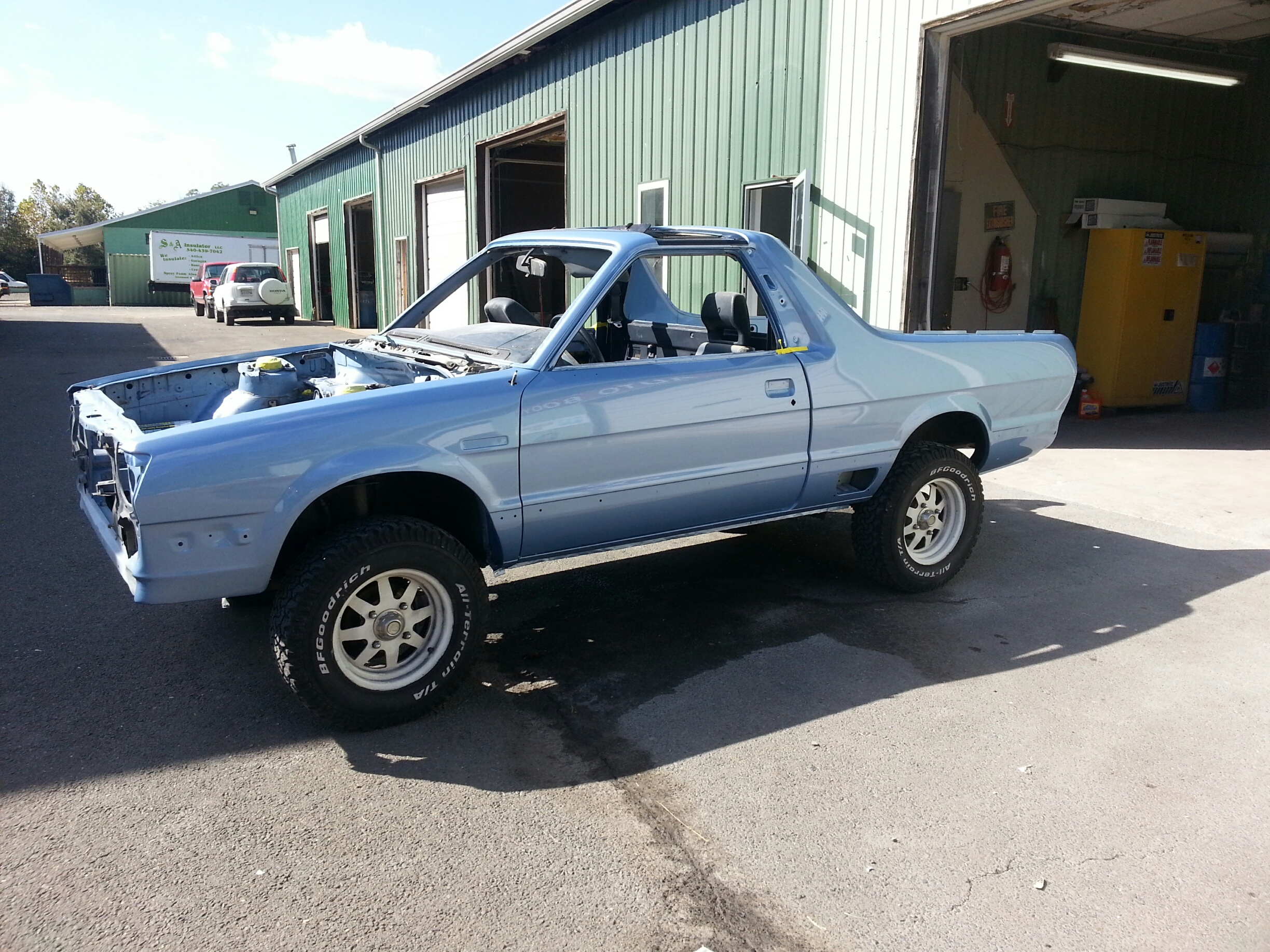

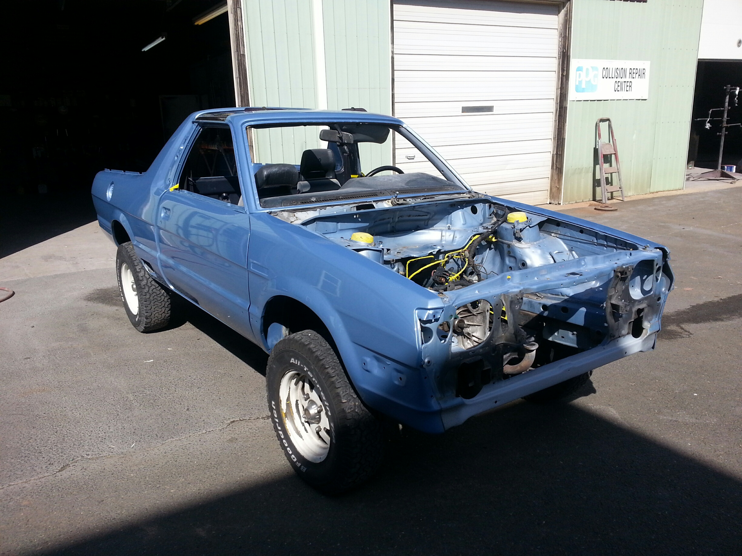

Visited the body shop today and they have made progress, the work is first class and it looks better than showroom!

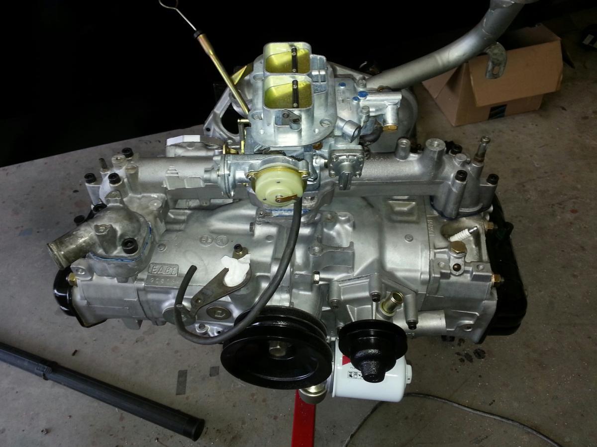

While the truck was at the body shop I built a new engine for it:
30 off the heads and port/polish
EA82 SPFI pistons
Delta torque grind cam
EA82 intake manifold
Weber carb
New valves / rod + main bearings
Emissions delete / EGR / aux air etc.
Felpro permatorque head gaskets / OEM gaskets elsewhere
New distributor / wires / plugs
New alternator
New fasteners
New water pump / thermostat
Repaint the tin
Will do a header

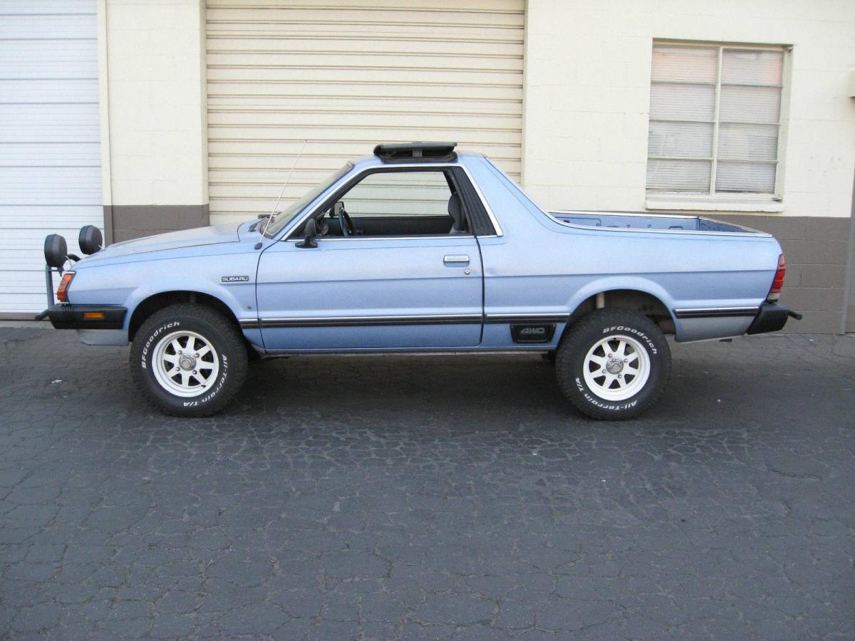

What it looked like when I bought it a year ago, it was a CA car that was garage kept and 99% rust free. The fenders go cleaned up, the lines improved where they were modified for tire clearance. All dents taken out, and epoxy primed over the bare metal.

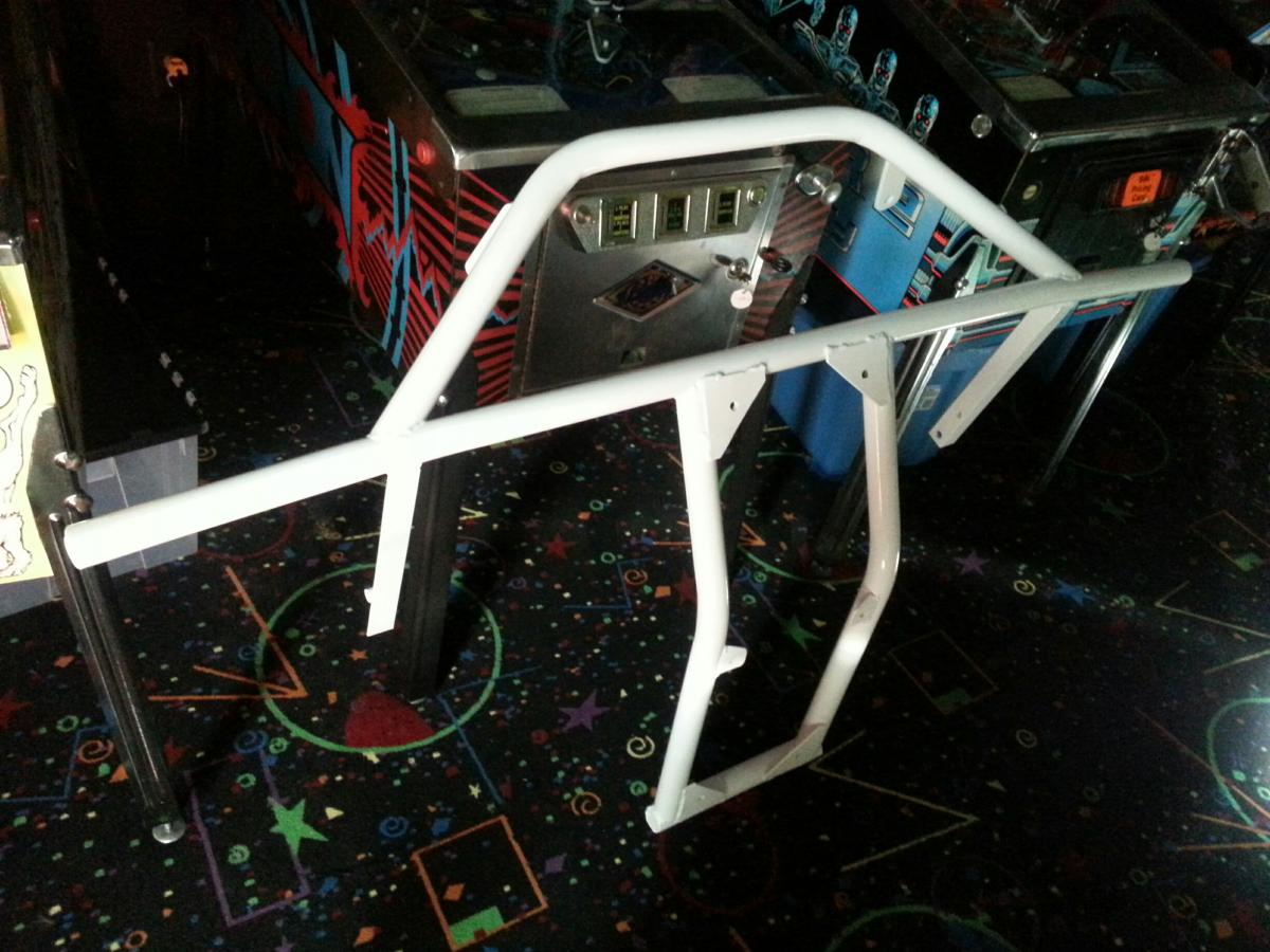

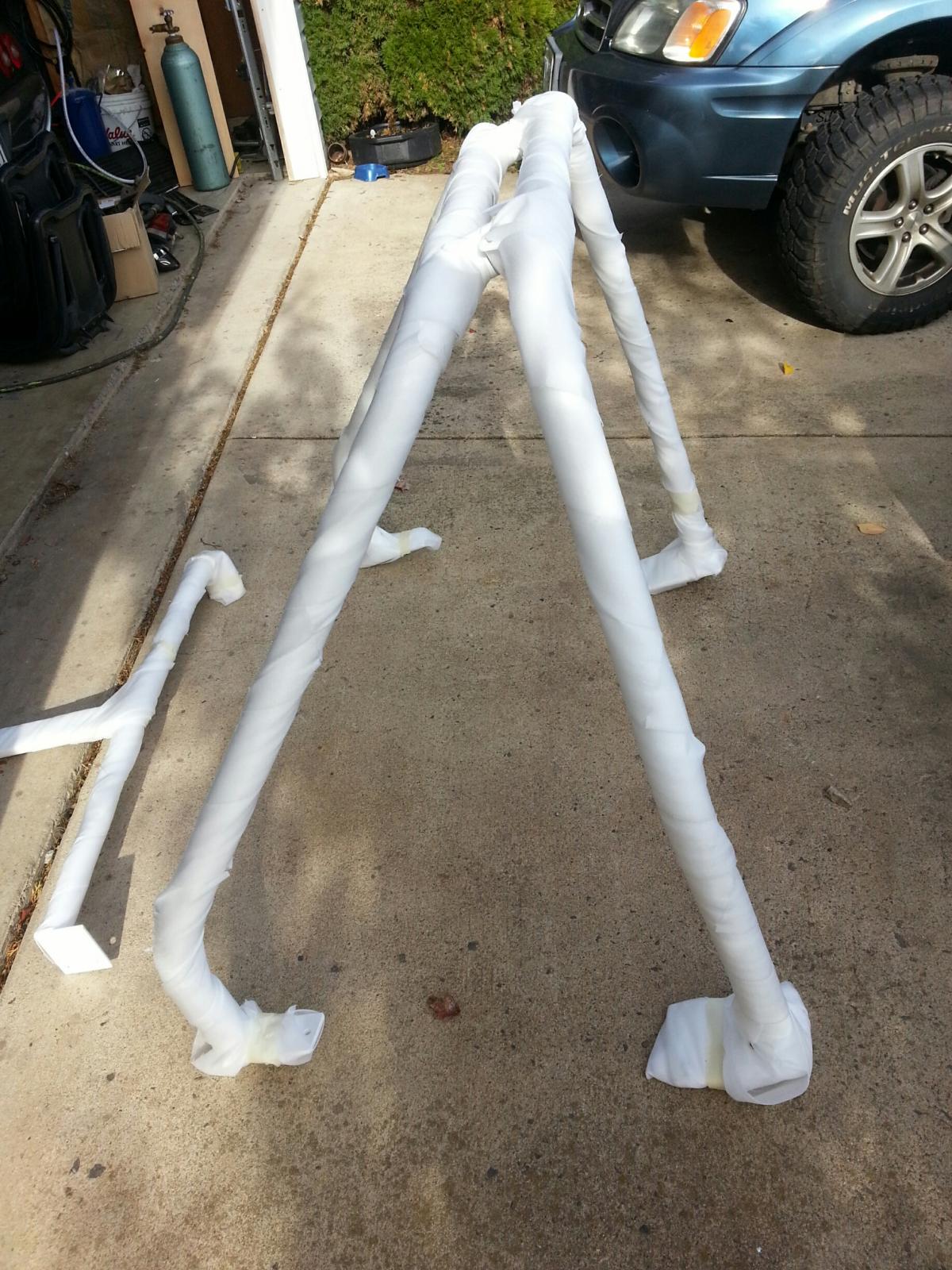

The truck had some really nice custom bumpers and a small lift done so I kept those and had them powder coated white, I also have the tall roll bar and had it done as well.

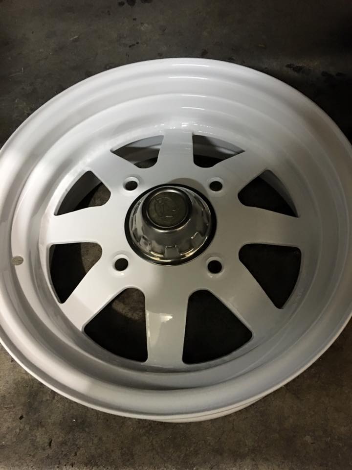

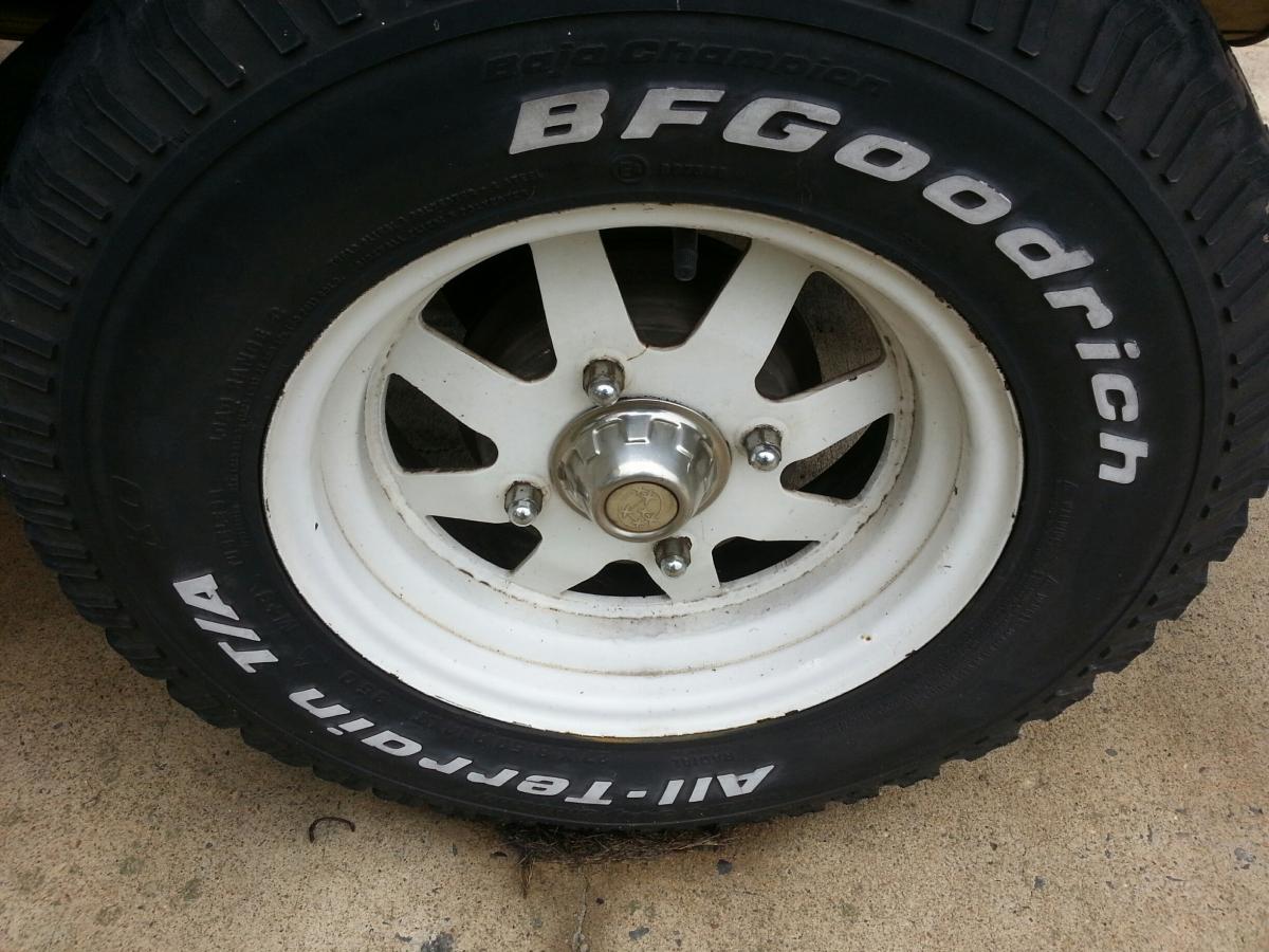

The wheels are really interesting, they are copies of the stock wheels but done in 14in size, they were made in the 80's by Taylor Made Wheels in CA. I have never seen another set like them. As soon as the truck is back home they are going out for powdercoating.

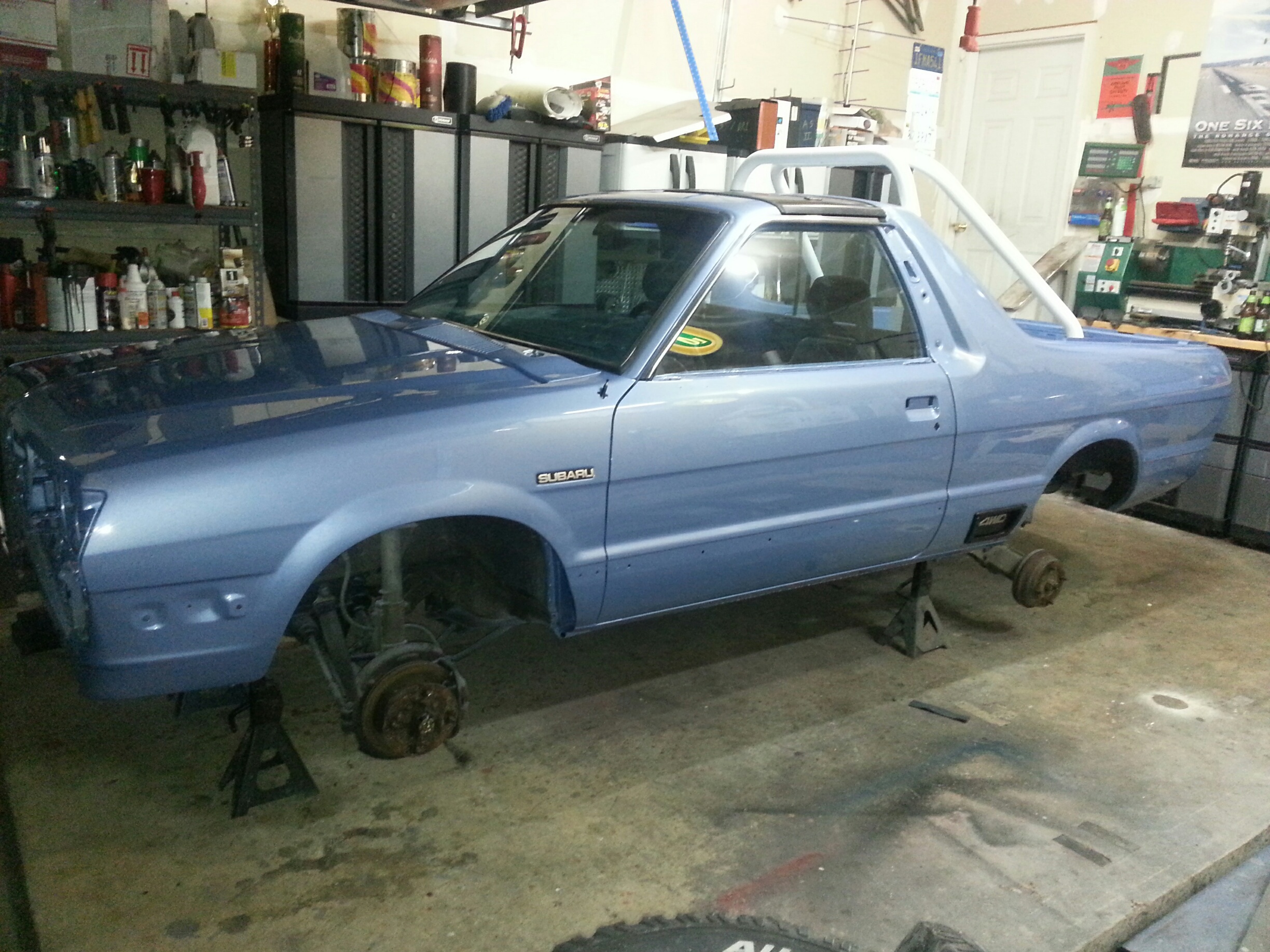

Got the truck delivered on Friday and started putting it back together today. It has a few weeks to go before it is ready.

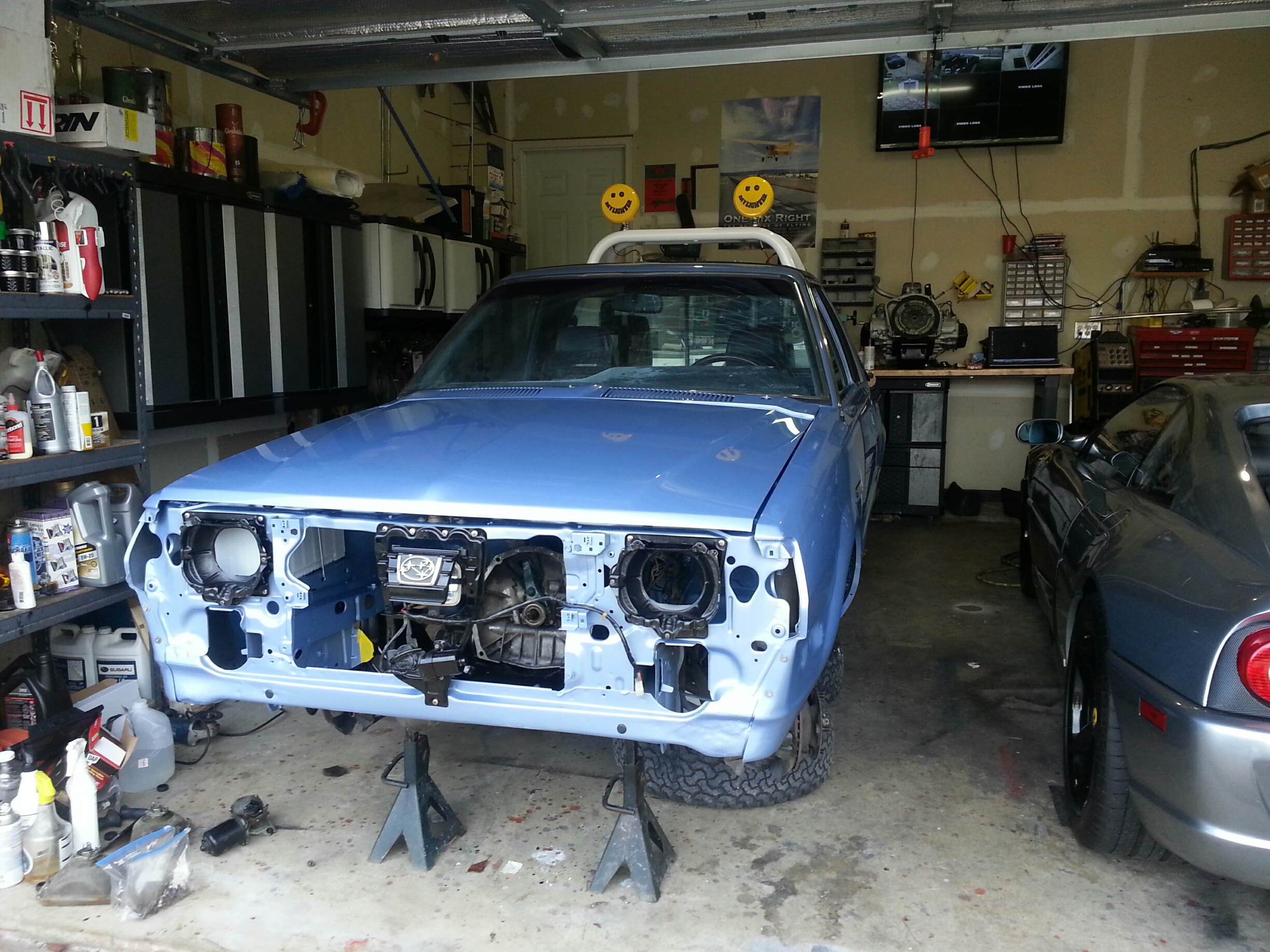

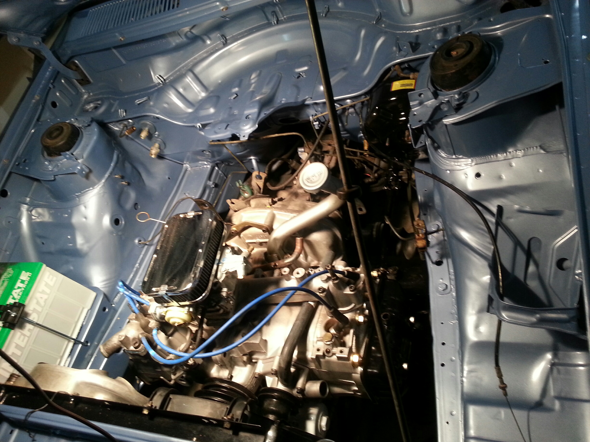

Engine bay ready!
Acro2pilot
Posts: 227
Re: 82 Brat paint overhaul
Post by Acro2pilot »
More progress!
KCs on!
Engine going in.
Engine in!

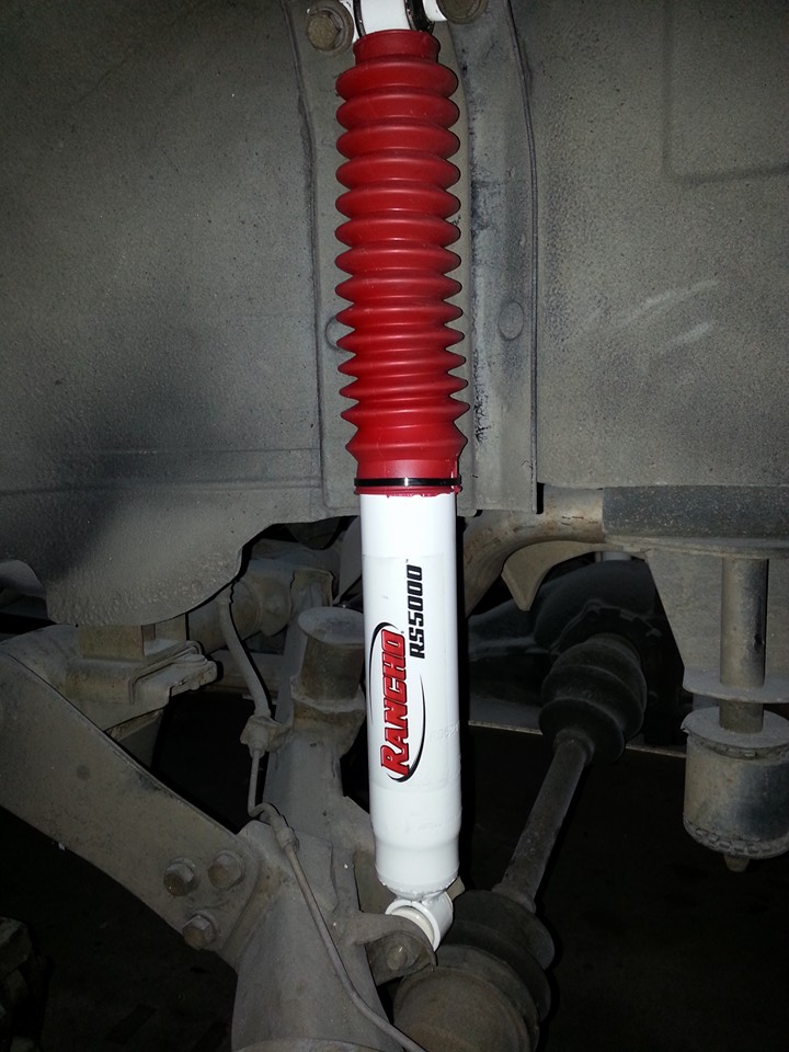

Installed the Ranchos today, way better shocks available today but sticking to the stock plus 10% upgrades that could have been done in the mid 80s.

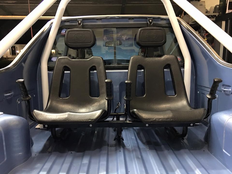

Acro2pilot
Posts: 227
Got the wheels and bed seat frames back from the powder coaters and installed the seats, the tires get re-mounted monday.
