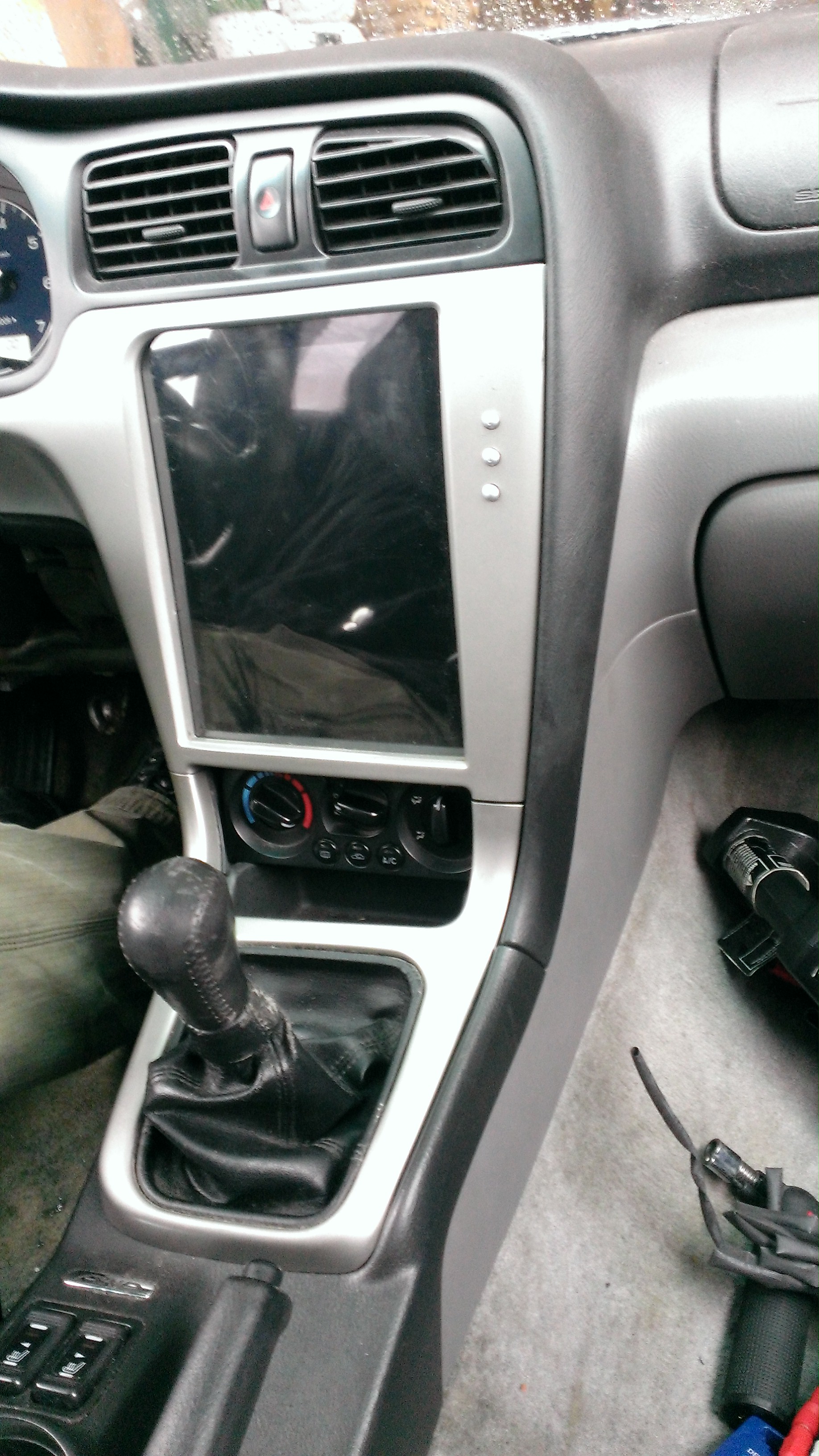

lol yeah, I've got a few things I want to do when I get a bit of disposable cash. At the moment, I've got a 640W 4-channel amp under the passenger seat for the primary speakers. Where would you mount the amps if the sub is under the seat? One person mentioned placing a low-profile sub in the corner (front, side of the center console) of the passenger footwell. It's something he did for some of the show-class Porsches he worked on, and it looks like there might be enough space for a low-profile 6" or 8" sub without affecting legroom.

I had it left over from when I had my minivan, along with the JVC head unit. It was part of my project to install a tablet using as many spare/salvaged parts as possible. I think the only thing I bought were fuses; everything else I found around the house/garage.

IT'S A TESLA!!!!!!! A tesbaru!
