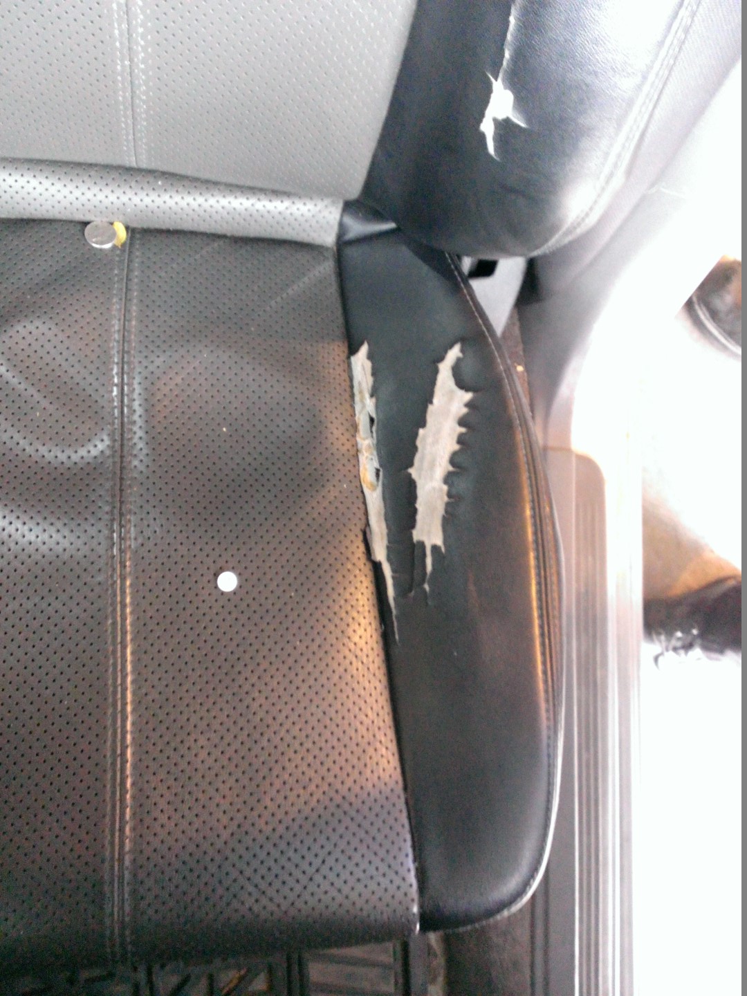

Another option, depending on the price, could be getting any cracked panels replaced and the inside foam supports bolstered. Got mine done for around $300. Not sure how much replacement seats are...
- WP_20150703_003.jpg (443.91 KiB) Viewed 10963 times
- WP_20150609_003.jpg (367.58 KiB) Viewed 10963 times

Those look GREAT! Thanks for the suggestion i will look into that. I can buy both front seats (heated and power) for $70. i figured if I could get these to work without having to put in a whole new circuit I would like that especially in our cold michigan winters.

My Baja has the same leather interior as in the pictures above. The guy I bought it from advised a new driver's seat had been installed and I'm seeing the same indentations on it after I get out of the car as the ones in the seat pictured above. I thought maybe there was something wrong, but I'm guessing it's normal after seeing those pix.
I'd really like to outfit it with heated seats since I'm spoiled by the ones in my other car, so am checking the threads here to see how involved it would be.
