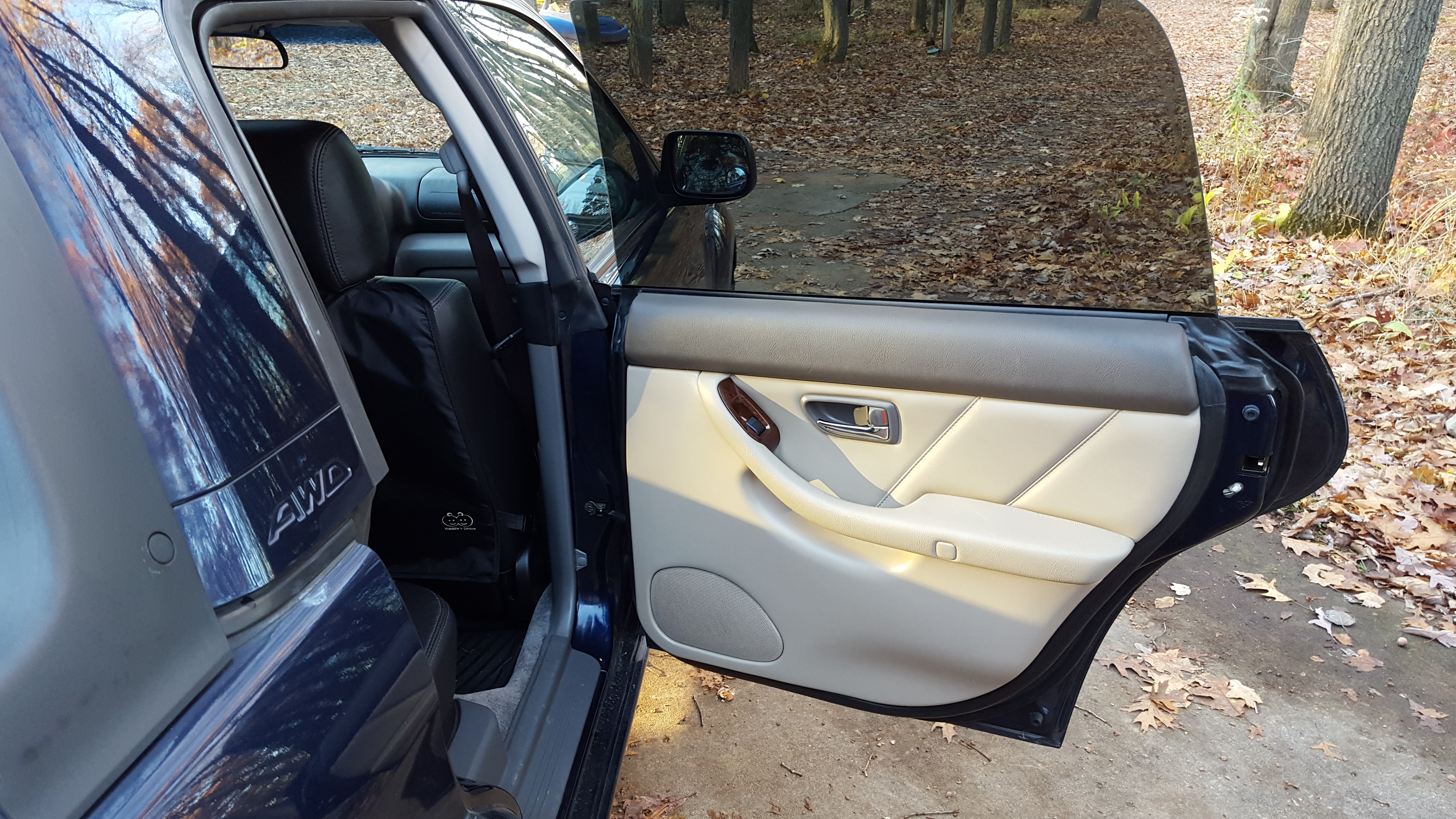

I couldn't wait to see how the lighter color would look, so I swapped out the rear door panel to get things started. Here are some pictures.

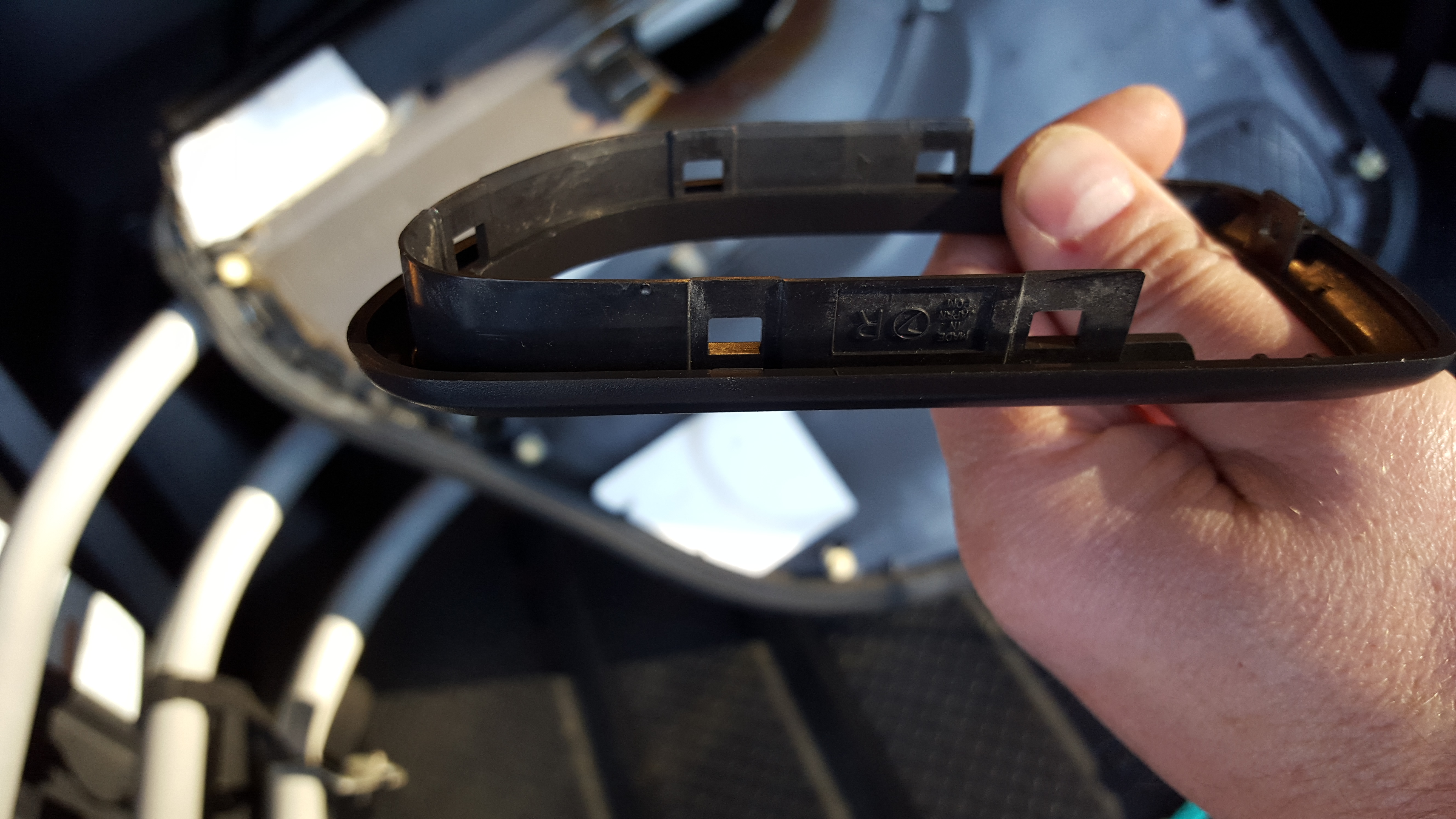

The trim ring around the door lock and unlatch assembly.

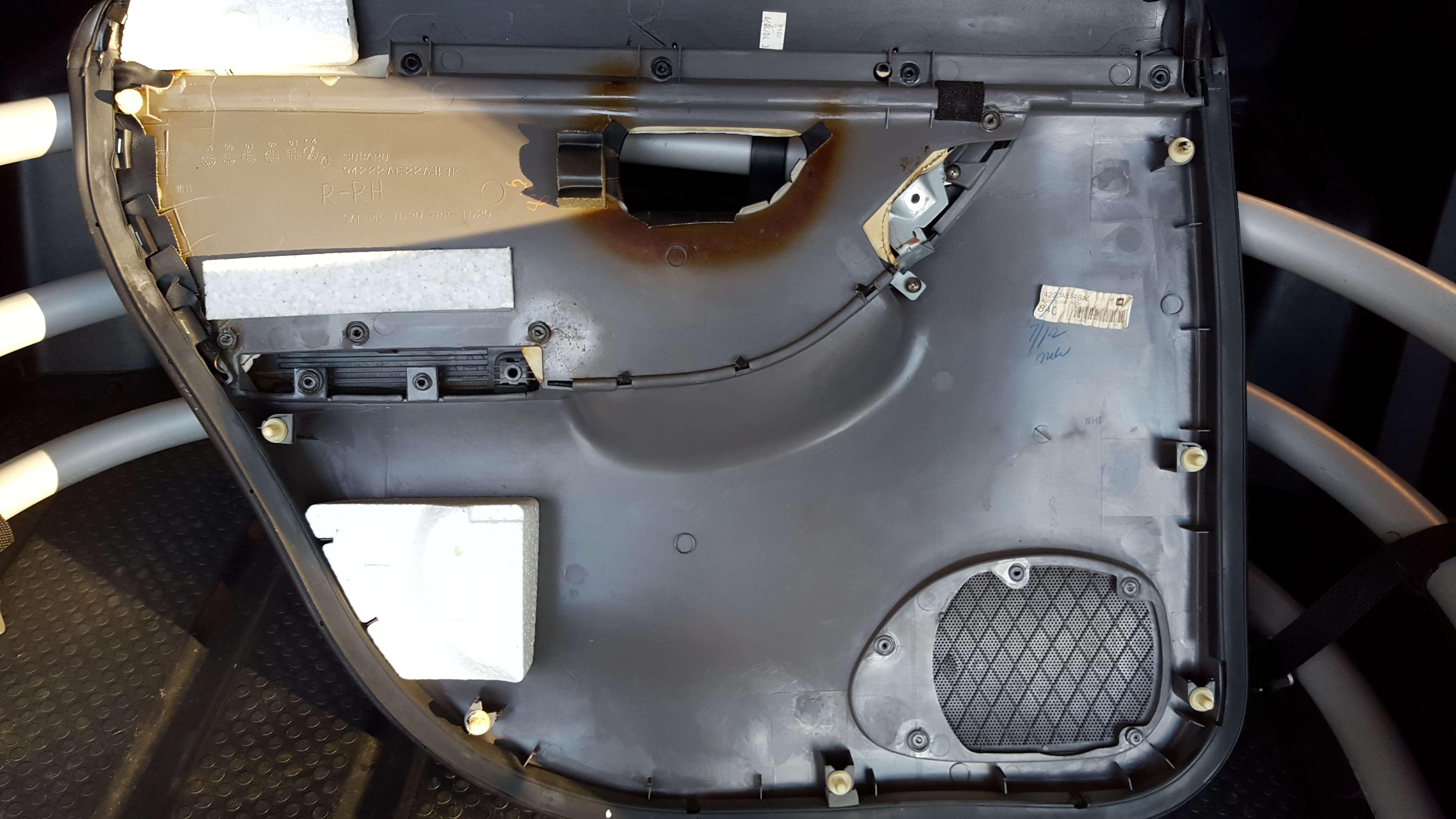

Back side where you can see the plastic pins that push/pull out of the door.
Legacy panel installed on the Baja.

ohh classy! I love a black interior with some color pop but this really does make it look much more..... sophisticated.

I agree! It does give it a pretty different feel, especially with the wood trim accent. I didn't know the rear doors were the same as the Legacy; can all of the interior trim pieces be swapped?

Near as I can tell yes. The trim just behind the rear seats, where the rear seat belts are, looks to be unique to the Baja. I am not yet sure about the headliner, but because they both have a moon/sun roof, I am hoping they are interchangeable. I wanted to paint the woodish finish with exterior body color, but I will wait and see if I like the wood look first.
