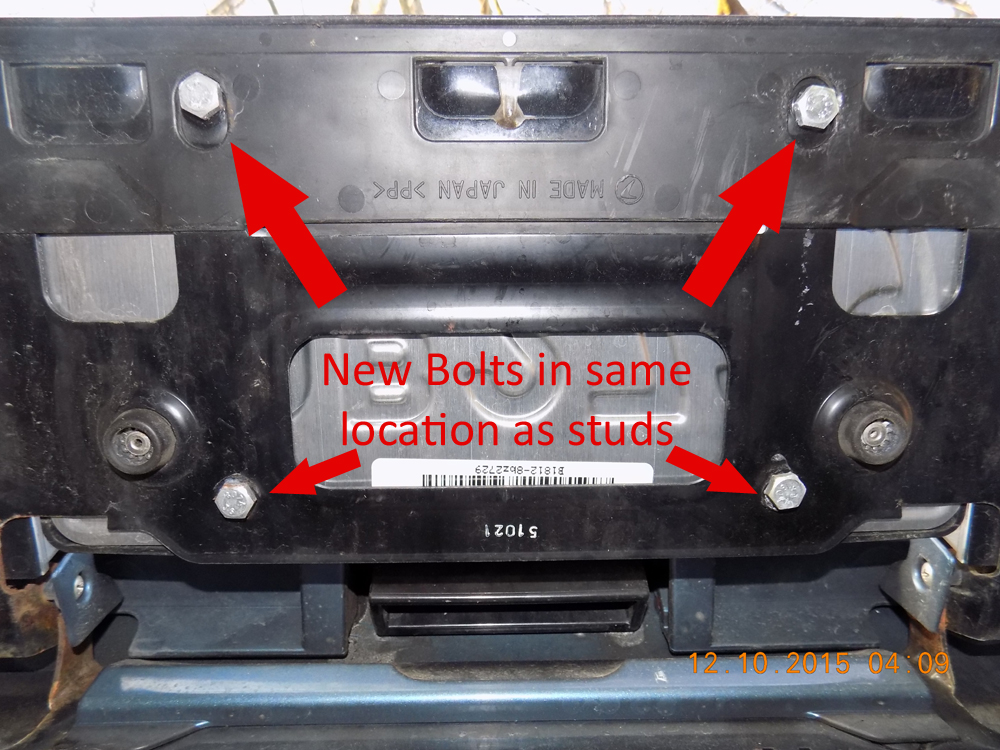

Cut the bolts off the rear bracket up to the plate so they're somewhat flush. Then open the tag bracket so it's facing up, & put a brace below it like a piece of hard wood wedged between the back of the bracket & the bumper. Then get a power drill & drill new holes using the previous studs as your drilling areas (it may be easier to drill from the bottom, but you'll need someone to push down on the bracket & don't drill through their hands!). Make sure to oil (like 3-in-one) your drill bit so it doesn't overheat & every so often drip some oil on the place you're drilling. Then get yourself some galvanized or stainless steel bolts & nuts & plop them through. Just make sure the bolts you use aren't over 1in long, otherwise the bolts will hit the top of the bumper when you open the tailgate.
Re: 2003 baja tag mount
Pics of the new bolts:
