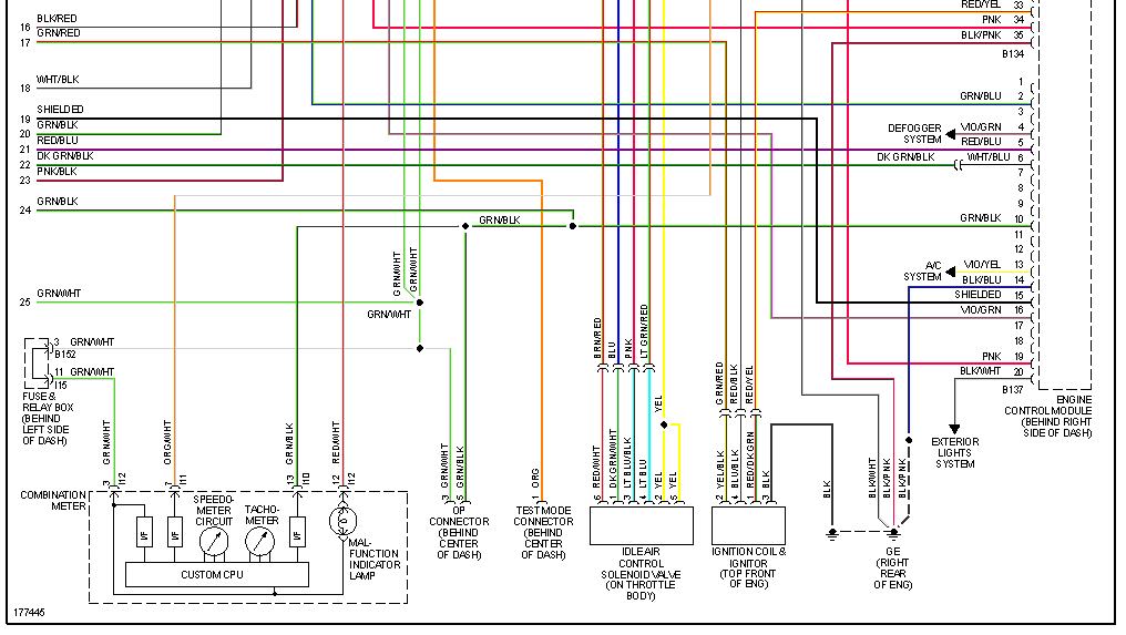

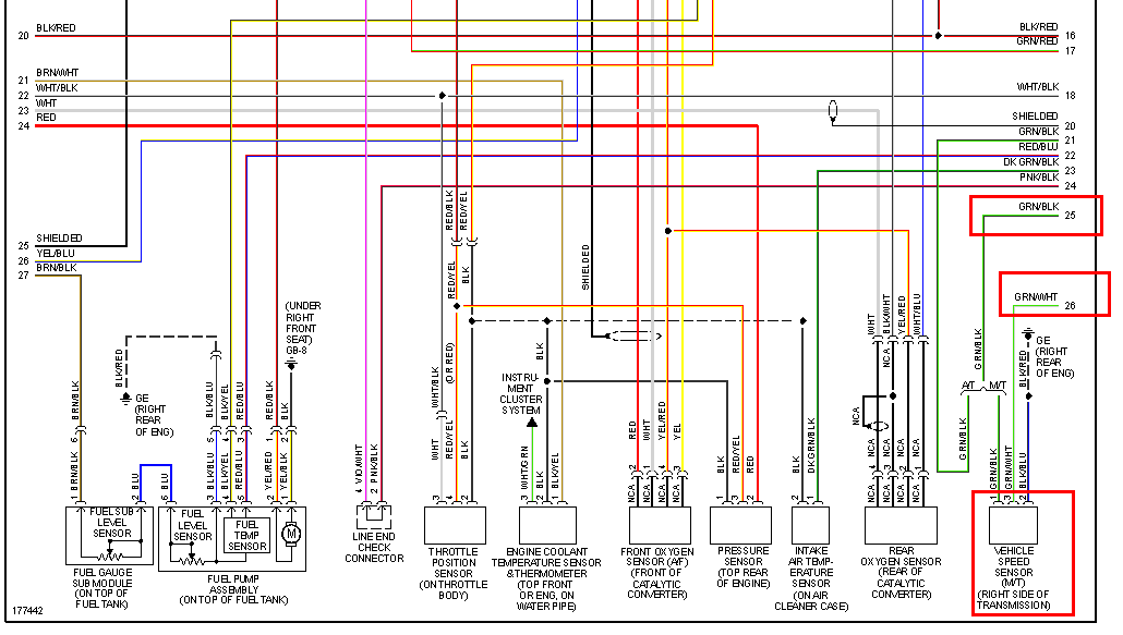

I did a 5 speed swap in my 03 Baja NA and don't know how to wire in the speedometer? I have a 3 pin speed sensor in the 5 speed but don't know where the wires go to? Any suggestions?

I found these diagrams... not sure if they'll help at all.

I think you may have solved my issue. I'll check back when I test it.
