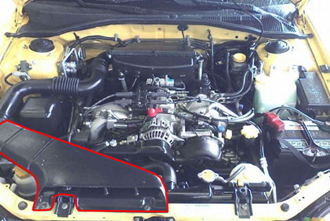

Also, did you remove the air intake nozzle or is it missing (part outlined in red below)?
I noticed your power steering fluid tank is not hiding under it in your picture. :lol:

Just chasing a mystery power steering belt squeal...checked the PCV valve to make sure its working, so I had pulled that piece off temporarily.
