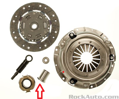

I've also been reading that I'll likely need a quill/bearing retainer/extension housing repair kit, which is basically a sleeve and oversized bearing.
Some kits seem to come with it (http://www.rockauto.com/en/moreinfo.php ... 32&jsn=356), and others don't. Since it appears the Exedy clutch above doesn't come with it, I need to buy one separately... where can I get that from? I found this: http://www.pdmusa.com/OrderStorm-ecomme ... 983B26F09D but the MSRP is $160! The AMS clutch kit from Rockauto includes the bearing and sleeve, and it's $177 for the whole kit. There are some parts listed as Extension Housing Repair Sleeves, but they don't include the bearing, and the pictures/descriptions don't look like the same part... This must be a relatively common part, so I'd think it'll be available somewhere for a reasonable price.

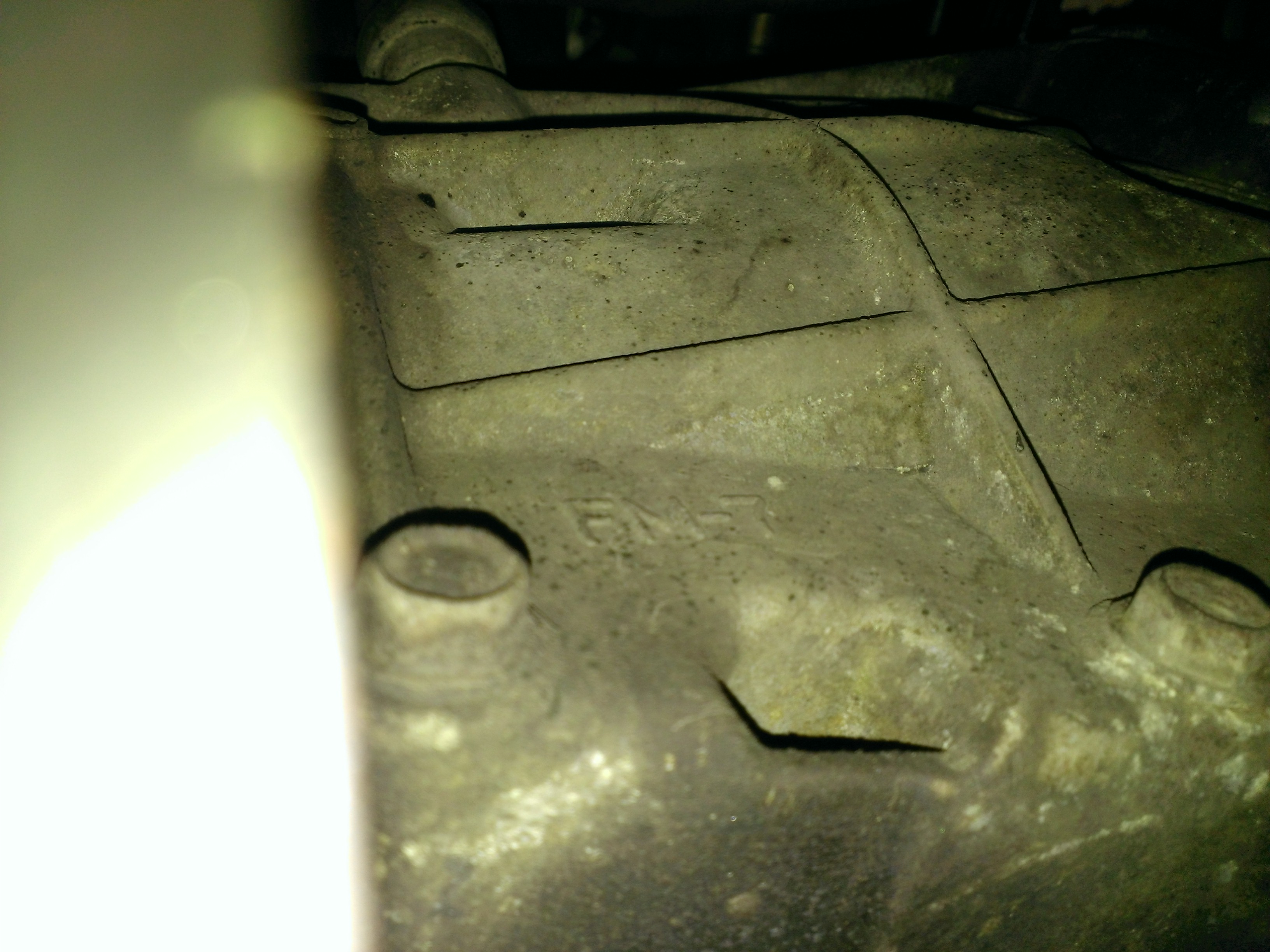

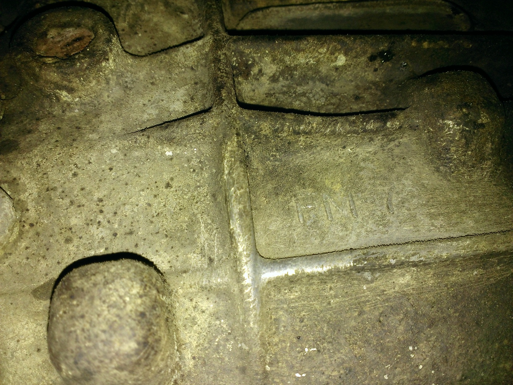

Also, where can we find the transmission code, besides on the engine bay plate? The transmission in mine was replaced with a compatible, but not exactly identical, unit and I can't find the code for it. The only text I can see on the sides/bottom are "FM-7" and "JAPAN".
