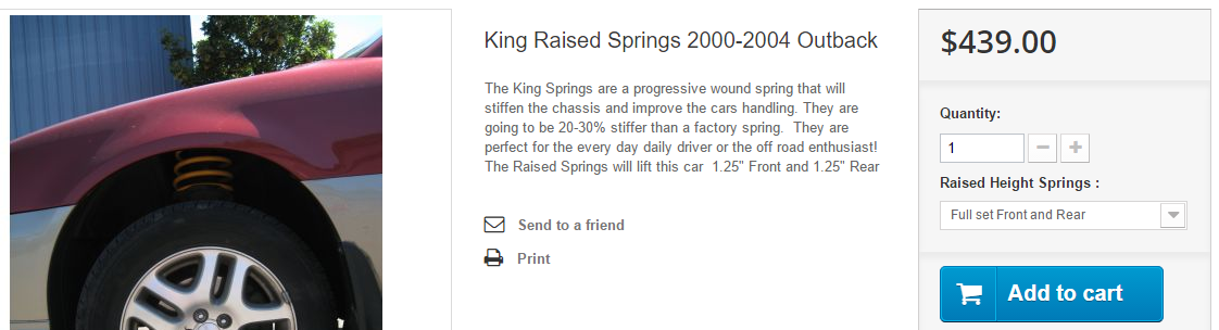

These are the only springs I could find on Primitive's site compatible with the 2003 Baja: http://get-primitive.com/suspension-lif ... ester.html So the KYB Excel GR2s with King Springs seem to be the most recommended? Have you heard anything about anti-roll bars?

Any update on this folks? My stock height NA 2004 is begging for some new suspension, and I would love to find out if the King Springs above for the Outback fit with the Baja! And if someone already has them, how do they like them?

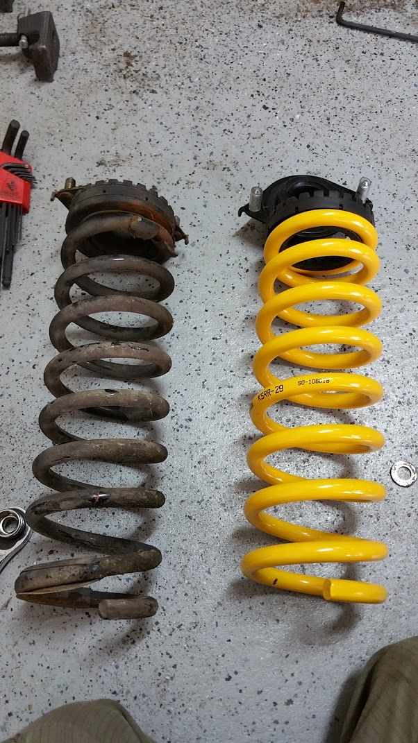

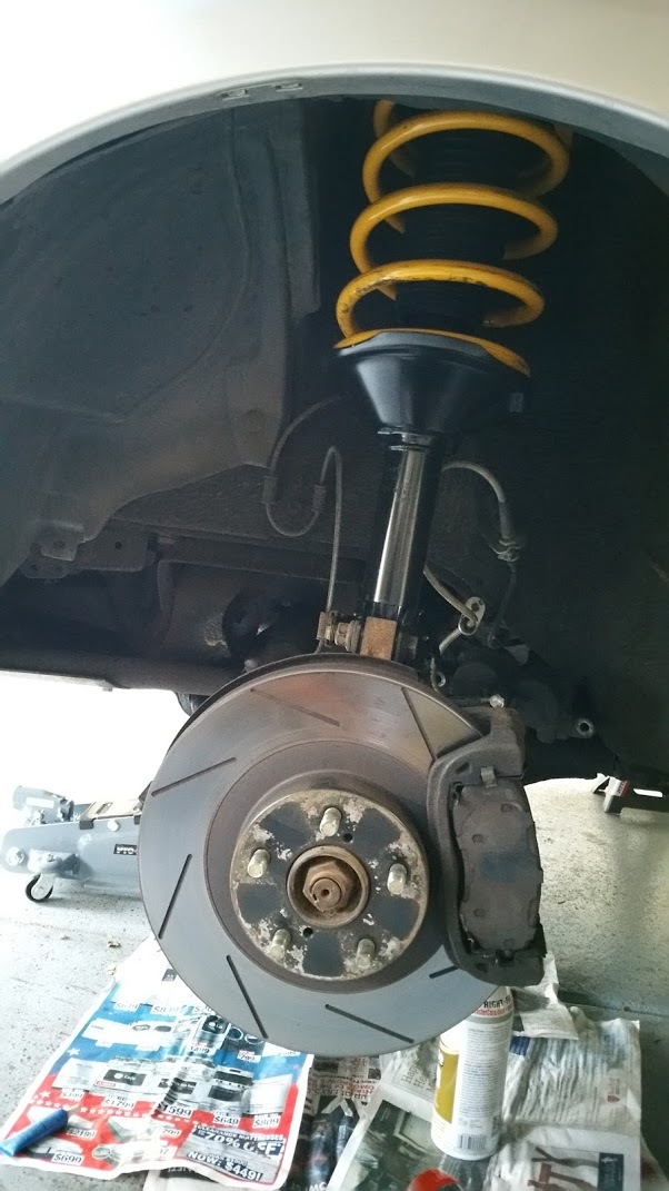

I just went for it... got the KYB ExcelG shocks and the King Springs I linked earlier, along with new top mounts. I'm liking them so far, but I don't really have a benchmark to compare them. I replaced the shocks and springs at the same time, so I don't know which changes are caused by each part. Plus, the parts they replaced were likely 13 years old, and the rear shocks were so worn there was near-zero resistance when leaning on them. Overall, the ride is firmer and it feels like it leans less in the turns. I haven't done any spirited driving yet, and won't be until I get the transmission issue sorted out.
Oh, anyone in California and wants to help me change the clutch and flywheel? Offering food and all-you-can-drink beer for the day...

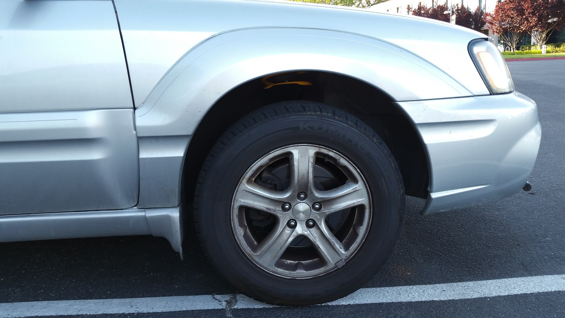

Took some photos right after they were installed... they have settled a bit since then.
Photos of the front:
- 20160327_153118.jpg (248.9 KiB) Viewed 87710 times
- 20160326_183842.jpg (116.33 KiB) Viewed 87710 times
- 20160326_140545.jpg (215.68 KiB) Viewed 87710 times

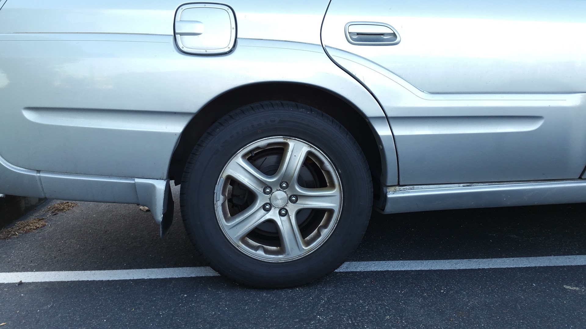

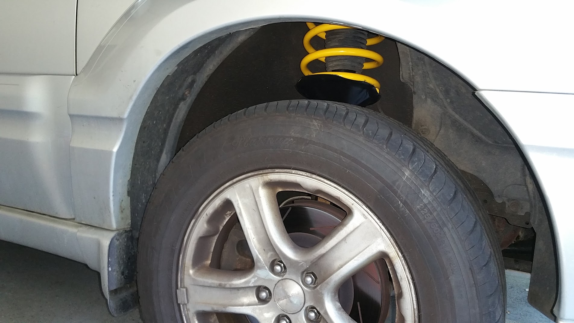

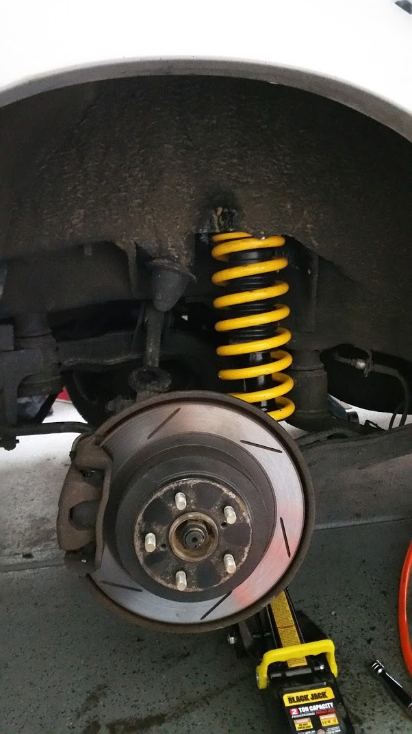

Rears:
- 20160320_184123.jpg (190.61 KiB) Viewed 87709 times
- 20160320_175252.jpg (114.76 KiB) Viewed 87709 times
- 20160320_164331.jpg (217.13 KiB) Viewed 87709 times

And for reference, these are the parts I got:
KYB GR-2 Gas 334448 http://www.amazon.com/KYB-334448-Suspen ... B007LXPF22
KYB GR-2 Gas 334447 http://www.amazon.com/KYB-334447-Suspen ... B006ZN44XA
2x KYB GR-2 Gas 341276 http://www.amazon.com/KYB-GR-2-341276-S ... B0071B7EQY
2x KYB SM5214 Strut Mount (Rear) http://www.amazon.com/KYB-SM5214-Strut- ... B000HDD87W
2x Mevotech MP902924 Strut Mount (Front) http://www.amazon.com/Mevotech-MP902924 ... B007I5O56K
King Springs KSFR-26 KSRR-29 http://get-primitive.com/suspension-lif ... ester.html

I know I have slightly oversize tires but my Baja only has maybe an inch gap in front and 3/4" in back.correction: 1.5-2" both. guess I never really looked that close but it's a LOT less than your after pics.

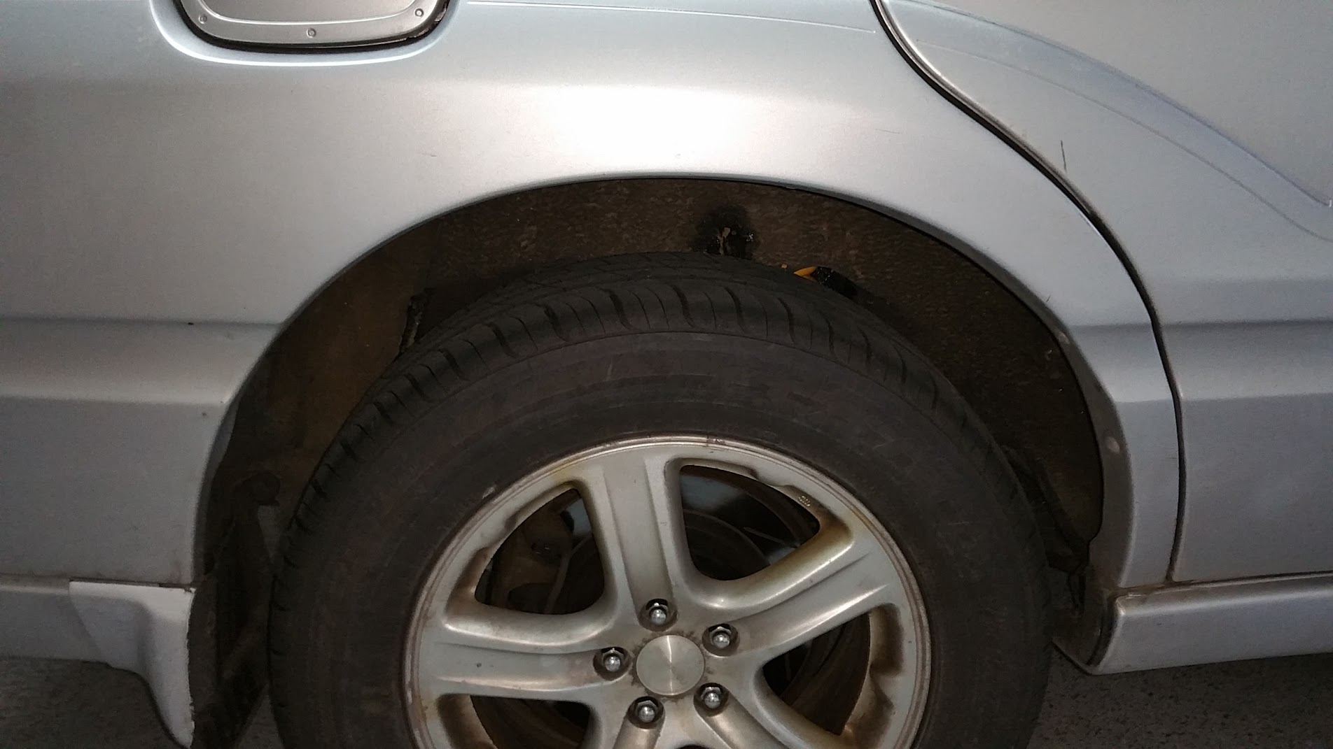

I'm not sure how much I started with... besides, they were 13-year-old shocks and springs that have taken quite a bit of abuse over the years, so I don't think they'd be representative of the average Baja. I can take some pics after a bit of driving, and measure the gap with a caliper. How long does it usually take for springs to completely settle? My tires are standard size: 225/60/16. In time I'd like to upgrade to 17" rims, but other things have a higher priority, especially since I don't need winter tires here.kamesama980 wrote:Wow thassa lotta wheel gap! How much did you have to start with? I don't suppose you could post before and week or 2 after pics?
Here are some photos with the stock springs... not sure what you can tell from these angles, though.
- WP_20150718_054.jpg (330.79 KiB) Viewed 87651 times
- IMG_6237a.jpg (349.13 KiB) Viewed 87651 times
- 20151206_154233.jpg (358.15 KiB) Viewed 87651 times

And here are some photos taken after having driven it a bit (well over 1000km):
- 20160404_184124.jpg (315.92 KiB) Viewed 87611 times
- 20160404_184113.jpg (320.79 KiB) Viewed 87611 times
