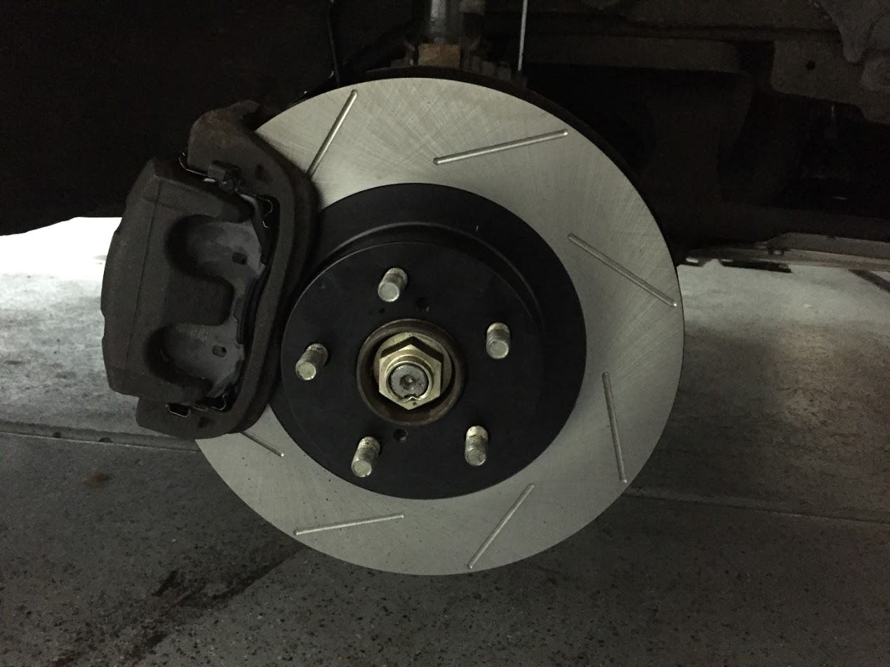

I just got these for mine:Guacamole wrote:...Anyone have any suggestions for good baja-compatible brakes that are relatively cheap (like under $50-per part cheap), or should I just go with OEM to avoid any potential fuss?
Rear: http://www.amazon.com/Power-Slot-126-47 ... B000EQ2026
Rear: http://www.amazon.com/Power-Slot-126-47 ... B000EQ202G
Front: http://www.amazon.com/Power-Slot-126-47 ... B000EPZY5C
Front: http://www.amazon.com/Power-Slot-126-47 ... B000EPX50S
Fits perfectly, and seems to be alright so far. I don't have anything to really compare them to, because the rotors they replaced were....

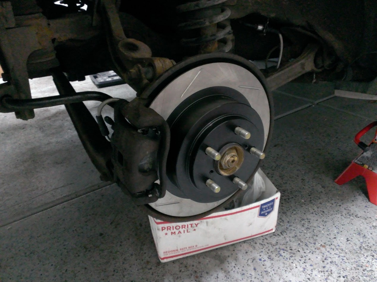

Re: Brakes
These are what the rotors look like mounted.
- WP_20150730_006.jpg (171.67 KiB) Viewed 16631 times
- IMG_0603.JPG (142.58 KiB) Viewed 16631 times
