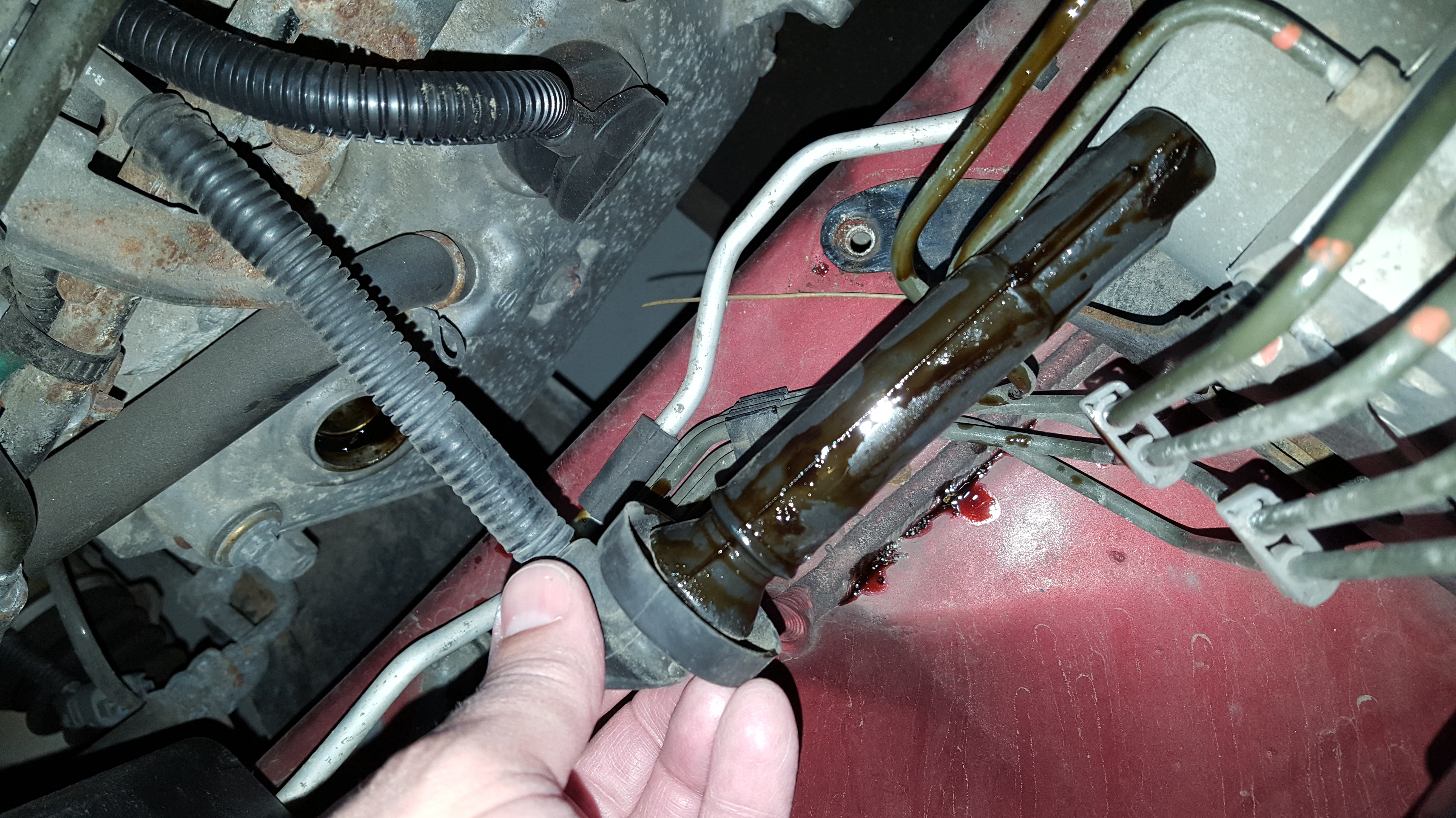

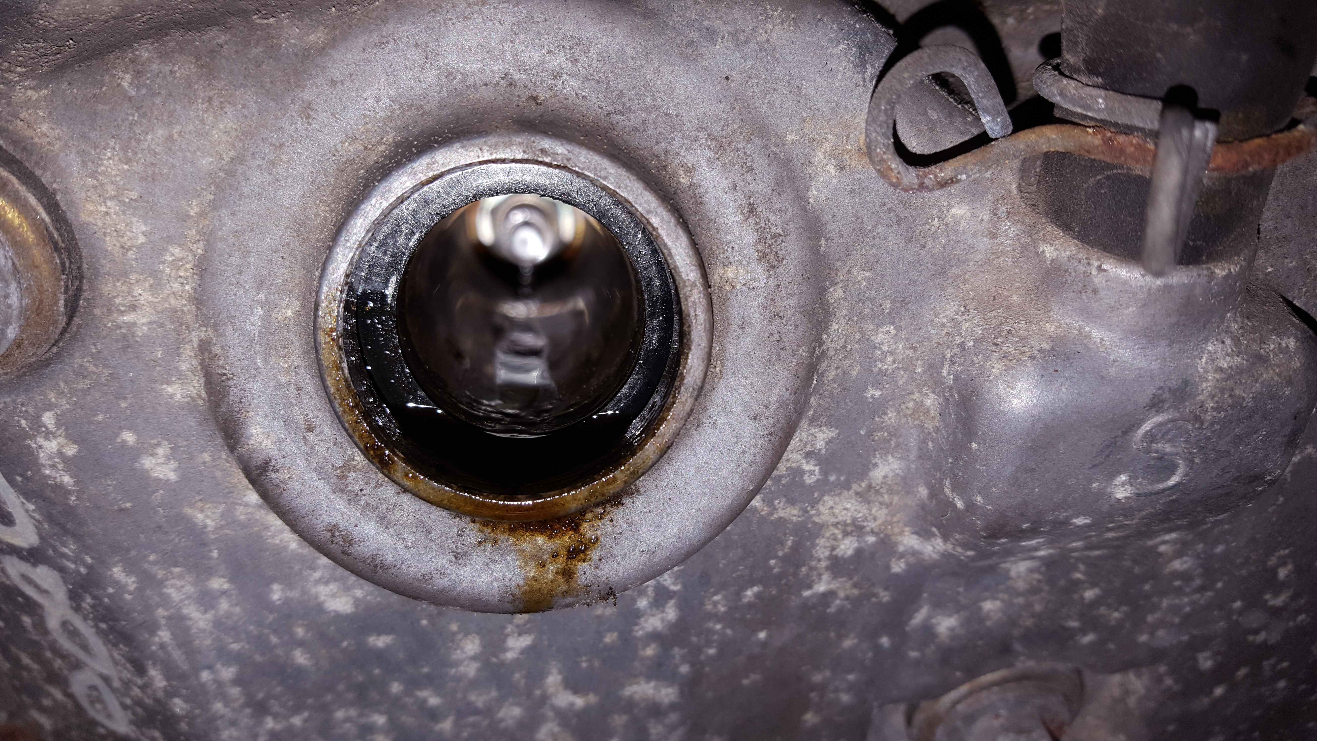

Root cause ended up being my oil soaked plug wires...they were also corroded terribly where they connected to the coil pack, and my tube seals are in need of replacement (and then valve cover gaskets as well).
I've already spent the money on a replacement coil pack so I'm going to just keep the stock one as a good spare for now.
