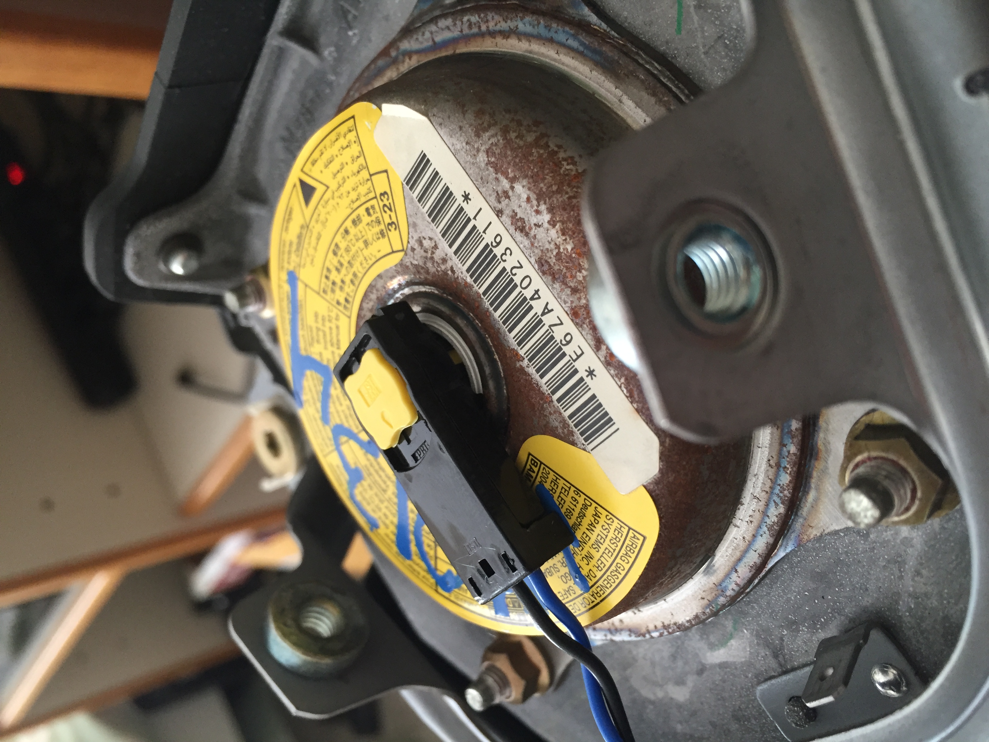

I've hit a snag unfortunately with the plugs on the airbag. Apparently, my 2005 Baja doesn't have the same airbag plug as the 00-04 Outbacks, 04 STI, or 06 Impreza. I got my charge from an 05 Impreza (single stage).
This is the factory airbag connector for the Baja charge.

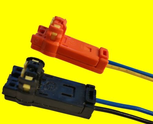

The plan is to grab a clockspring connector/airbag plug from eBay, and change my plug so that it will attach to the new charge.
Proposed new connector for the Momo/Impreza airbag charge. l'll just be using the black one.
Clockspring Connector.jpg (19.82 KiB) Viewed 14370 times
I've got a few days of waiting for parts so feel free to shoot some holes in my plan with knowledge. I already know the risks of messing with plugs for airbags, and I'm accepting the risk. That part aside: Sounds like it should work, right?

The new plug arrived today. It fits! Looks like I'll be moving forward with the swap tomorrow.

Once the steering wheel is removed you will need to replace the yellow stock airbag plug with the eBay plug. To do this just match up colors. The eBay plug has a blue wire and a black wire. The yellow plug has a yellow/black and a yellow/blue. Blue goes to yellow/blue, and black goes to yellow/black. It's best to solder these connections to reduce the bulkiness of the cord, but crimp connections also work.

Been looking for this info for so long man, hope it still has response from you. I want to change my old gen's 2000's steering wheel for a new gen's GDA Momo one.
May I ask the order of the wiring for the airbag connector? I need to do the same, and there's only 2 wires but still need to be sure before changing the conector and plug into the airbag.
Waiting for any help, thanks!
N2L wrote: Fri May 13, 2016 8:26 pm
