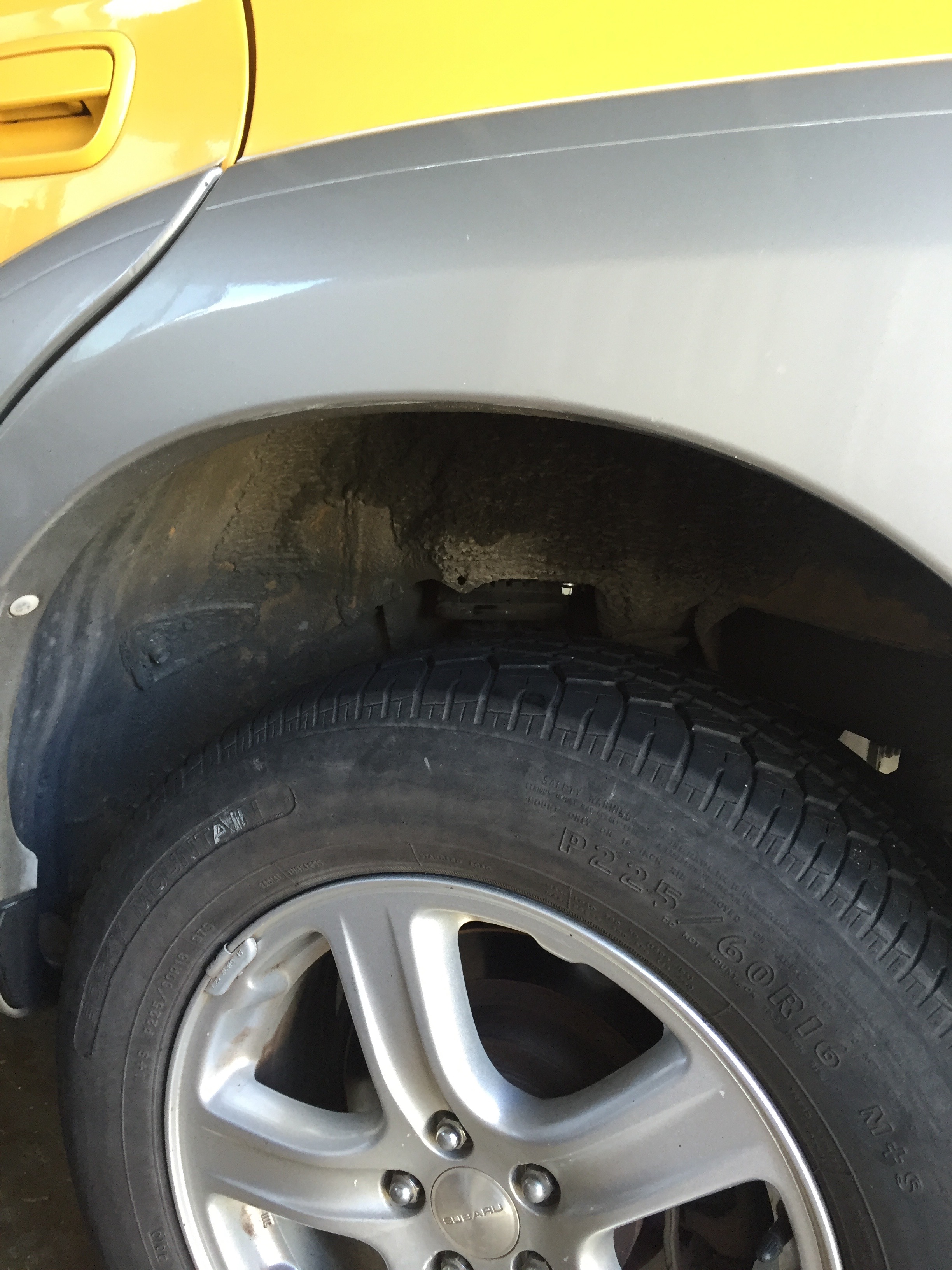

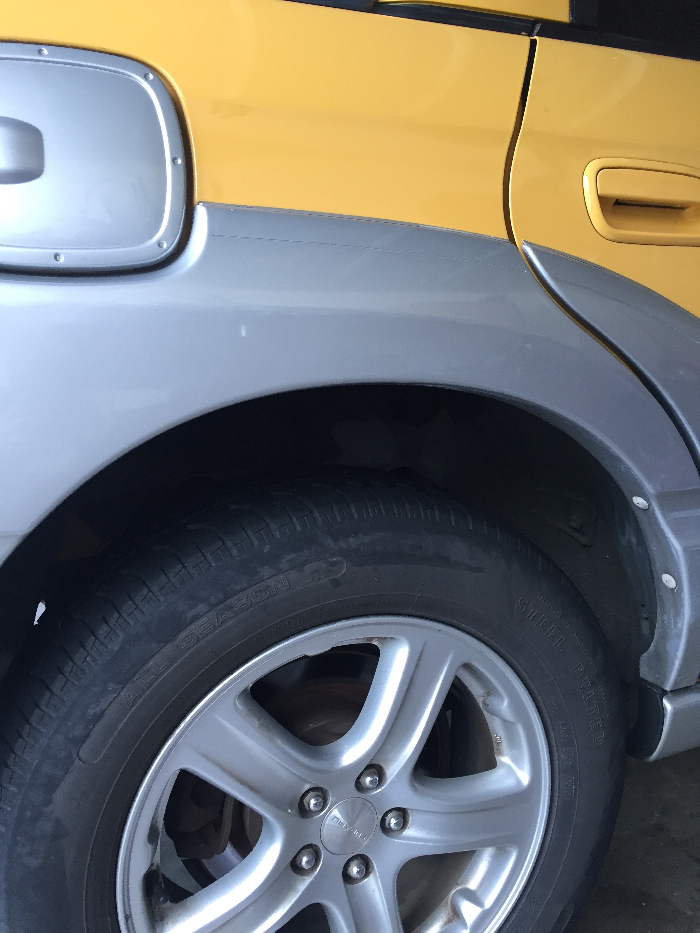

So I finally did the lift. I used the 1" spacers from subtle solutions and the springs from a 2005 Baja. It appears to be a 2" lift after everything is said and done. A couple of issues you may run into. The front seat bar did mount back on but I did order new end links for the front. I ordered ones from kartboy that fit the wrx sedan. The rear end was the biggest issue. The sway bar did not go back on so I ordered klc-144 endlinks made by whiteline. I will be putting those on next week and I'll let you know how that goes. I like the ride so far. I went and got the alignment done. Everything worked out good except for the rear toe. We had to loosen up some stuff to get the shock to fit in the rear. It was difficult. The rear springs are tough to deal with. The car drives fine and don't notice any shaking. The tech said the rear toe is only slightly off. I will look again at it when I put the endlinks on. I used Monroe shocks for a 2003 Baja as they had a $100 rebate. They worked fine. Again this is on a 2003 Baja.
In my opinion I think that going with new king springs for the 2" lift may be the easiest to do. The spacers work great but you will also need springs from a later year Baja. You can rent a spring compressor tool from autozone. If you have an impact driver it will make life a lot easier. Putting the lift on the back end was difficult because you have to get the spring and strut compress to line back up for the wheel. Trying to get that to happen and not have the whole car lift instead was a challenge.
After getting the lift done I love the Baja even more. It's fun to drive. Now I'm going to look into new tires. Another Baja owner that lifted his out 17x9 rims that have a 48 mm offset and he has no rubbing. I know I glossed over some stuff but feel free to ask questions.
