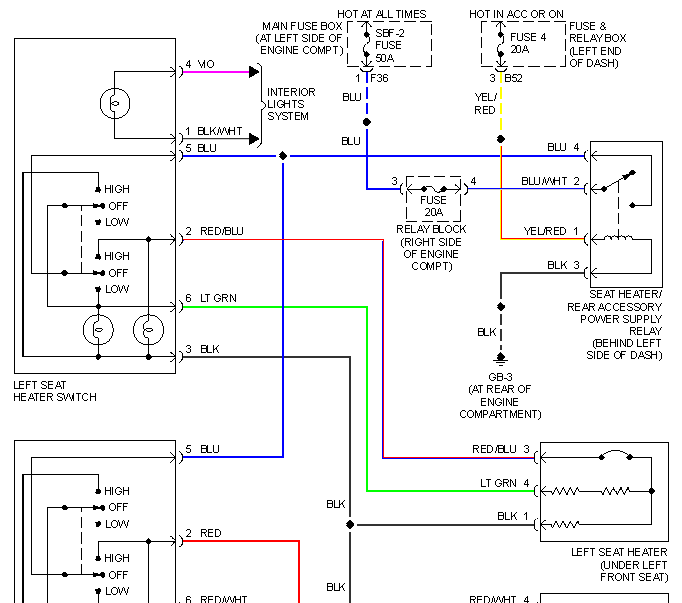

Although, if both seats aren't working, it's probably not the switches. There is a relay, but it's not controlled by the switches; if both seats aren't working, that could be the cause.
- heatedseat.PNG (28.81 KiB) Viewed 16957 times

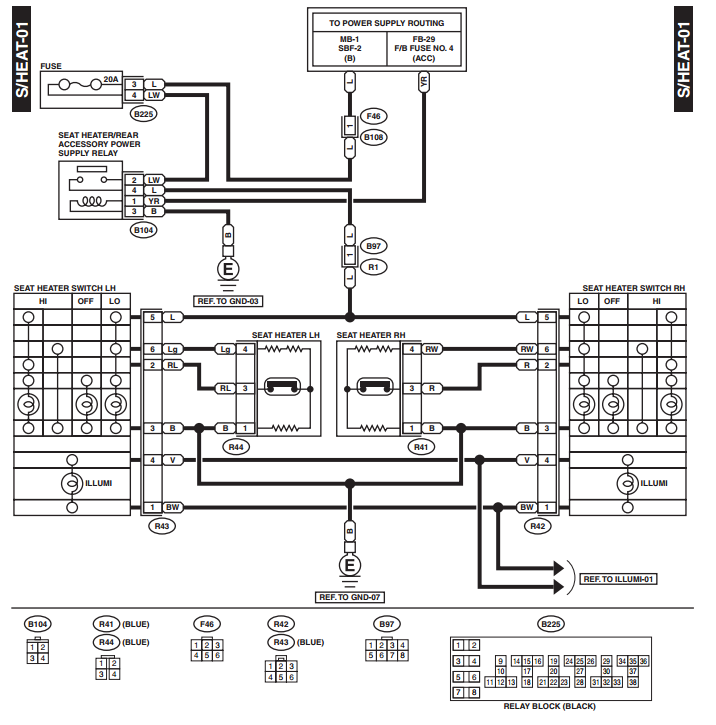

Also, the link in this thread: viewtopic.php?f=2&t=3059&p=17384&hilit= ... ats#p17386 has another diagram.
- heatedseat2.png (93.1 KiB) Viewed 16953 times
