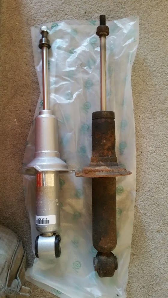

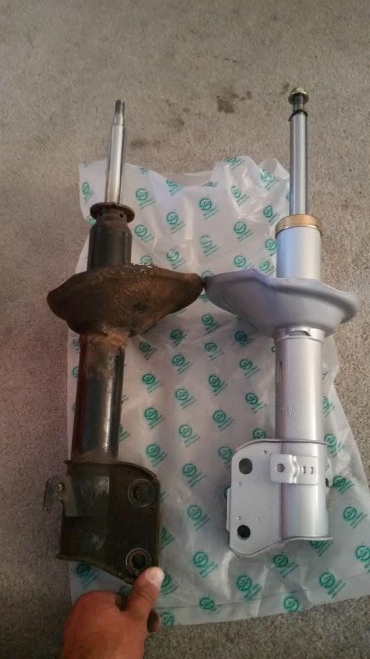

One option for lowering is to get Legacy GT shocks (e.g. https://www.amazon.com/gp/product/B00HS0H8P0). See photos comparing the Baja/Outback shocks to the Legacy GT shocks. Sorry, can't help with the exhaust.
