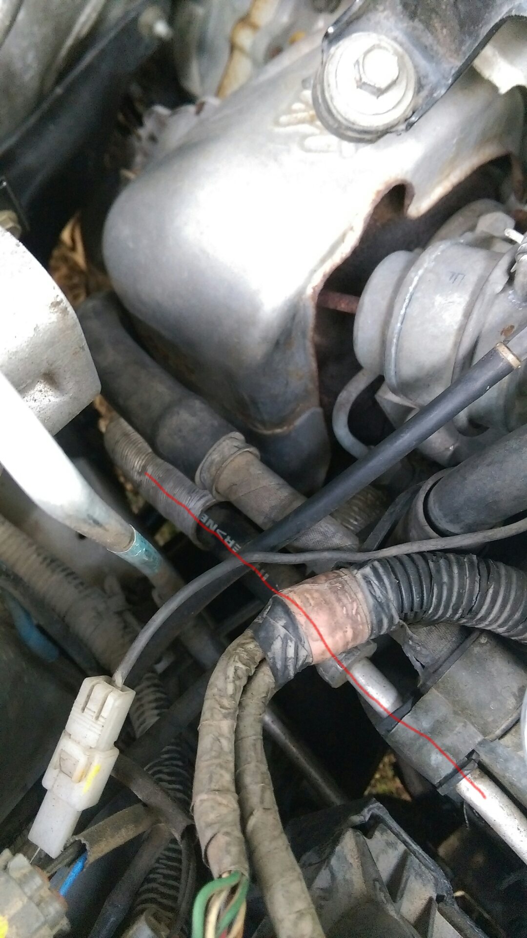

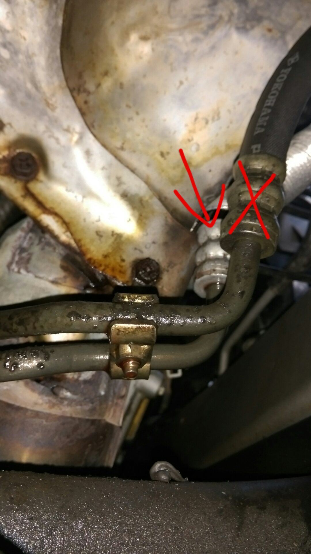

So, basically I've got a nasty power steering leak, I believe my pressure line. But I'm not sure of the replacement parts... I marked in red (as best as I could lol) where the leak is. Could someone identify/confirm and possiblypost a link to the correct line I need? Will I need to replace both lines? Thanks in advance everyone!

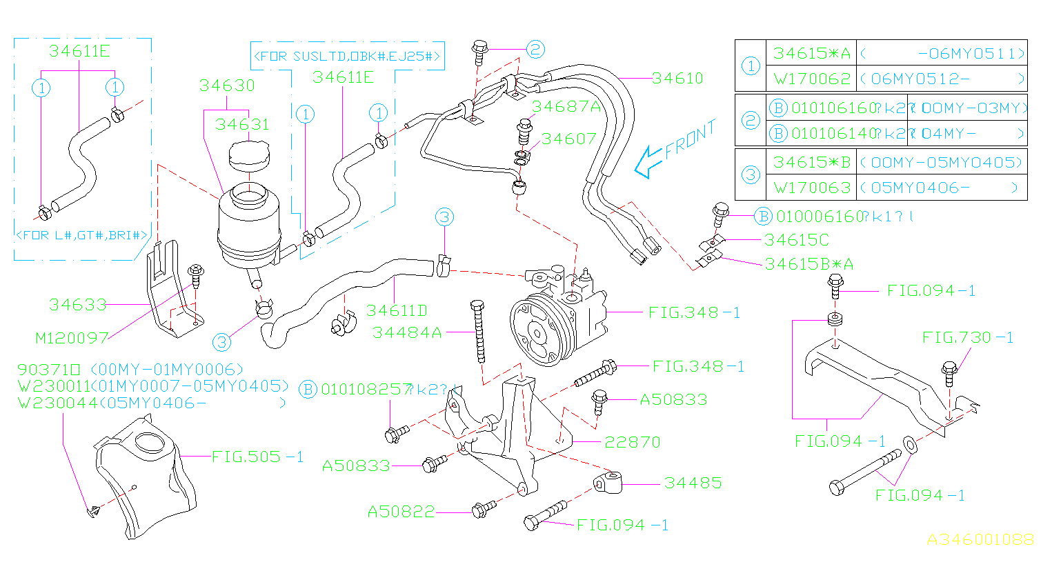

For finding out part numbers, parts.subaru.com is the first place I go:
http://parts.subaru.com/a/Subaru_2003_B ... 46-01.html
All of the part numbers in the diagram are listed below, or you can click on the [+] button next to each part in the diagram to jump to it in the list.

Thanks guys! If I'm not mistaken I think it's actually the return line specifically that got roasted. I ended up finding this same diagram actually and called the local subie dealer to inquire about it.Turns out it comes as an "assembly" and neither of the two lines can be purchased seperately. So I looked online and found a few, mostly on eBay, but only the line coming from the pump itself. Next i searched local junk yards for a similar subie model with a used line. no wrecked subies to find (no surprise in ETX :roll: ) apparently some yards even cut the lines? Anyway, I settled for the dealership and paid the $175 for both lines. It should be getting here in a couple days so we'll see how it goes!
