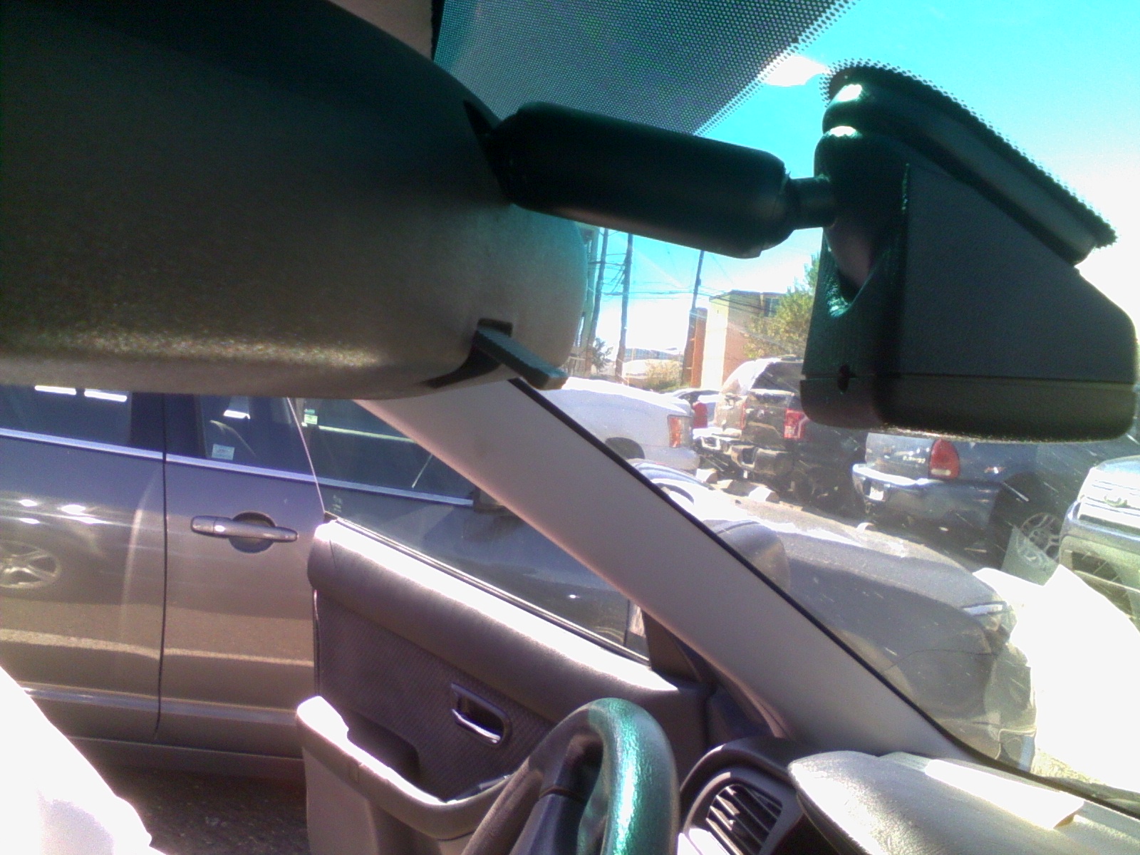

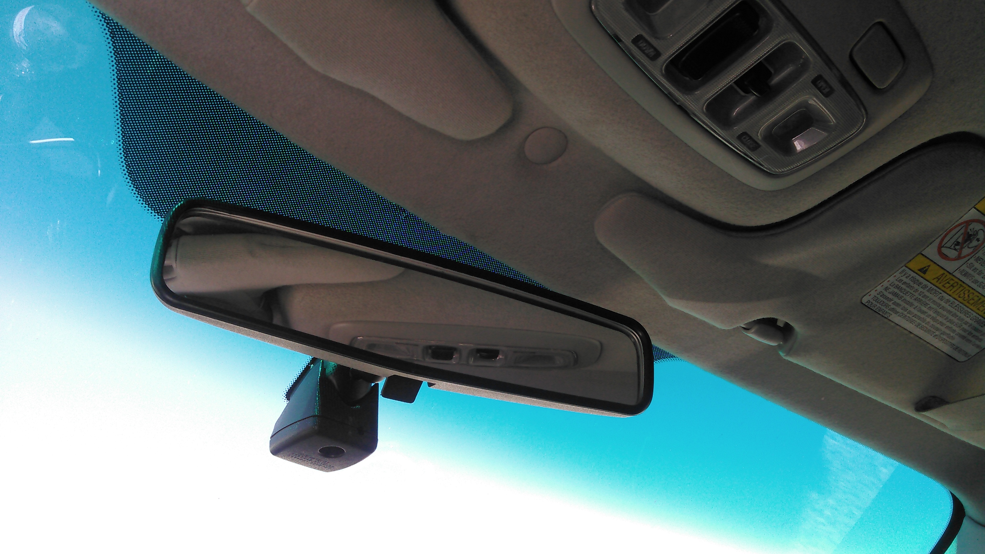

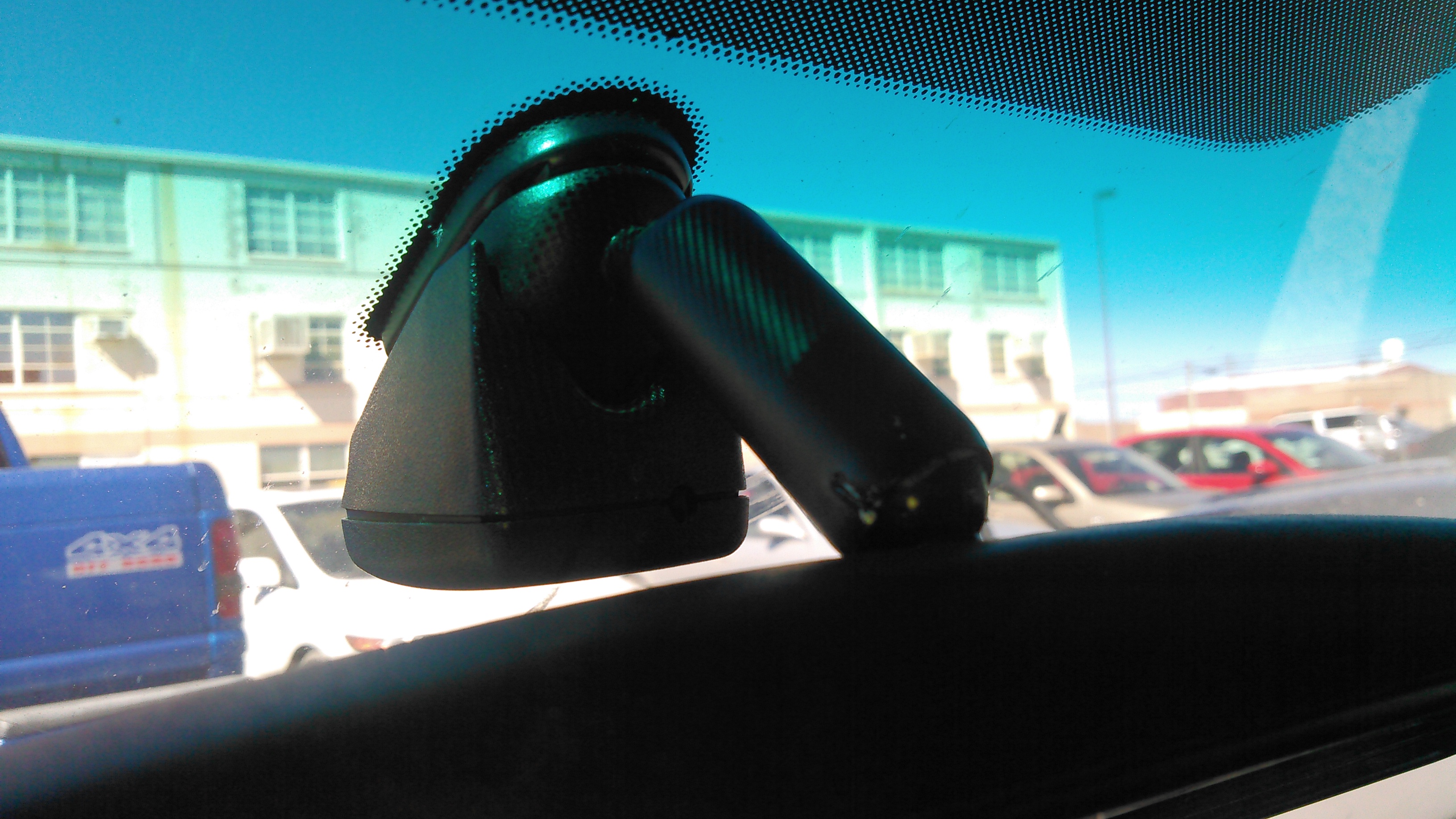

Can someone help identify what this odd block is at the base of my mirror?
I tried looking up parts diagrams, but am only able to find what appear to be "normal" mirrors with nothing on the stalk. I'm not sure what phrase, or number, or voodoo charm I need to find the answer on Google that is more helpful than just a list of all the aftermarket rear view mirrors ever.
I did find another site that shows wires coming out of the box to the mirror, so thought it might be an auto dimming or compass equipped mirror, but the only images I can find are from the front and I can't see if they have this block.
I just got this '03 Baja Sport and am still learning about it, so thank you for any assistance!

It's a sensor unit for the auto-dimming mirror. Someone pulled the power to the unit & replaced your mirror with a standard one. Most likely the PO or whomever you purchased it from did that for whatever reason.

I'll poke around and see if I might have wires for the auto-dimming mirror hidden somewhere (suspect not, but never hurts to look). Be neat to have a fancy mirror vs the plain old one I have now. :)
Re: Unknown part on rear view mirror
If someone actually pulled the wires look up where the windshield meets the interior cloth on the roof, if there's a bump or a hole then yours used to have one. If there's no evidence then either the wires are hidden & tucked inside the lighting unit on the interior roof, were completely pulled, or your vehicle never had an auto-dimming mirror & someone replaced the mirror arm with one that is for the auto-dimming mirror, unless the box is removable then they pulled it from another subie & neglected to remove the sensor.
