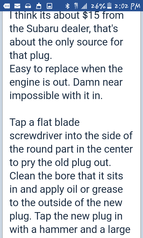

Re: RE: How to remove camshaft rear plugs? On Baja03
Post by danaritter70 »
danaritter70 wrote:Help
Sent from my SM-G360T1 using Tapatalk

Re: Need pics of inside bed of Baja (2003) with plastic liner removed
Thank you. Very much
