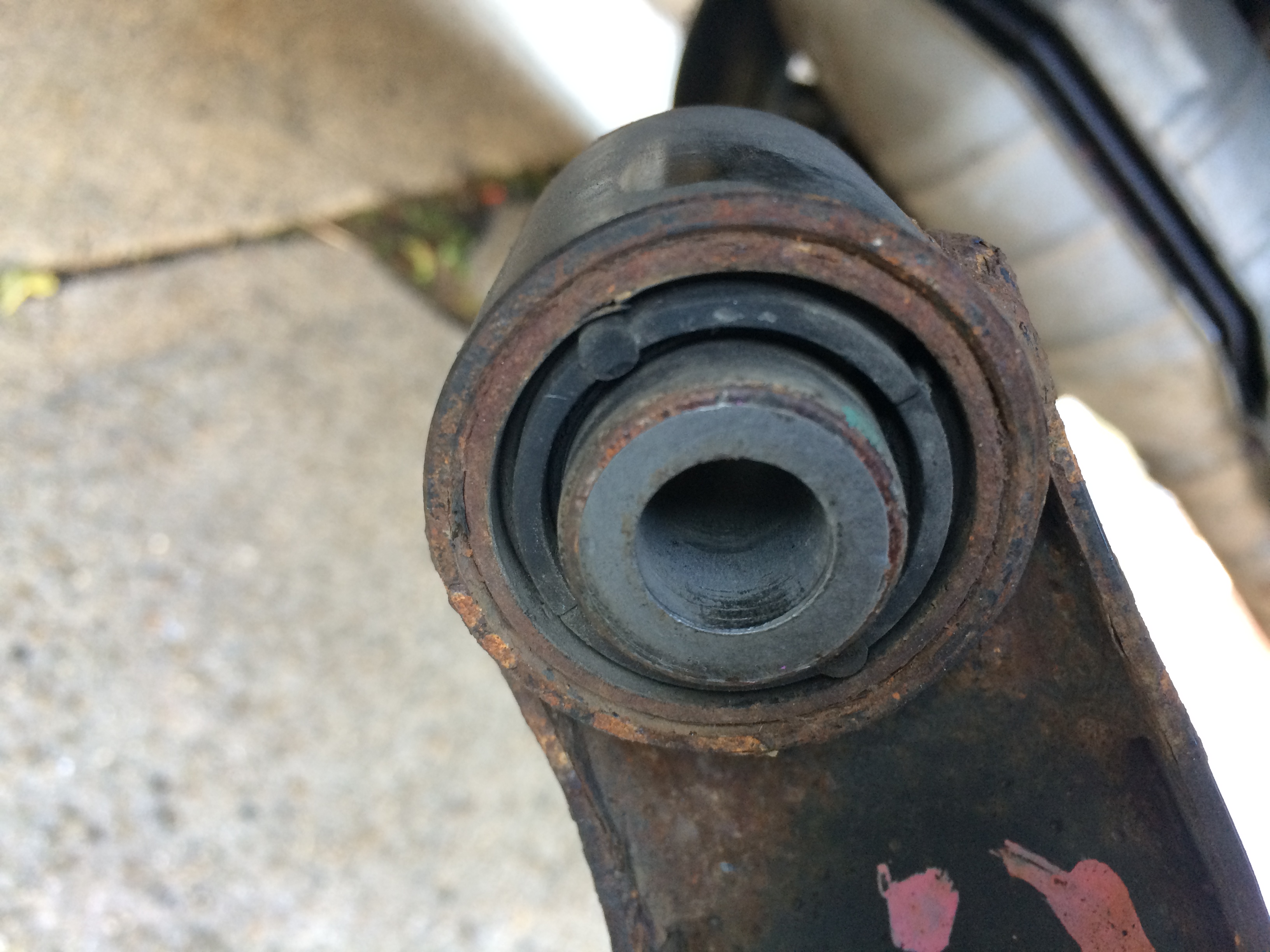

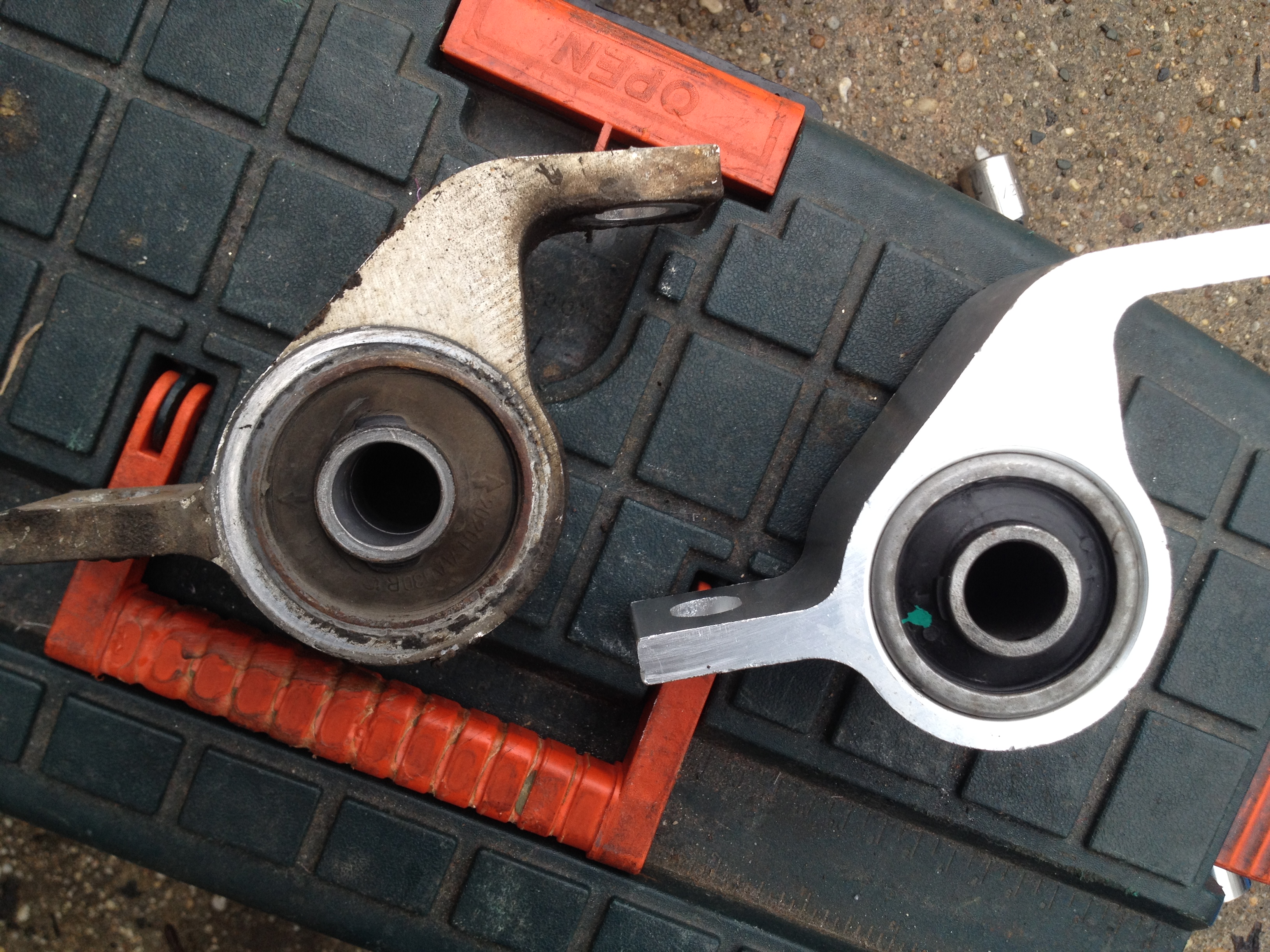

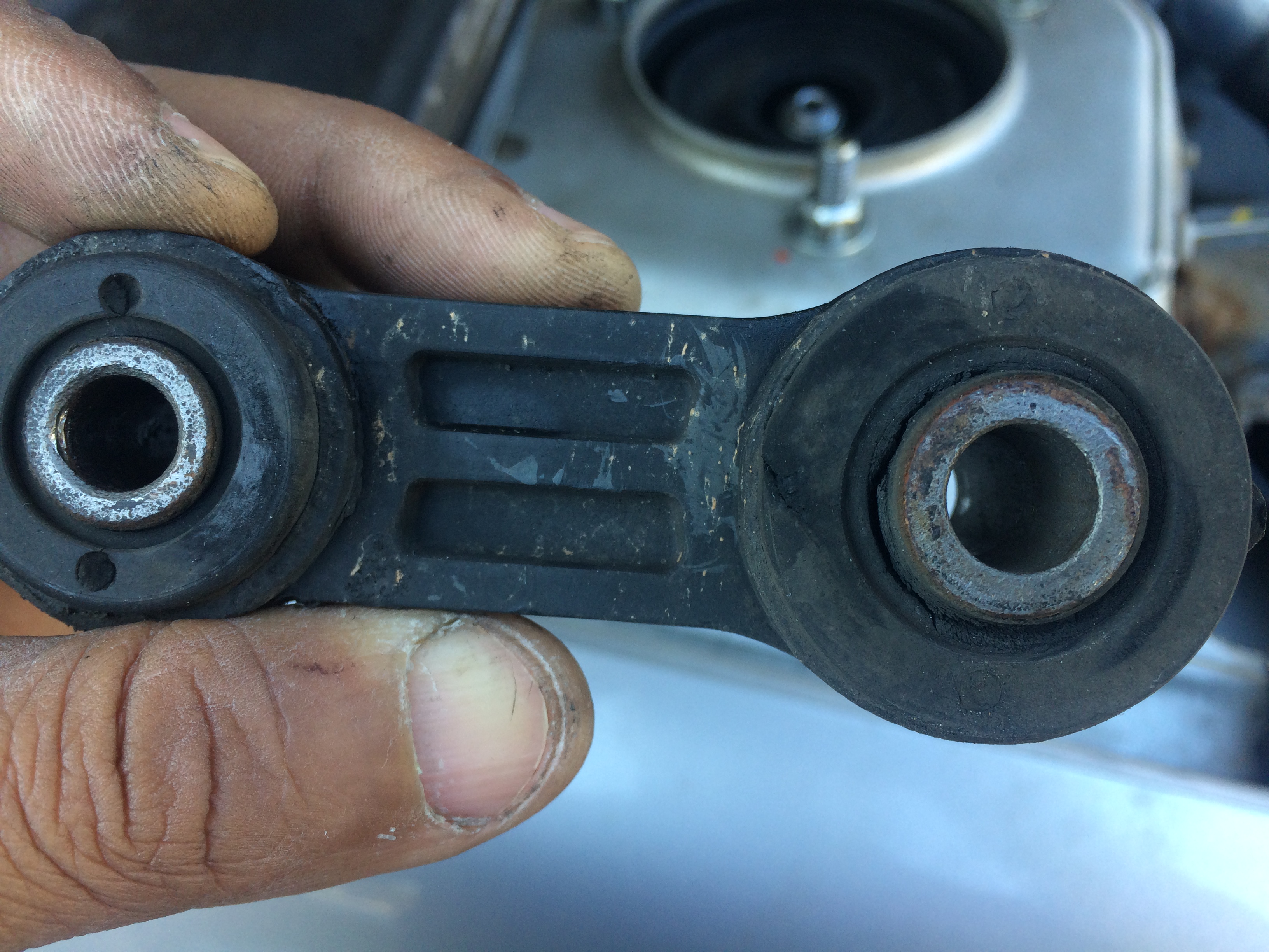

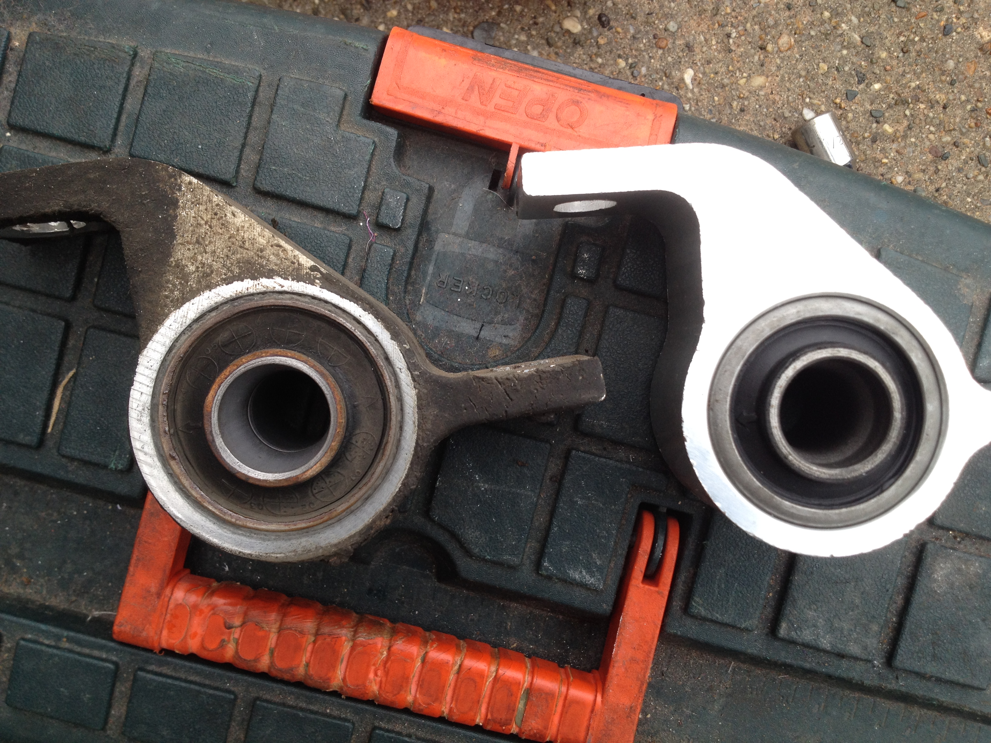

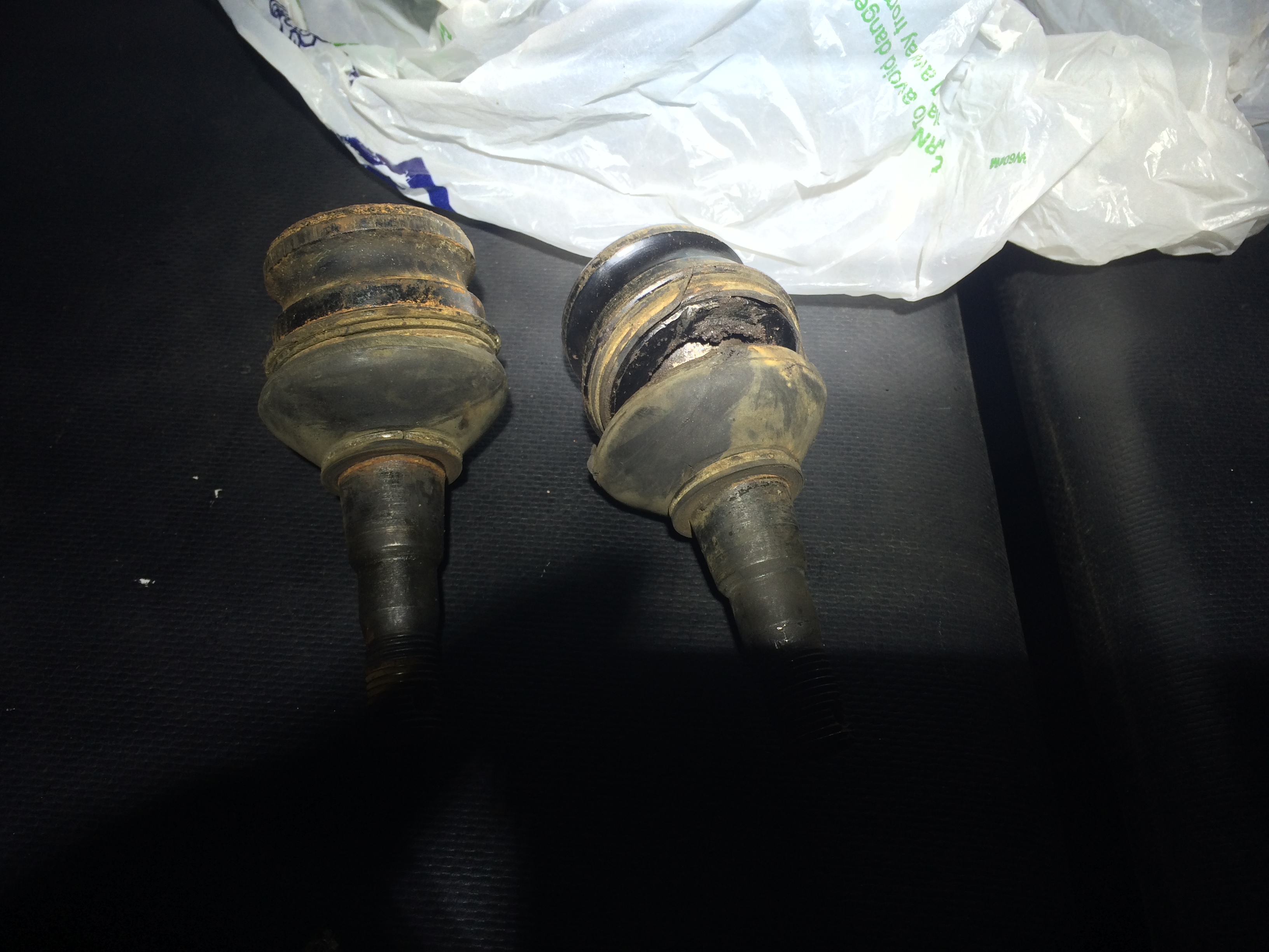

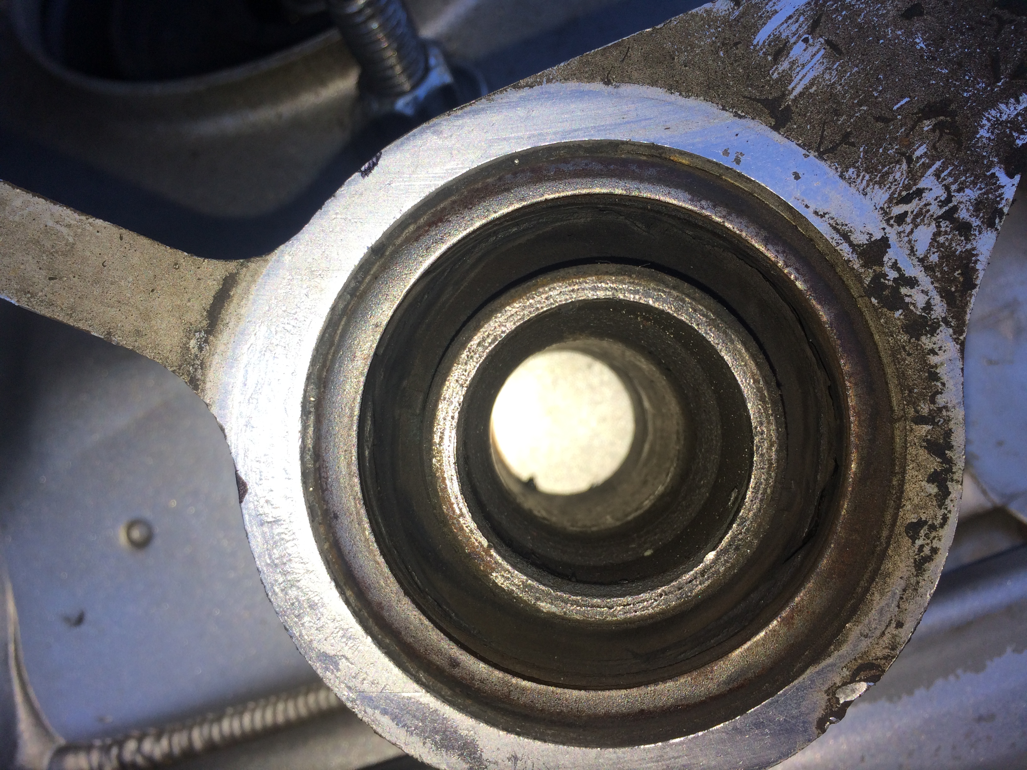

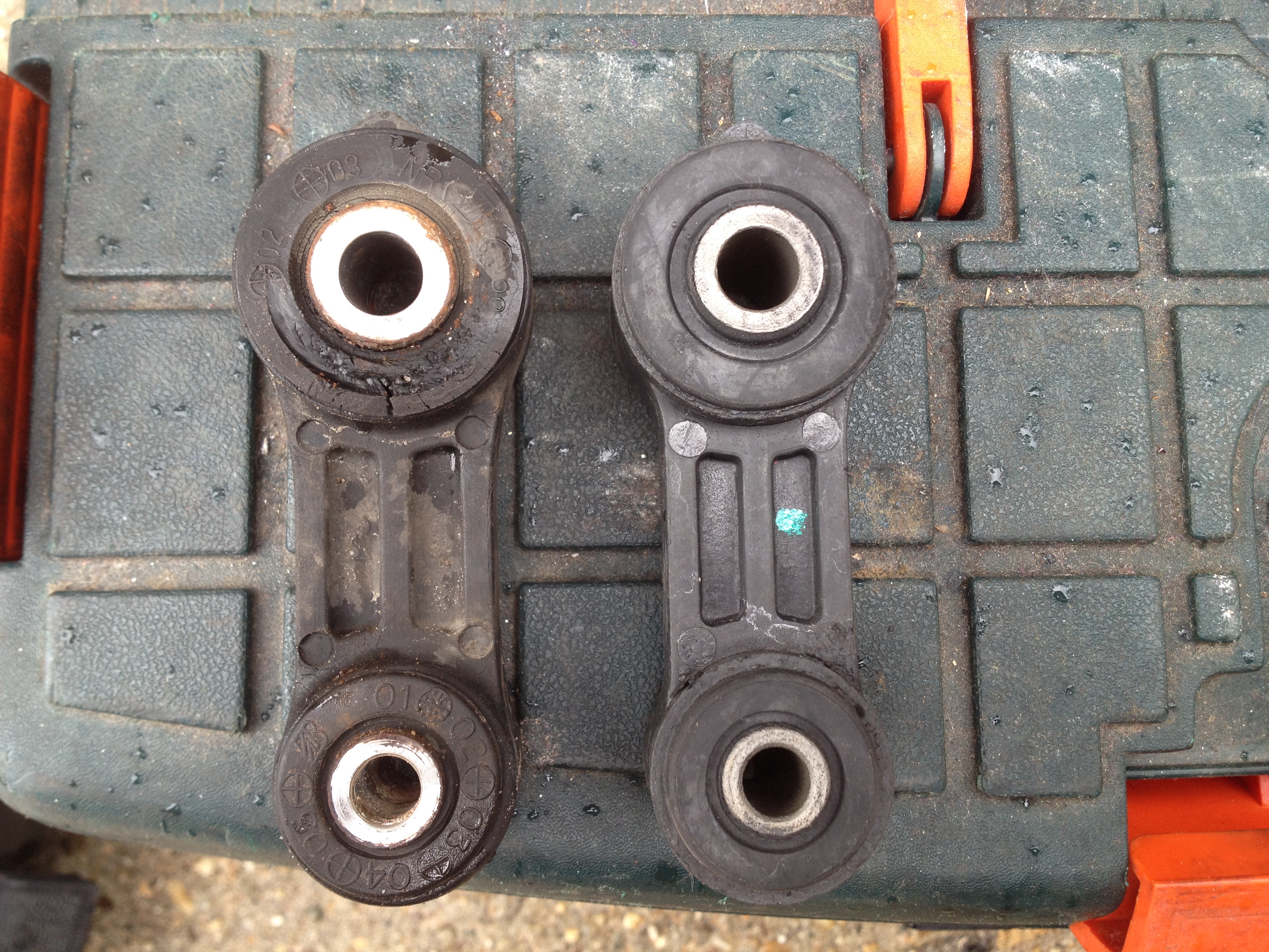

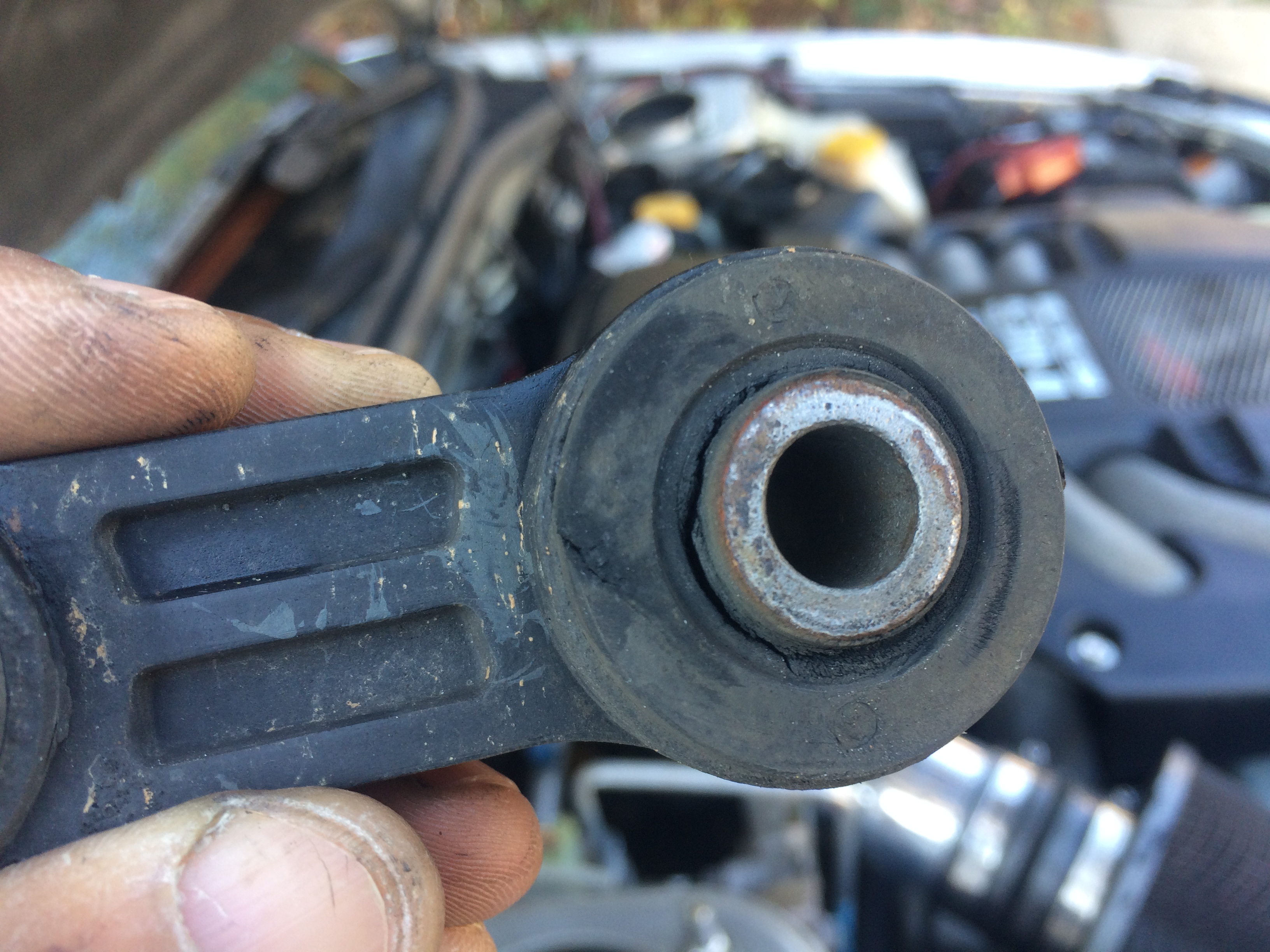

some pics of the failed parts;
Some of the pics are of factory bushes with 12years use on them and the failed febest parts.
First pics Febest swaybar end link after about 15K, second pic factory front front bushing after 13years and 260k miles, still in great condition considering the stress and amount of use, second pic Febest ball joint after about 8K miles;

Some more pics of Febest failed parts,, take note that the ball joints boots not only failed but the joint itself was shaking very bad as if about to come part, replaced withg factory ball joint that has about 30k on it and still feels like new.

200k Factory parts next to new febest parts
