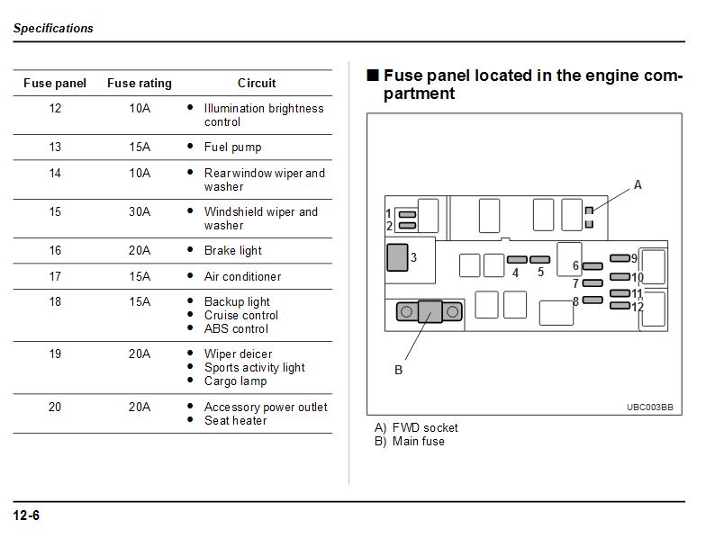

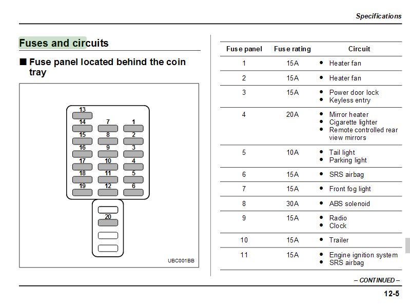

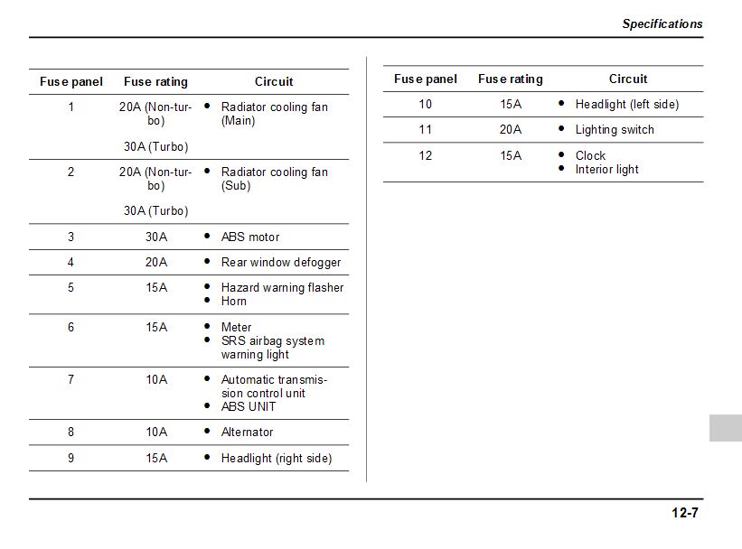

As for the electrical problems, first thing to check would be the fuses & see if any of those are blown. If not, then it's a problem in the wiring, & that's serious $$$. The headlight fuse box is located on the driver's side of the engine bay right behind the battery. The interior fuse box is located behind the coin tray under the dashboard (you have to finagle with it to remove it).
There should be a fuse diagram in the owner's manual, but here's the diagram from an 06 if you don't have one:
