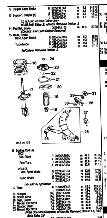

Re: Front Strut Options
The plot thickens. The parts index lists the same struts for all model years, but different springs per model year; two for 03, but the 04-05 are the same? Also different ones for the turbos? But the rear springs are the same for all years? [smilie=huh-ani.gif]
Front Strut
Rear Strut
I actually called the local Subie dealership & the parts guy said they need VINs to confirm the difference, but he did say the index has the correct part numbers...
EDIT: So on my 06 N/A Auto the suspension part #s are as follows:
RF Strut: 20310AE44A
LF Strut: 20310AE45A
F Springs: 20330AE60A & 20330AE62A
RR Strut: 20365AE22A
LR Strut: 20365AE22A
R Springs: 20380AE50A

So if this is correct, the 04-06s use the same struts & springs while the 03s are the outlier. Yet the 05 & 06s are higher than the 04s, so how the hell did Subaru achieve a higher ride height for the later models if the struts & springs are the same???
If anyone with 2003-2005 N/As wants to input their VINs & list the part #s they get for the front & rear suspension for confirmation it would be greatly appreciated.
2ND EDIT:
So after reviewing all the spec sheets for all 4 model years, I found that the official Subaru manuals list "8.4in" of ground clearance for the 04s, 05s, & 06s. Now everything makes sense & my original information of the 04s being a middle ride height are incorrect.
So I'm just an idiot. :lol:
