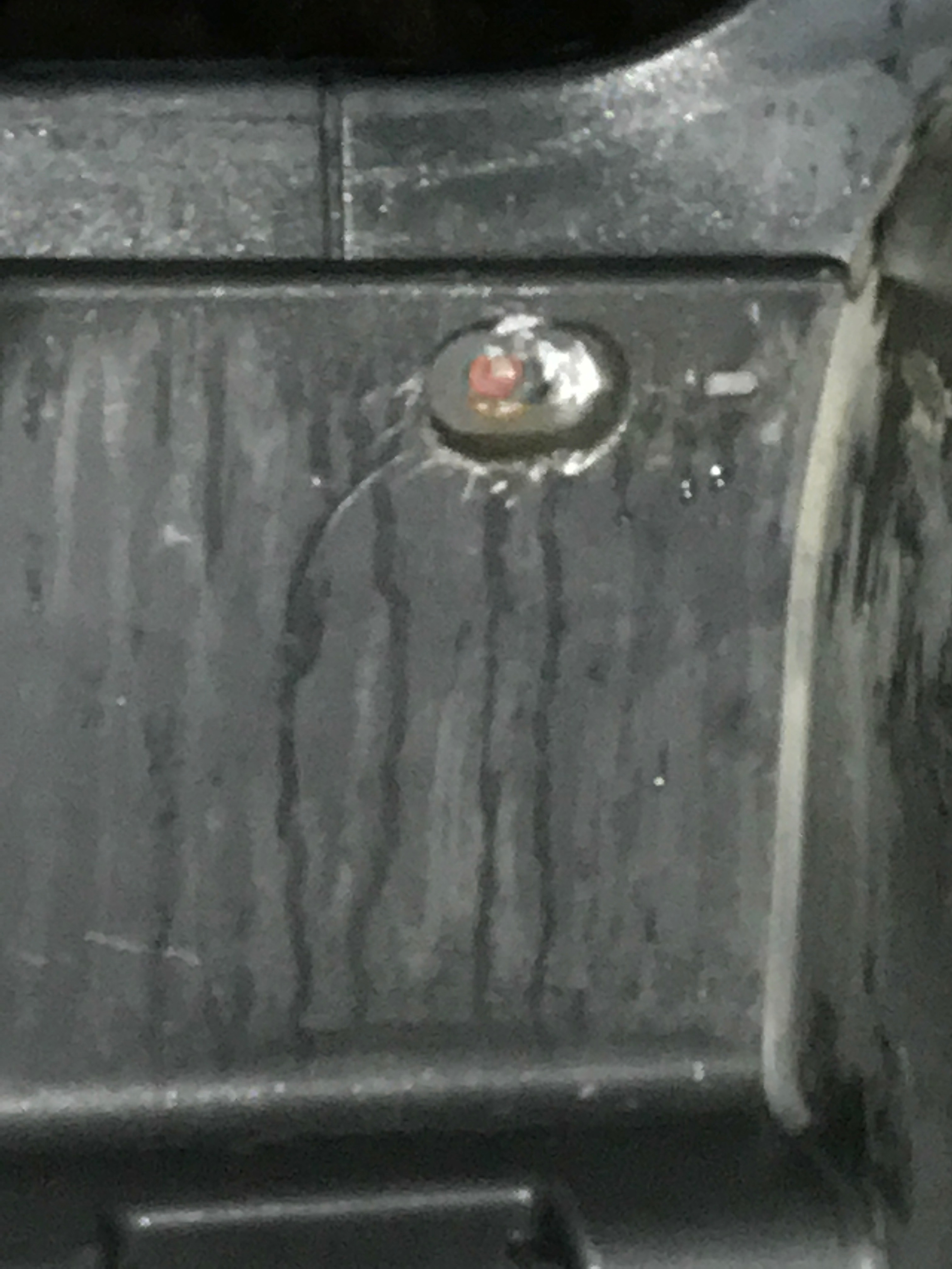

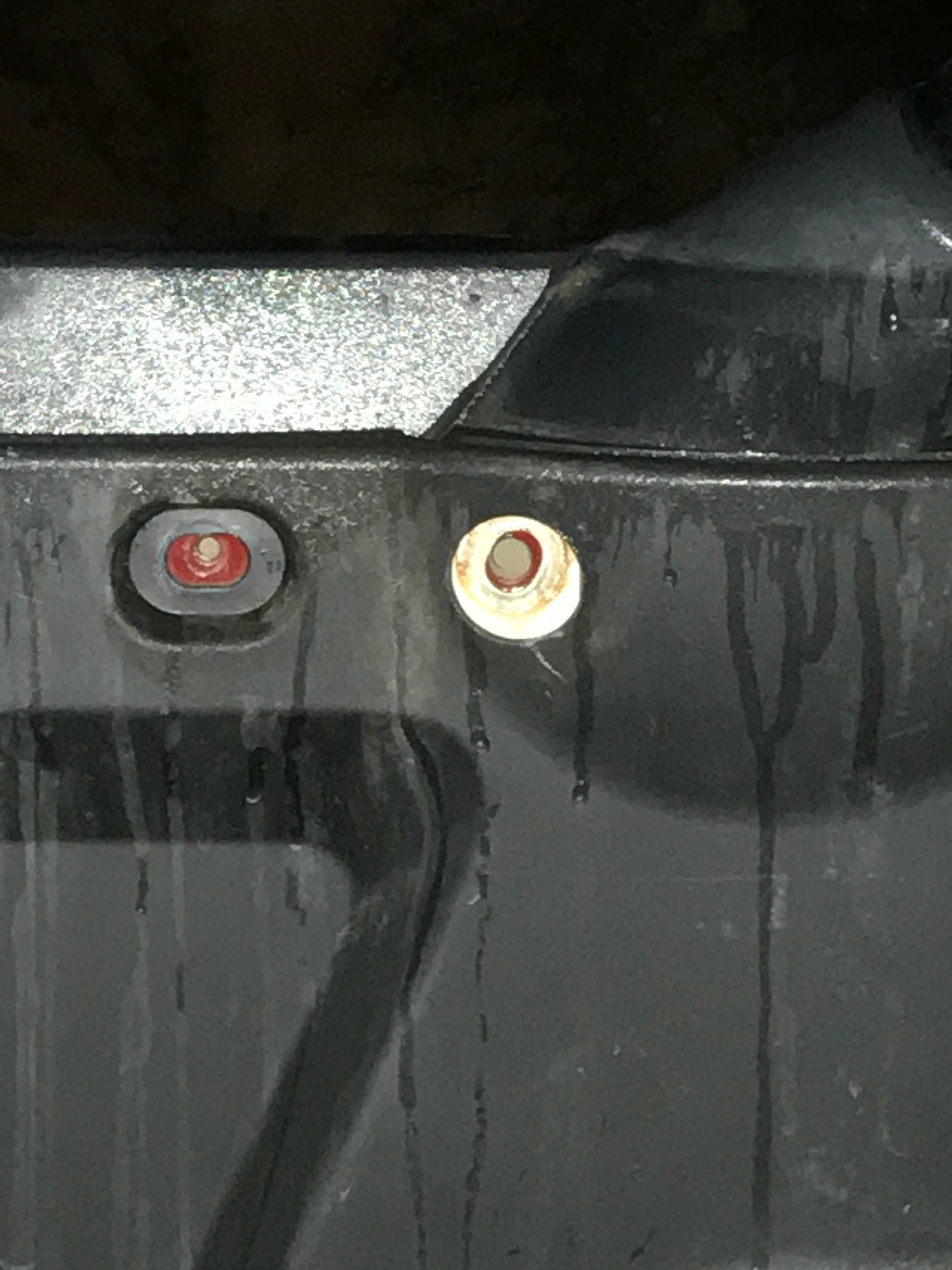

Ok, I found more information for you tech guys. It is a stock subaru fiberglass cover, 91261AE28A, Looks like the missing rods and and locks are still available, (cost Pennies) and I can get it painted (No big deal). I will be very happy with this set up if I can retro fit it.
The question is Subaru only has tonneau cover listed for 2005 - 2006 Turbos (Which I took it off a 2005 Turbo), Looks like everything can fit. (Almost). I will have to drill a 2 holes, one under each roll bar, and 2 small rectangle with a dermal . The parts 2005 baja, I did take a picture of the man drilled hole. Has anyone tried this? If there are no bolt threads behind the man drilled hole once I drill, then that will be the only hiccup that I can see, or as I see it, a temporary set back..

BTW, I currently have my car in the garage for an overhaul. I have all of the inside bed panels off the vehicle right now. If you'd like, give me a better picture with the location of where you need to drill/cut the holes, and I can tell you if there are threads behind it in the sheet metal or not. Might save you some work, eh?

If you follow the rear roll bar from the top and follow it down to the bed, then put it in line we the other bolts..
Hard to explain, but take a picture of your bed under roll bar..

It looks like that particular hole is a threaded hole used as 1 of 3 to attach the lower roll bar bracket to the body. My guess would be that since it is hidden behind by the plastic liner, you cut a hole, get a longer bolt and use that as attachment point for the tonneau too?
