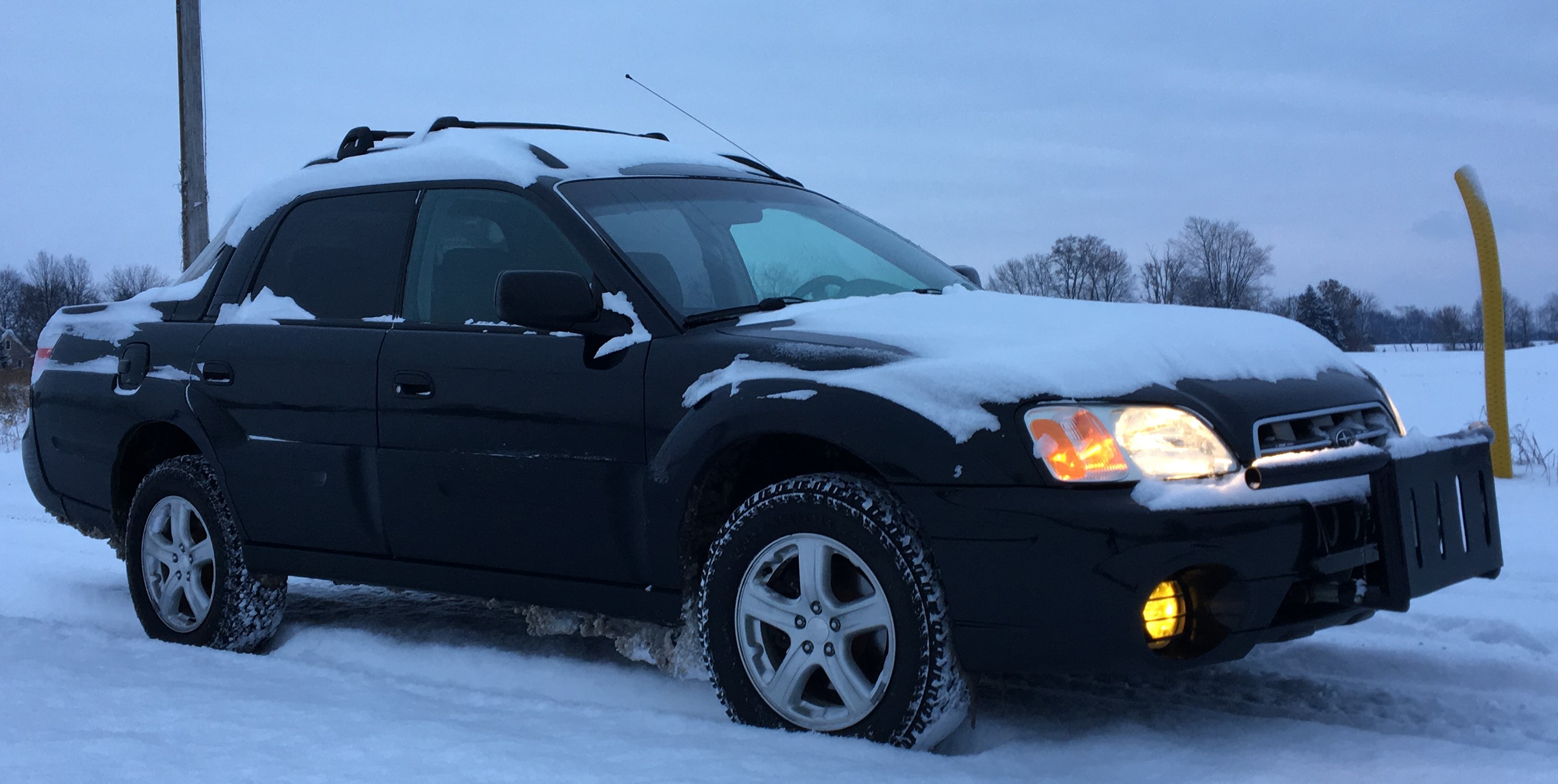

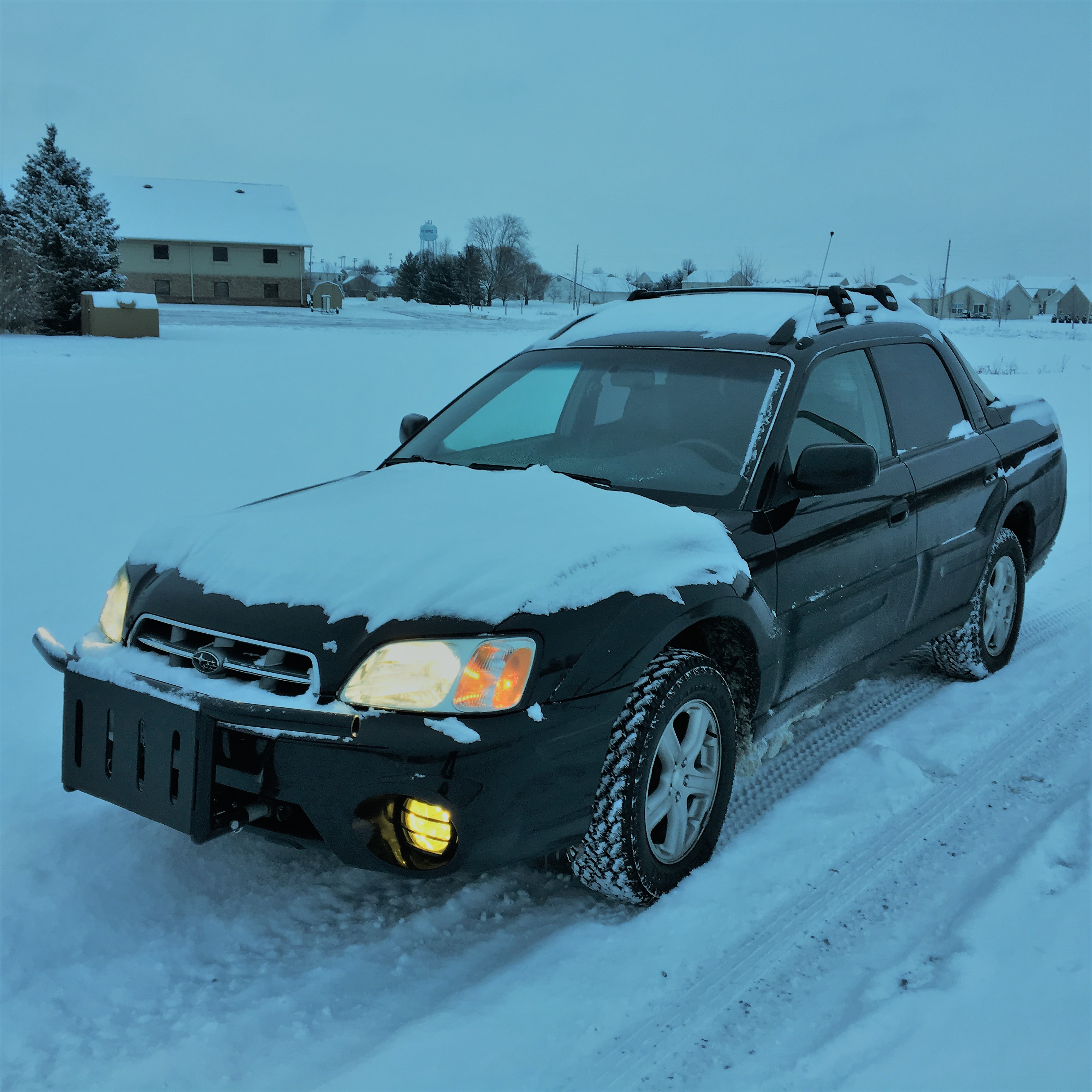

I just did my '06. Did a 1" from Gorilla. I preferred the nylon/urethane material as a spacer rather than aluminum or steel. Didn't want metal on metal contact. Not too difficult other than spreading the axle down on the rear. Hard to believe it is possible to get another inch over the 1 but its being done. I used the scissor jack in between the axle and body from the beginning during disassembly. Makes it much easier. Leave it in place while you work on the strut. I put 215/65-16 General Mud Grabbers. Lots cheaper than the K02 and every bit the grip. Find Generals to last much longer also. Can be studded if that's a need. I think I could have done a 215/70 for maybe 1/2" height w/o trimming. Gonna do a test fit of wife's '18 Crosstrek wheel and tire to see how that works out.
Overall, I love the ride and feel of the truck now. Sits as it should. I would love to have it taller but since I am going to be towing it I need to keep the tow point lower than the hitch on the motorhome. It will still take care of business on the trails

Mounted on stock rims. These tires are actually narrower than the 225/60 street tires that were on it. Kinda wish I went with the 2" now for the look but it really wouldn't provide much better tire clearance and just stressed the axles more. I did replace all for when I did the lift just for peace of mind and they are really simple and not that expensive for better than OEM replacements. The tire clearance issue is the front of the rear wheel well and the rear of the fronts. A small amount of clearancing will get maybe a 1" more tire.

I did replace the rear struts and tops front and rear. Rebuilt the rear with original springs. It is very simple to add the spacers to the top of the struts then simply reinstall the assembly. Trick is putting the factory screw jack in between the body and the rear suspension to keep it spread apart while you disassemble then cranking it wider to spread far enough to install the taller strut assembly. Able to get a good 1 1/4" out of it. Wish I had went with 2" for looks instead of the 1" but you really get no better tire clearance and didn't need to stress the CV's any more than necessary. I replaced the front CV' while apart.
