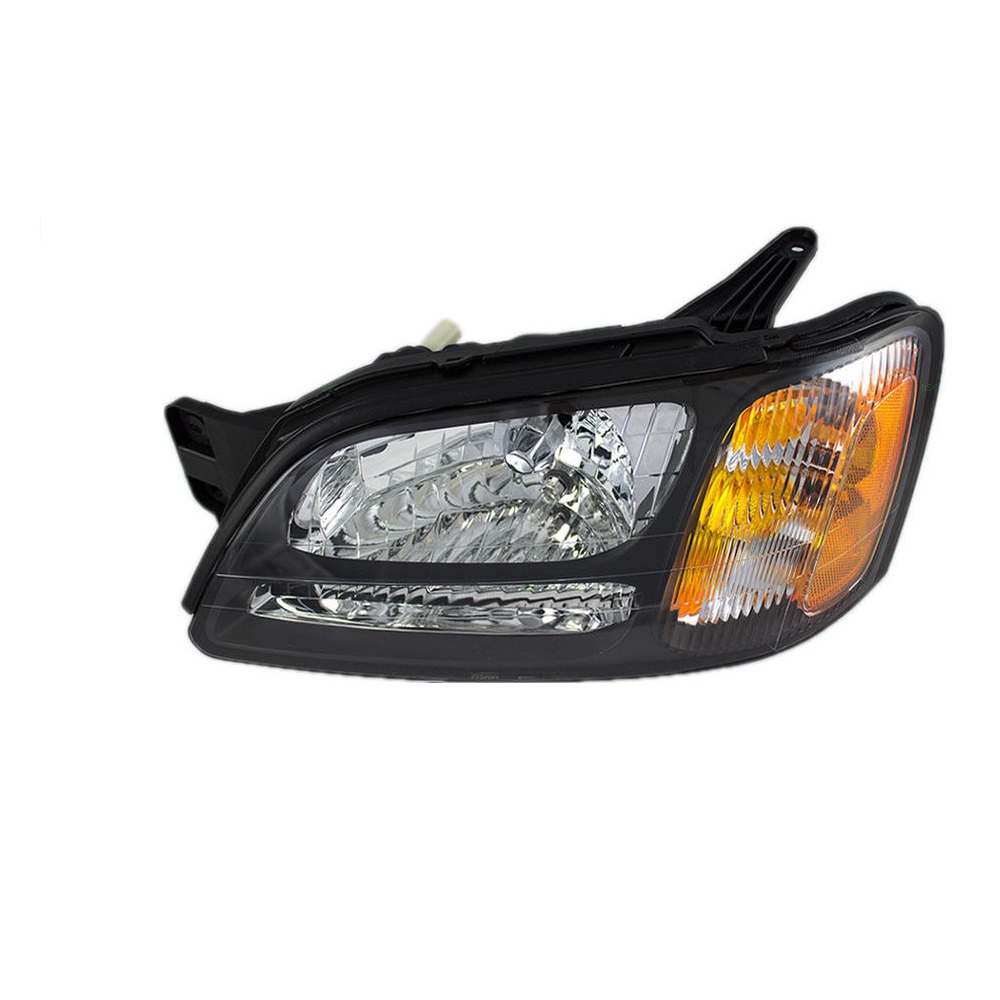

I am installing new headlights made for a Baja Turbo onto my Baja Sport. The plug-in connectors on the headlights and on the wiring harnesses are different between the 2 models so switching between the two types of headlights is NOT a simple swap. I can easily make two jumpers using parts from a junkyard.
The headlights for the Turbo have two separate lamps (bulbs) and two separate reflector sections (a large upper section and a smaller lower section). I am assuming one is for the high beam and one is for the low beam but that may not be true! The headlights for the Sport have one lamp (bulb) and one reflector section. For anyone who owns a Baja Turbo I would like to know which section of the headlight is the low beam section and which is the high beam section. There is also the possibility that both sections are lit in the high beam, and the low beam as well with each lamp always on but switching between bright and dim. In other words, in one mode, when one lamp is dim the other is bright and in the other mode, the opposite is true!
Can someone check their vehicle and tell me specifically exactly what the lighting configuration is for both the High beam and the Low beam on the Turbo head lights? You probably will have to look closely to be sure which bulb is lit in each mode.
I've been looking around in parking lots and such and noticed the same headlights on some earlier 2000s Subaru Legacy models but I haven't run into any owners to ask them to actually turn on their headlights for me so I can see how they're set up!
I went to a Subaru dealer and believe it or not they couldn't answer my question even though I got the Service manager to look at specific wiring diagrams in their database. None of the mechanics knew either.

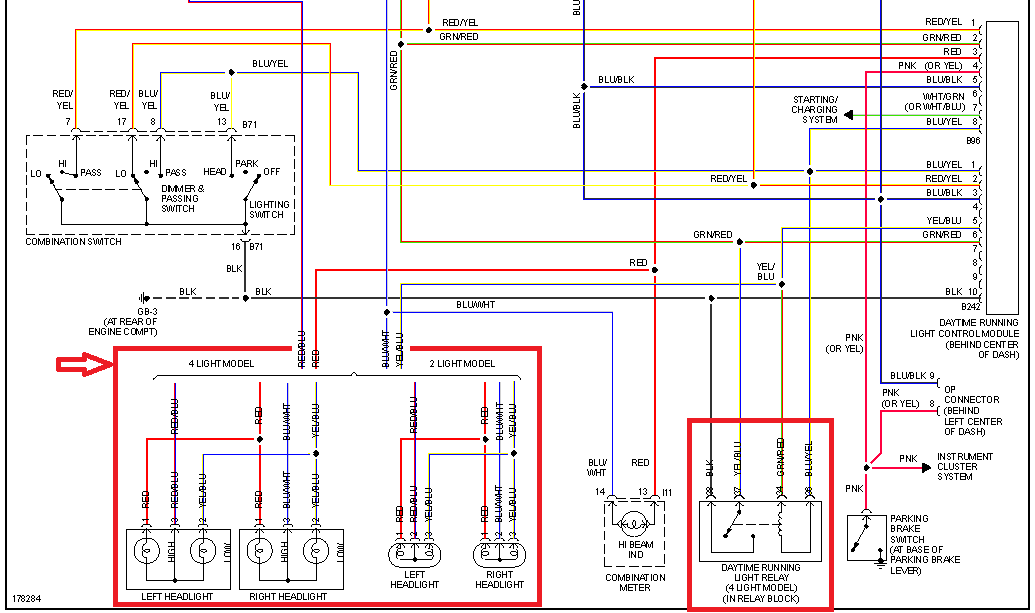

The bottom light is the high beam. I don't own a turbo, but I've done quite a bit of research on this. Like you said, this is going to be a pain. I'm not even 100% sure the different lights are compatible, but I'll look forward to seeing how you do this mod.
Here's the wiring diagram for both headlight housings (the turbo is the "4-light model")

When the headlights are off, the daytime running lights are in use, and those just the main low-beam headlights at a lower voltage (unless you disable the DRLs).
The high beams only turn on when the low beams are on, and that includes when flashing. The low beams don't turn off when the high beams are high beams are in use.
The Gen3 Outback/Legacy uses the same headlights, and are physically interchangeable. They shouldn't be too hard electrically, either, with a bit of splicing. As far as I know, the logic is identical between the Turbo and Sport; one uses separate bulbs, while the other just uses a dual-filament bulb.

This wiring diagram might be a bit easier to see the differences between the two... And my statement about the logic being identical might not be accurate after all, seeing as there's an additional relay in the four-beam headlight system that (according to this diagram) isn't present in the two-beam version.
- wiring.png (49.65 KiB) Viewed 15896 times
Re: Swithching headlights from a Baja Turbo to a Baja Sport!
A subaru mechanic told me that the relay makes the headlights run at a lower voltage for the DRL. So you could probably just do without it.

Any idea how the two-beam headlights have the DRLs implemented?w.rohr wrote: Mon Sep 18, 2017 9:10 pm A subaru mechanic told me that the relay makes the headlights run at a lower voltage for the DRL. So you could probably just do without it.

The low beams are slightly dimmed.anarchy1024 wrote: Tue Sep 19, 2017 8:36 am Any idea how the two-beam headlights have the DRLs implemented?

As in, if the relay that enables the dimming of the low beams is only present in the four-beam version, what is the two-beam version doing?

On my 06 Sport the DRLs are just dimmed low beams. The more I look at the wiring diagrams the more my head hurts, I honestly can't figure out the reason for the relay. My best guess is that it's for the DRL wiring harness since the 2-beam lights lack that.anarchy1024 wrote: Tue Sep 19, 2017 5:27 pm As in, if the relay that enables the dimming of the low beams is only present in the four-beam version, what is the two-beam version doing?
