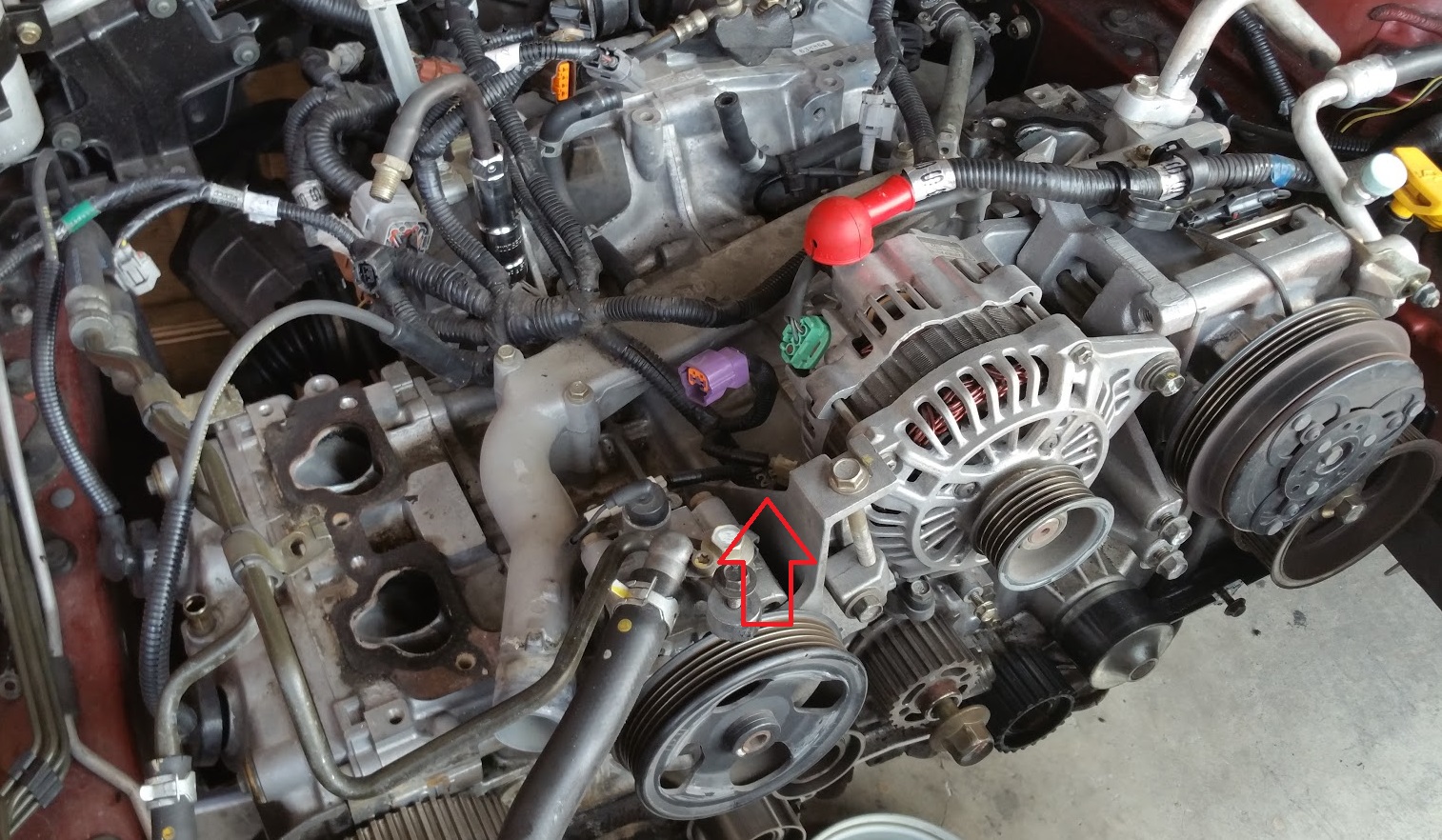

I think "code" in this context is ECU firmware (computer program), not an OBD code. Sounds like the previous owner thought (or claims to have thought) that it's trivial to just update the ECU's programming to work with the new engine. I've seen ECU hacking/reflash programs and kits available for the Turbo models, but it requires someone who really knows what they're doing to do it properly (i.e. there's no check for updates button).w.rohr wrote: Tue Dec 05, 2017 7:14 pm ...But even if they did what is this code it needs to run "better"?
Did you verify that it actually is an EJ20? There should be stamp on the top of the block (although I don't know how easy it is to see it with everything installed).
- 20160727_173404.jpg (489.78 KiB) Viewed 9282 times
- ej25_stamp.jpg (81.32 KiB) Viewed 9283 times
