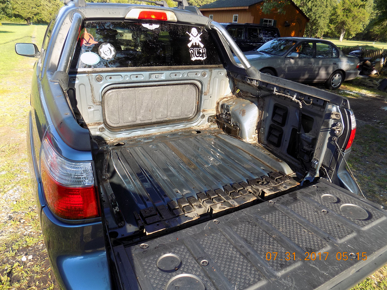

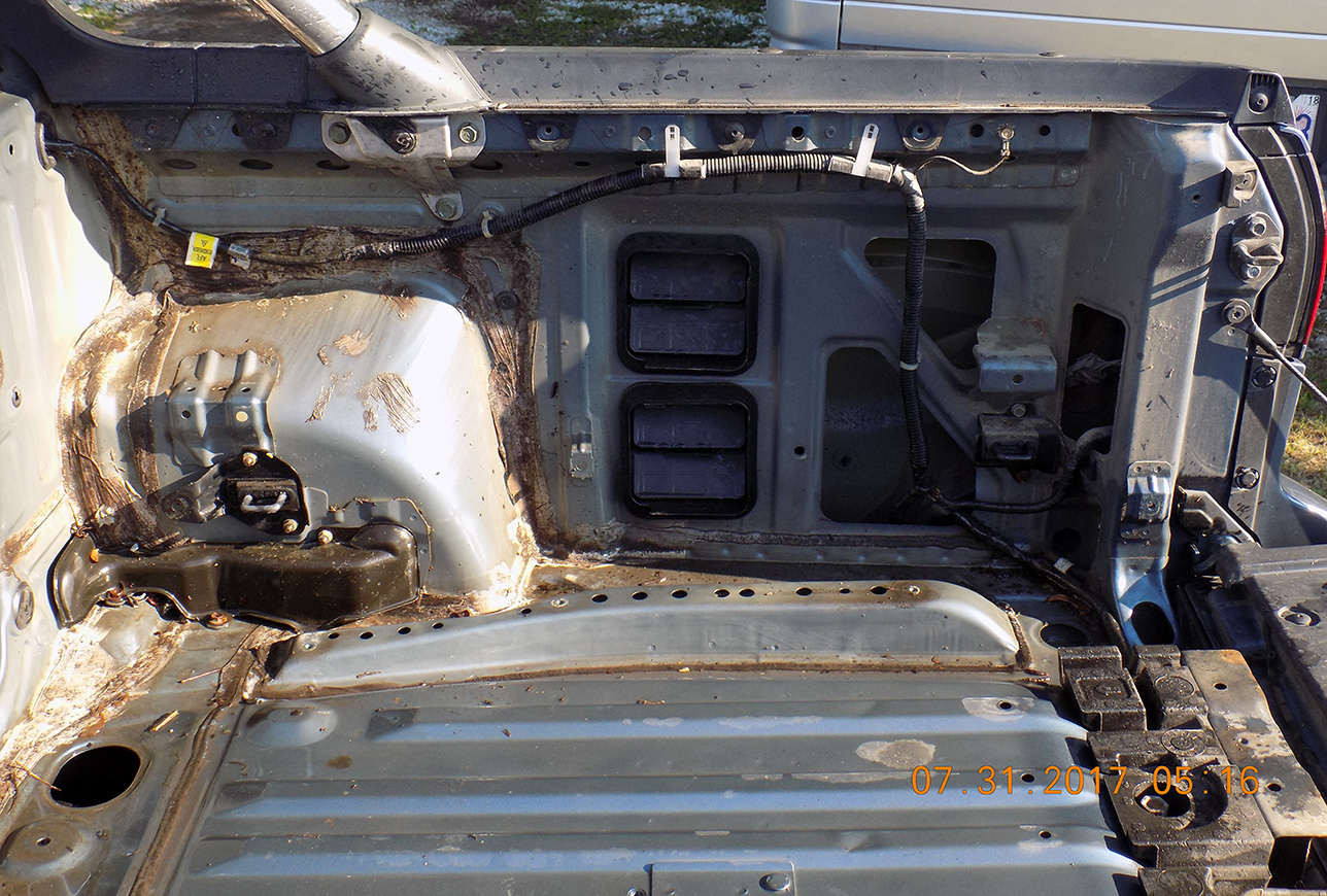

ZUBAJA wrote: Wed Oct 10, 2018 3:38 pm
That's the thing I'm concerned about- you actually can't paint the bare bed without damaging it and other things.
These are pics of my bed when I took the liner off to clean it. You CAN NOT paint over the metal. If you do, you will have to rewire the tail lights, seal the gaps in the metal panels, and cut open new holes for the pressure flaps somewhere on the body (I don't know what they're called, but they allow air to escape the door wells when you close the doors).

Re: Truck bed lined Baja
Post by walfredo »
Yeah this is what I was getting at. Theres no way to access underneath the plastic liner if you bedline over it - will cause problems in the future.
And as you can see by guacamole's photos, to bedline after removing the plastic liner wont work either - too many holes and recesses.
When I worked at the GM dealership that did spray-on bedliners, the technician actually had to sand the paint a little bit to get good adhesion, which means its pretty much permanent at that point.
I would be wary of doing it.
