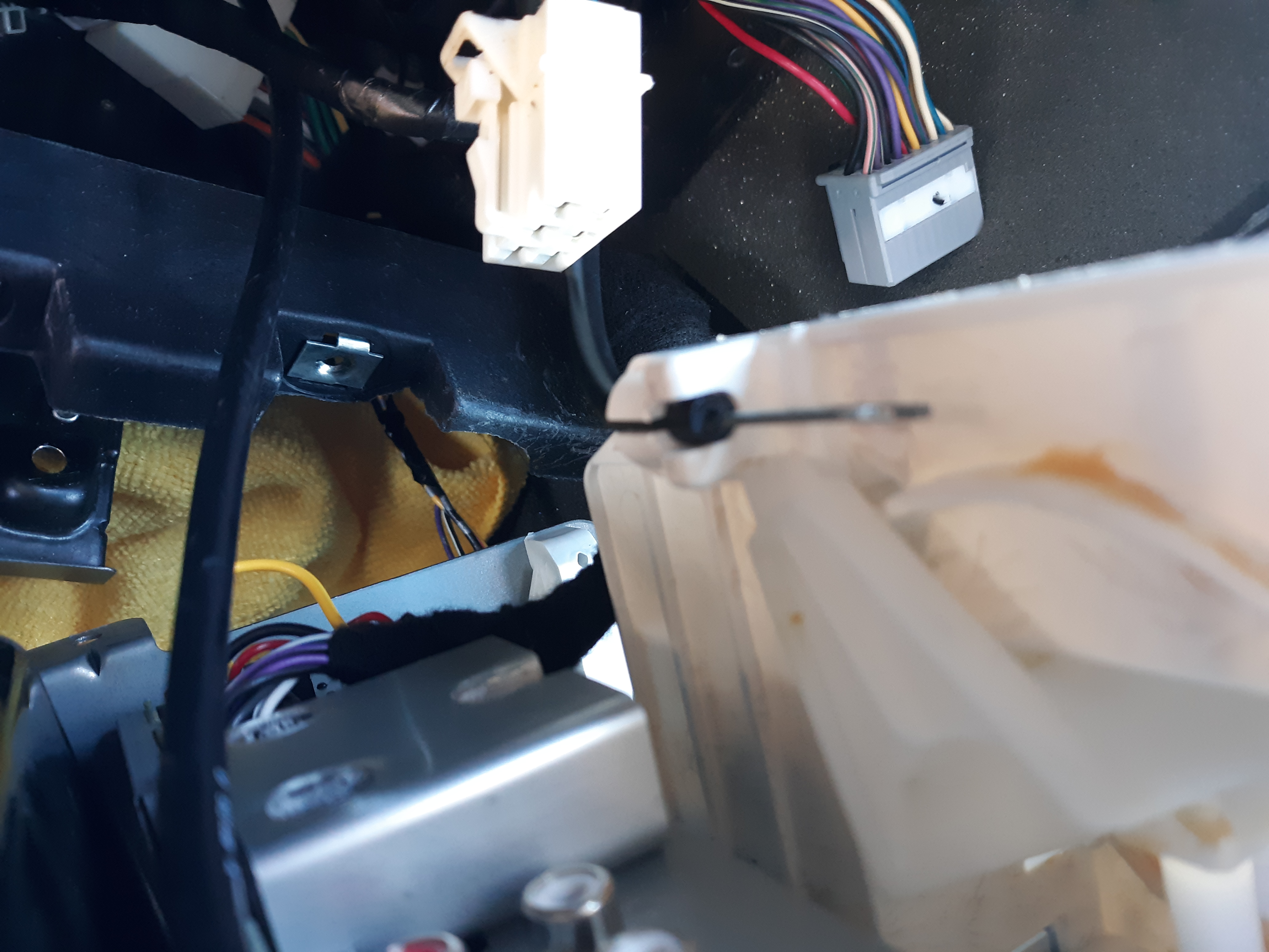

Welll, walfredo, you were entirely correct. The white linkage piece is broken off. But theres too little there to drill and reuse. How can i find the part number I need. Just describe it to the subie dealer? Thanks a bunch for your help!

Ok, that part from subaru is $137. It involves way more than the piece i need..Gotta fabricate something or just pay up...in pic, should i attempt a 1/16 hole on that stub? If so will i have full control of heat? I did not find the missing piece so dont know just how long control arm was. Can jb weld a hobby servo arm to stub?

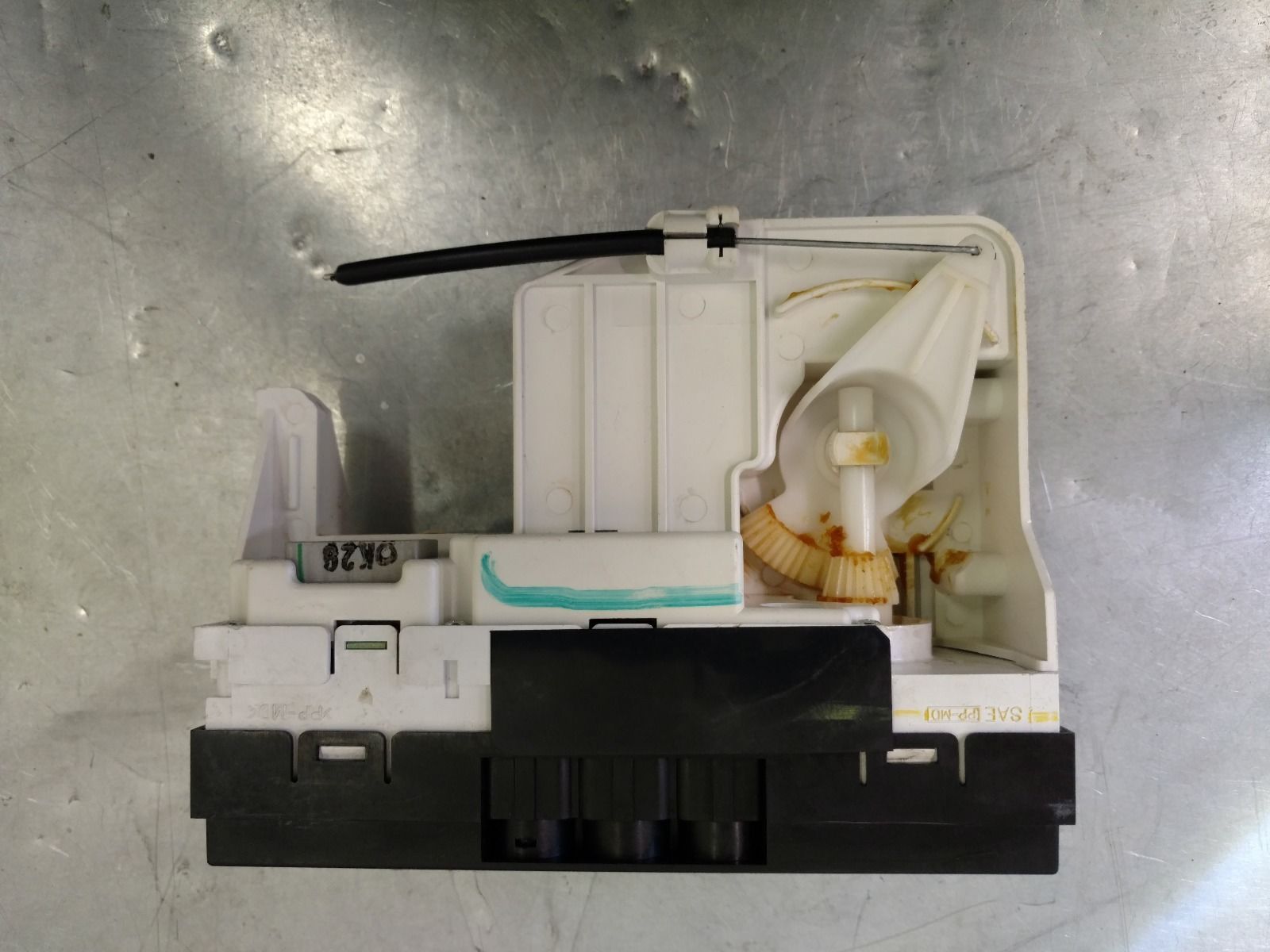

Re: No heat
Holy cow, would never have thought to check this.
If you don't feel like disassembling and fabbing, there's a few temp units on ebay for around $50.
Here's what it should look like though.

Thats a much better pic, will check ebay and a local junkyard. I am in florida so not urgent, except wife would like me to put it back together. What would u call the whole thing, HVAC Controller?

I am missing only the last quarter inch of that control arm.
